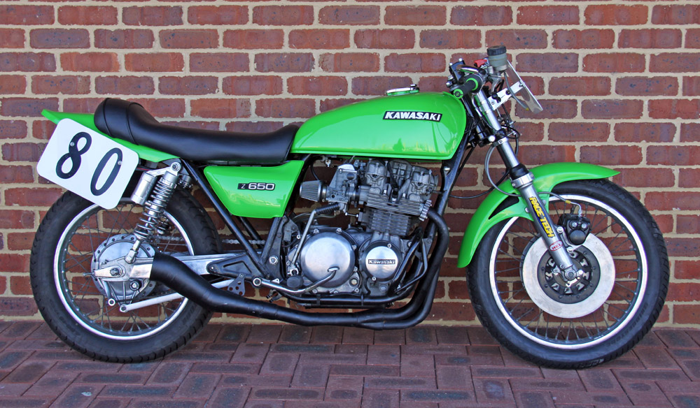

I've got a 79' D-2 that I am converting to a race/track bike. The seat that is on the bike is not factory it is a cafe style single seat attached to a cowling that the previous owner mounted to the seat pan to be able to mount to the frame. I am in need of a seat that is factory or similar that is full length of the seat pan, preferable one that is straight like the one below. If anyone knows the seat that is below that would be fantastic.
