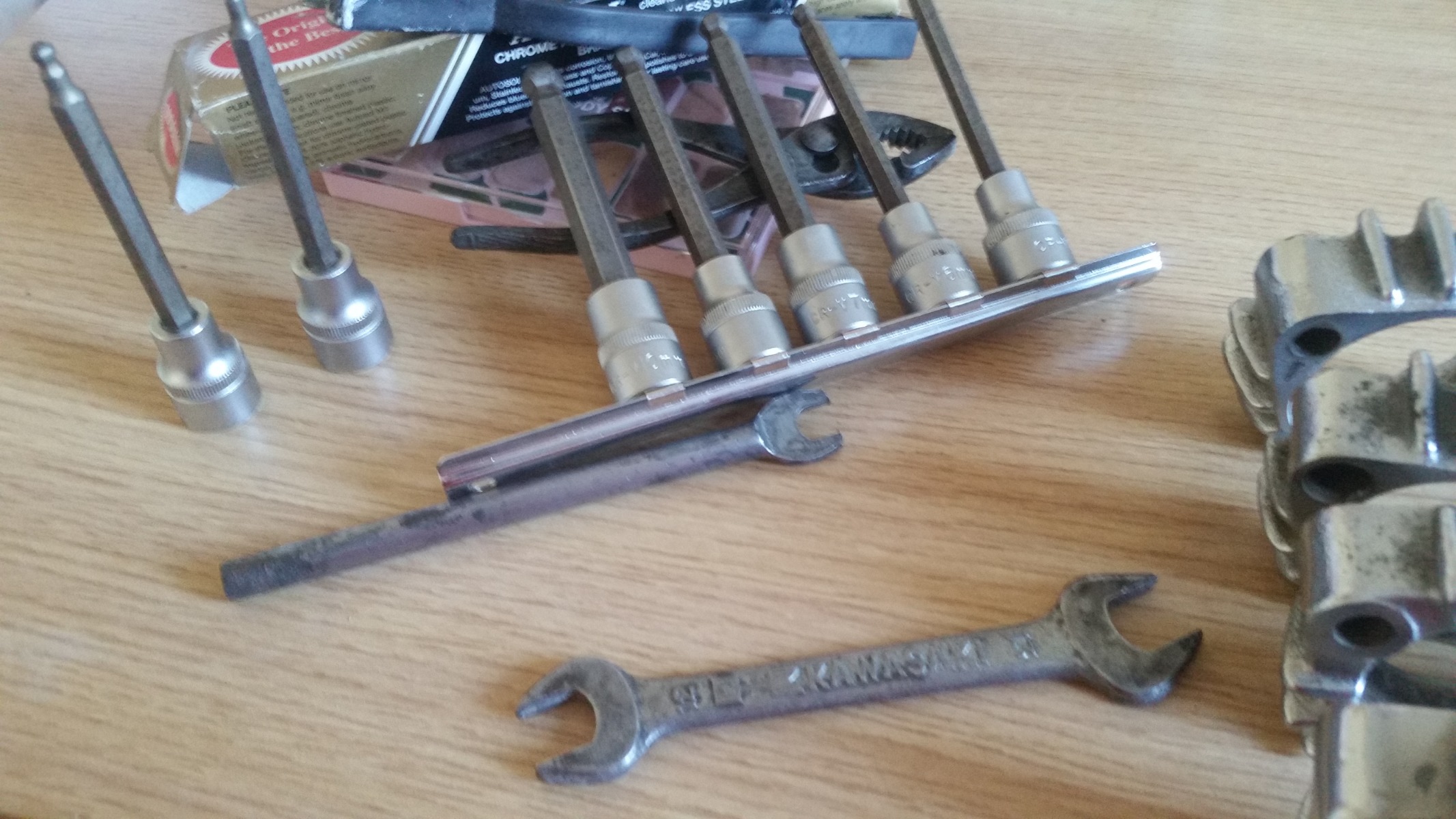

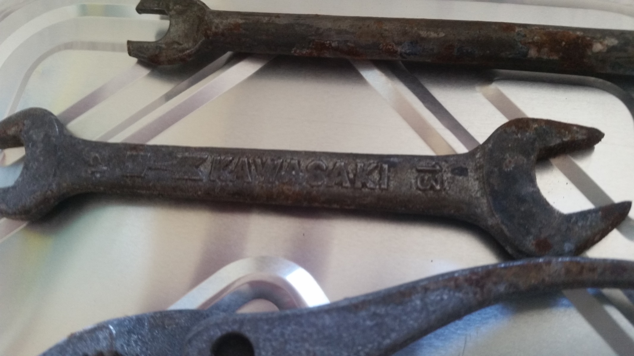

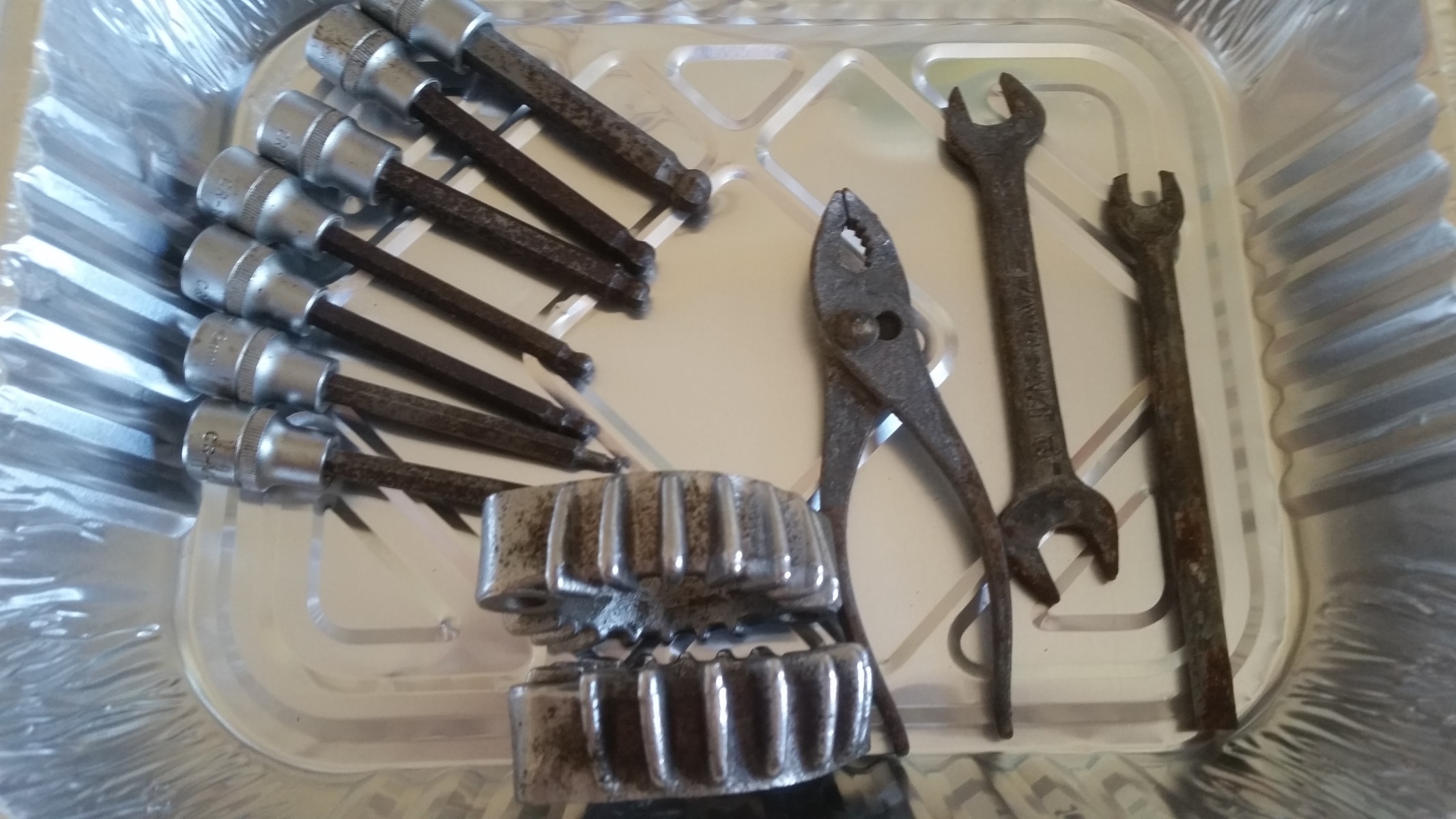

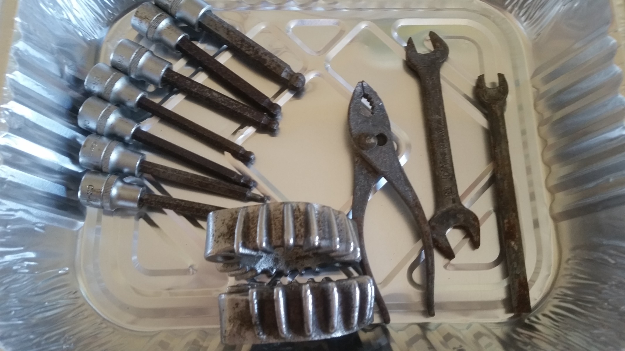

Hey everyone, I'm not sure if this is the right kind of section. ..anyway I had an hour free today and I've been thinking about how most toilet bleaches are up to 47% hydrochloric acid and I wondered what it might do to a few rusty pieces so I set up a foil disposable bake tray, gloves ,glasses and a cheap tooth brush and started scrubbing the bits with bleach! Here are the before pics.....

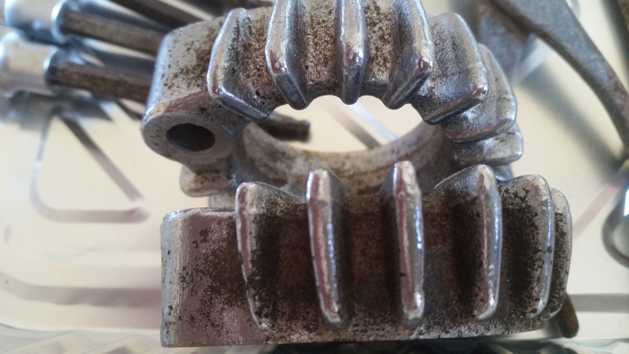

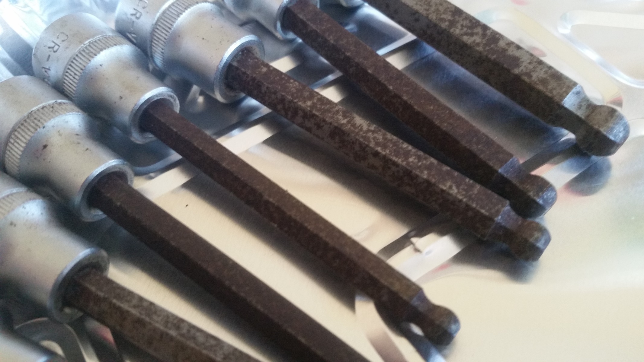

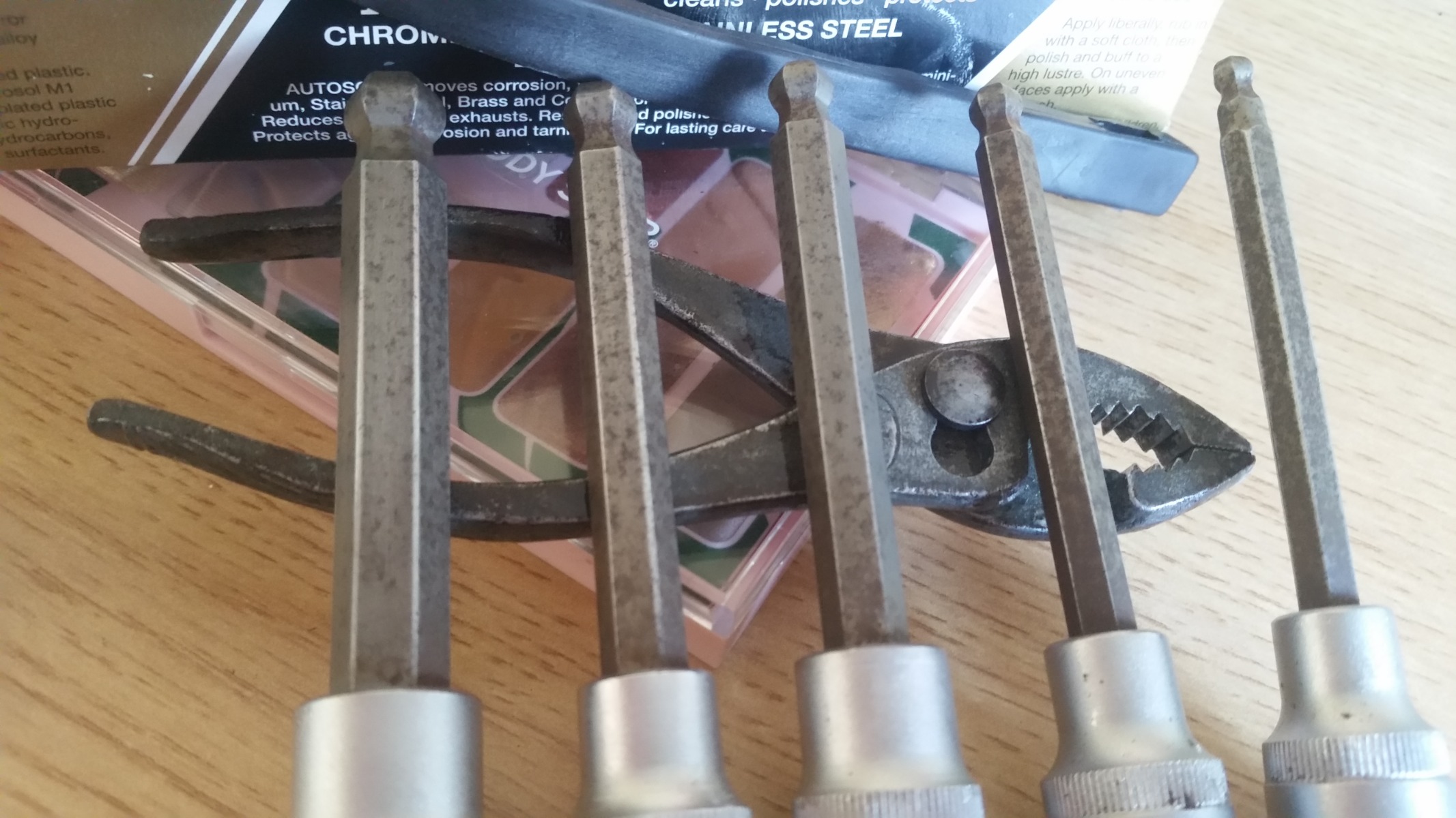

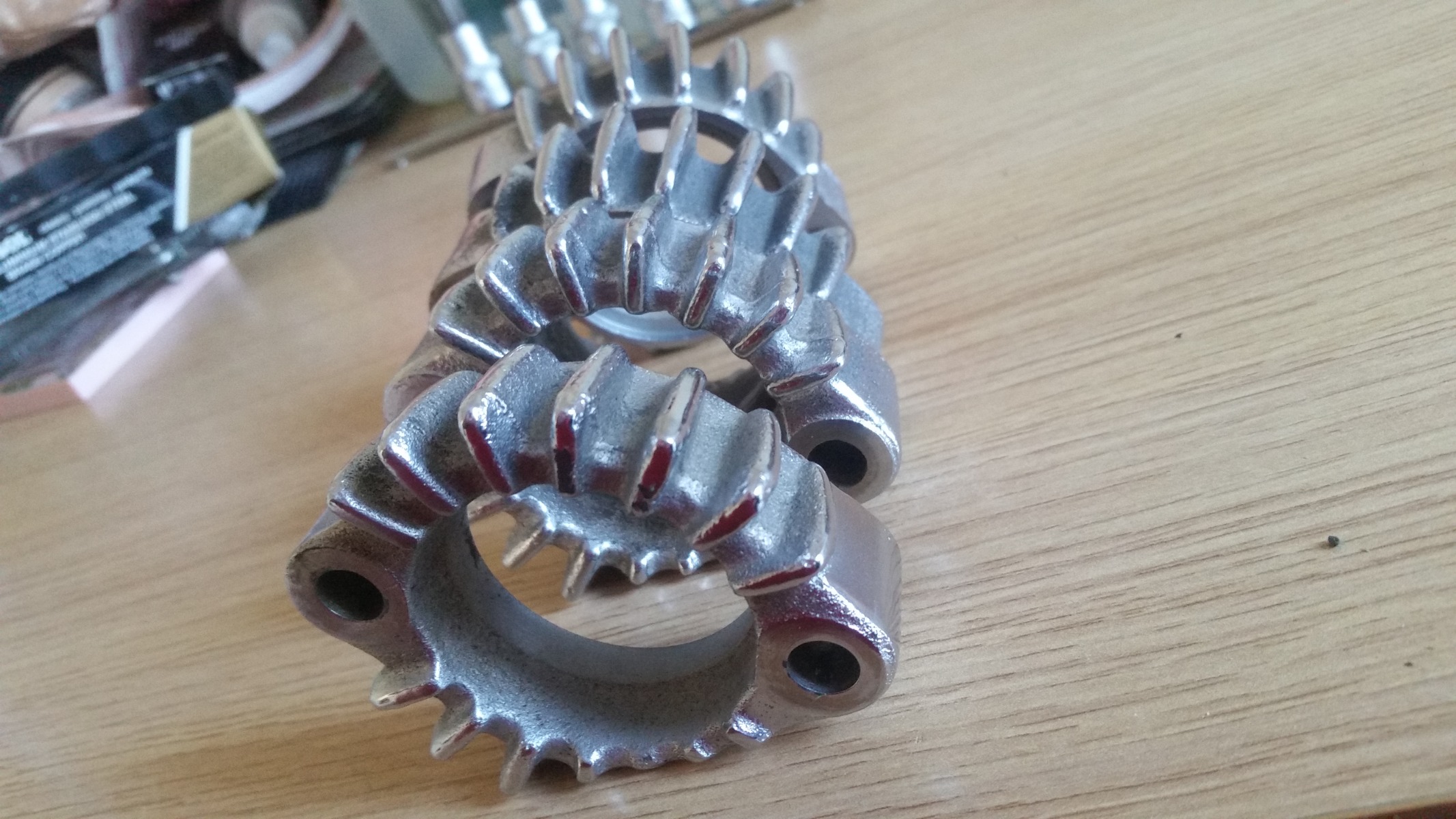

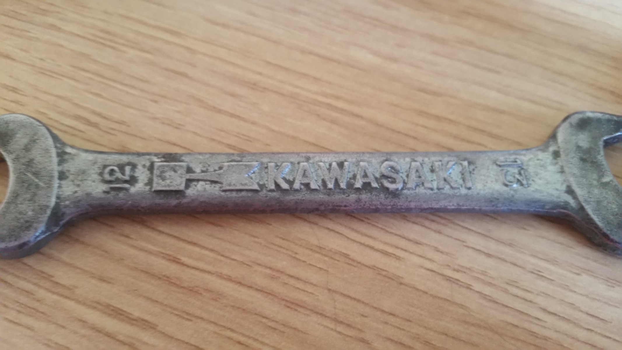

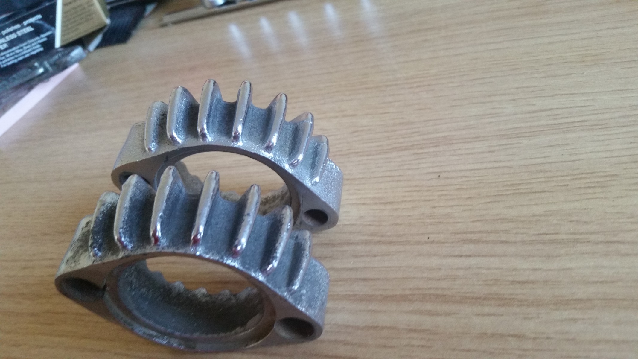

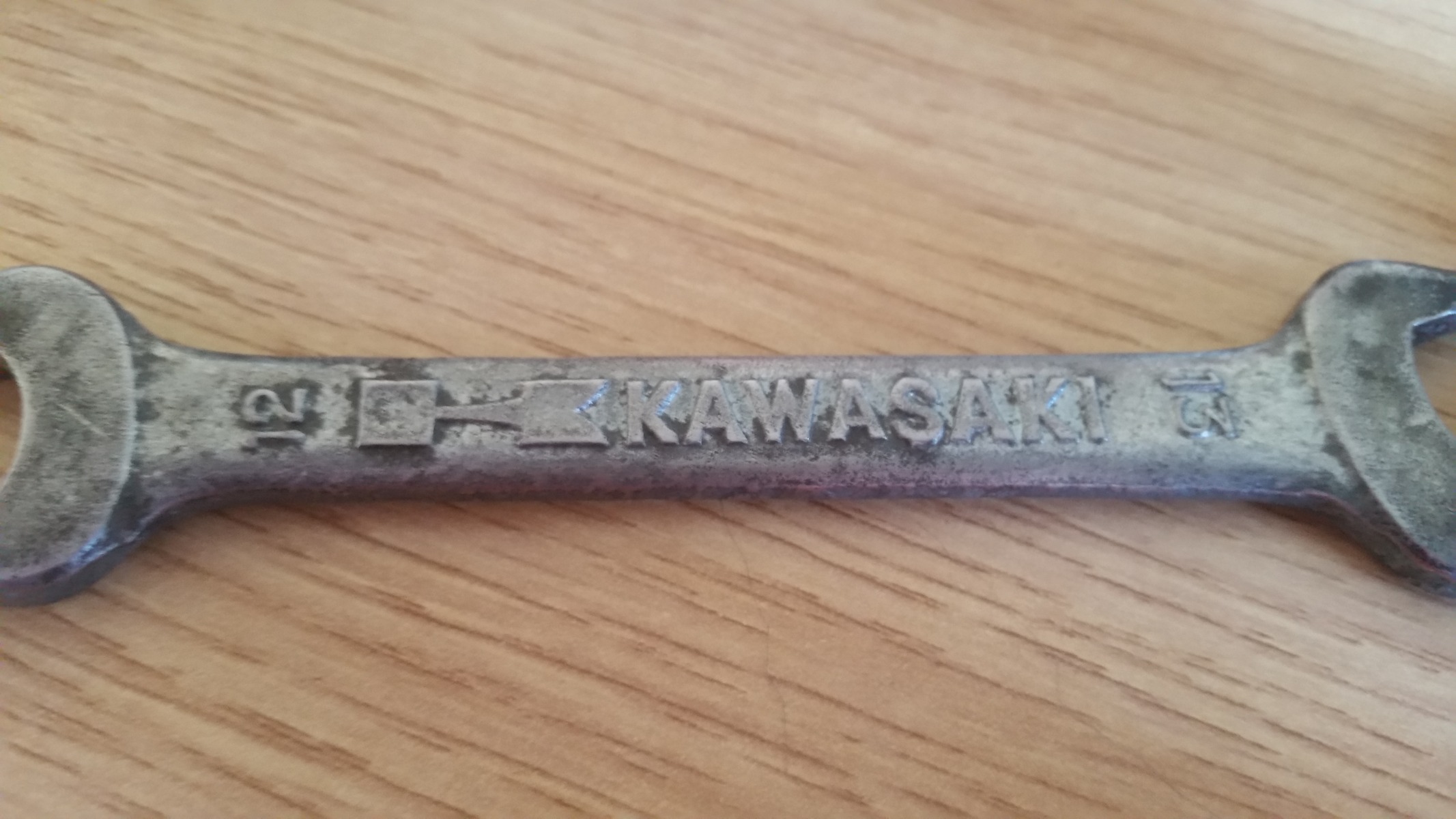

Mixed results!! After scrubbing I filled up the tray with very hot water and left for an hour then I thoroughly rinsed and dried everything and this is how everything came out, some things did better than others, I'm sure a wire wheel would improve things more and perhaps a metal polish but to be honest I'm surprised what the bleach did to these bits, it could be a useful technique on rusty exhausts and things?

HCl is harsh stuff and should be neutralized with some base solution such as baking soda so it doesn't continue to eat into the parts after rinsing. Phosphoric acid is much safer to the metal.
Edit: better still is oxalic acid. Found in many wood bleach products. The bicycle restoration guys love that stuff and with good reason; it eats off rust and don't hurt chrome or paint. A great mild cleaner that's environmentally safe.
