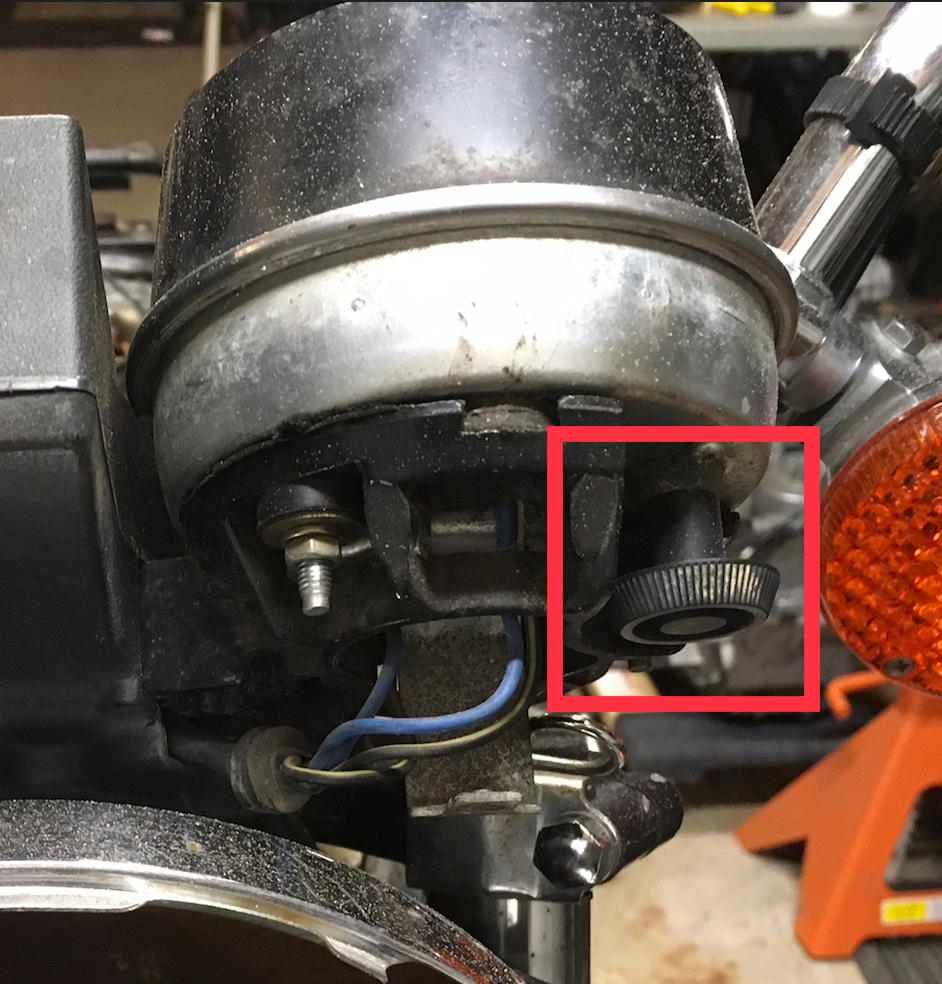

Hi,
I have a Z 900 1976 U.K. spec .
There doesn’t appear to be a trip reset function on the speedo.
Am I missing something obvious ?
1976 z900 1

Your missing this knob...? I have found them loose. Possible it has fallen off.

If the knob is missing, you'll need to know if the threaded shaft is a LH-thread or RH. My meters are different with the reset knob on the side, and the shaft is LH-threaded, so the knob is removed by turning it clockwise & installation is counter-clockwise.
