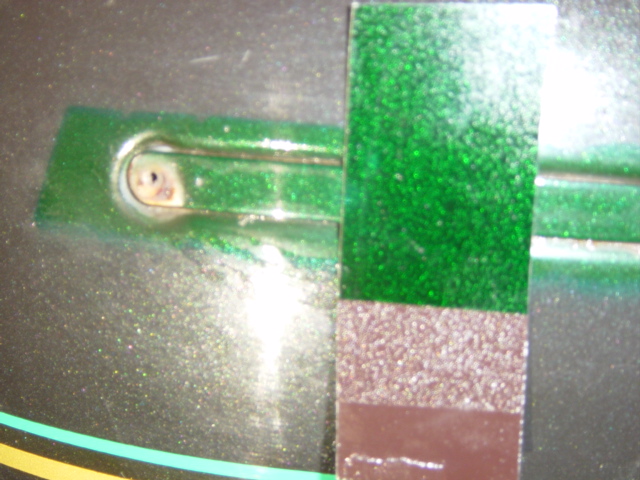

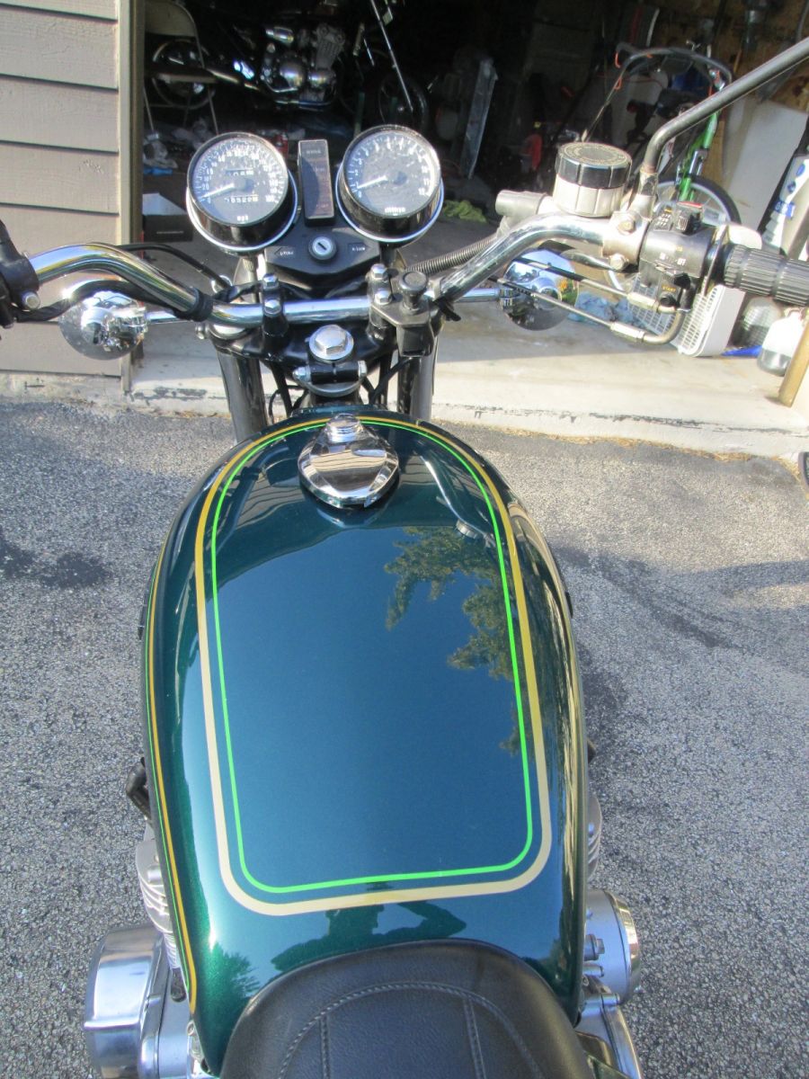

Has anyone ever compared Duplicolor's paints to the original Diamond Dark Green Kaw used on KZ900s? There's a deep green metalflake called "Deep Emerald Green" that to me looks very close to the Kaw color. I've painted two bikes with it using the Duplicolor as a base, letting it dry for a couple days then sanding it and hitting it with a few coats of Eastman 2K. Results have been very good and worked out well for me since I wasn't doing a museum quality restoration anyway. Just wondering how close my discount paint job is to doing the 3 part from Paintworks.

Looks great!
Not sure if it matches but the only way to tell is if an original was sitting next to it. I've been to car shows and have seen multiple Mopars painted plum crazy purple all different shades. lol

Yes, unless they're up next to each other it would be really hard to tell. The only thing I've seen with the Paintworks painted bikes is they kind of change color in different light and look a lot lighter in the sun... which is true for any dark color but the 3 part seems to do it more so.

Translucent Candy top coat over a true .002 " silver metalflake base will always pop in the sun. ......... just looking at your pics it just looks like a car color. But yours looks good and as long as you are happy with the look...most people will not notice the difference

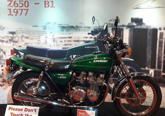

Khi emerald Green is a four stage paint process.
Primer, coarse silver, candy green lacquer, clearcoats.
I would guess 900 diamond green will be similar.
I'm also in the UK. RS Bikes paints will supply the correct colours, however it'll be water based crap at extortionate prices because they believe they have a captive market. However I'm fortunate enough to know who supplies them and I'm only a few miles from them in NW Kent.
If you contact GB refinishers in Dartford (by the QE11 M25 Thames Bridge) they have the mix formula's they supply RS Bike paints and will mix the correct colours in a solvent base paint. All they need to know is colour description, model and year.
It is illegal for them to sell solvent paint in quantities greater than half a litre but hal a litre is plenty to paint tank, 2 sides and tail.
I have painted candy emerald Green several times on restorations I have done.
It was my single owner 650b1 kawasaki borrowed to go side by side on the show stands the world over when they launched the new z650 in 2016.
