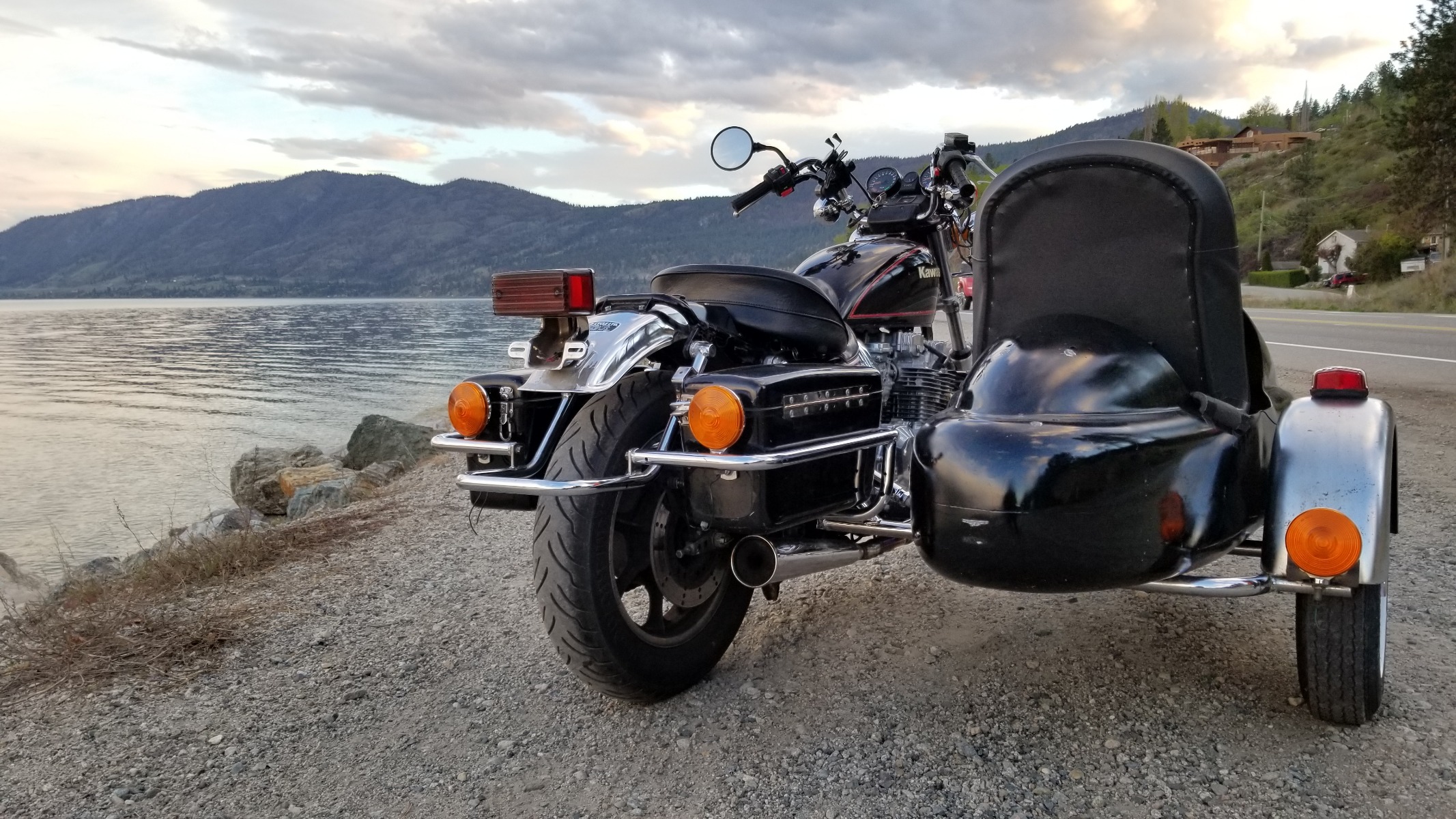

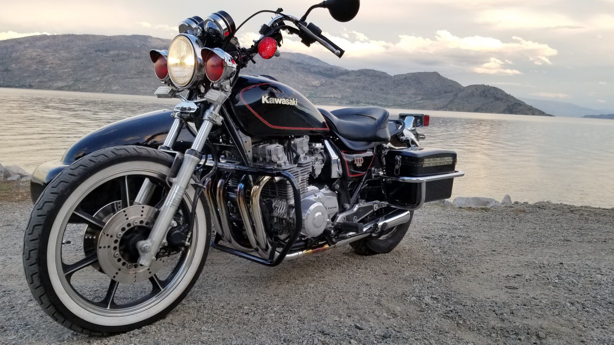

I recently did some work on my 1982 KZ1000 LTD. It is now a kz1000p police conversion minus the fairing bolt mounts.
I have luggage from a 1993 kz1000p police unit.
The sidecar i bought for $130 USD at an antique shop in Oroville, Washington. Ive had it custom mounted to my kz1000. I had the mounting hardware made and chromed. Reinforced the police crash bar as its a load bearing unit now holding the upper sidecar mount.
I did the paint and bodywork myself. Turned out rather well because of the amount of prep work that went into it. I used some cheap cans of gloss black spray paint.
Sidecar seat was reupholstered, luggage rack was repaired and painted gloss black as well.

That's pretty darn cool!
More pictures please

Looks amazing!
I'm not sure why, but I read this last night in my random wanderings.
Just something to keep an eye on.
motorcycleproject.com/text/vintage_chassis.html

Police conversion? So you put in the upgraded stator and oil reservoir? Because aside from the mounting tabs for the crash bars and front fairing, that's really the only difference.
