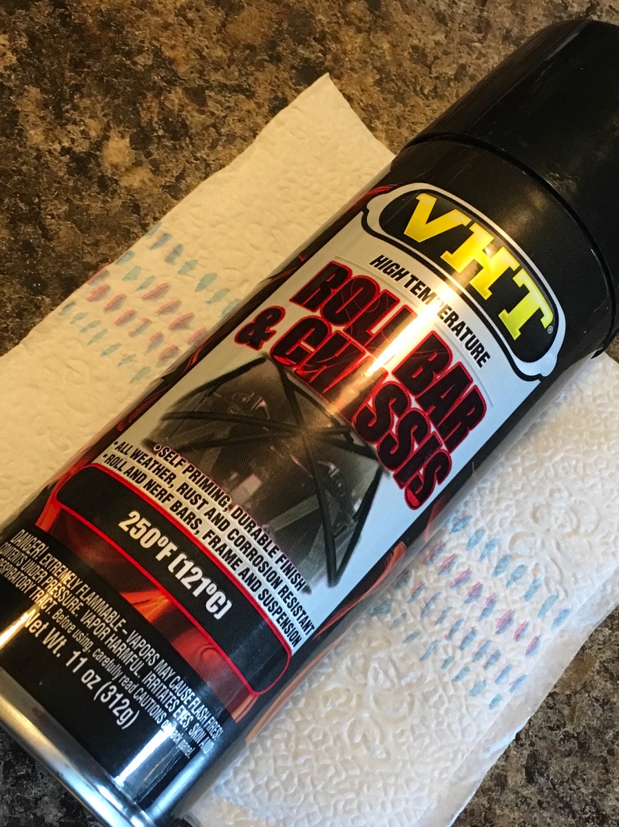

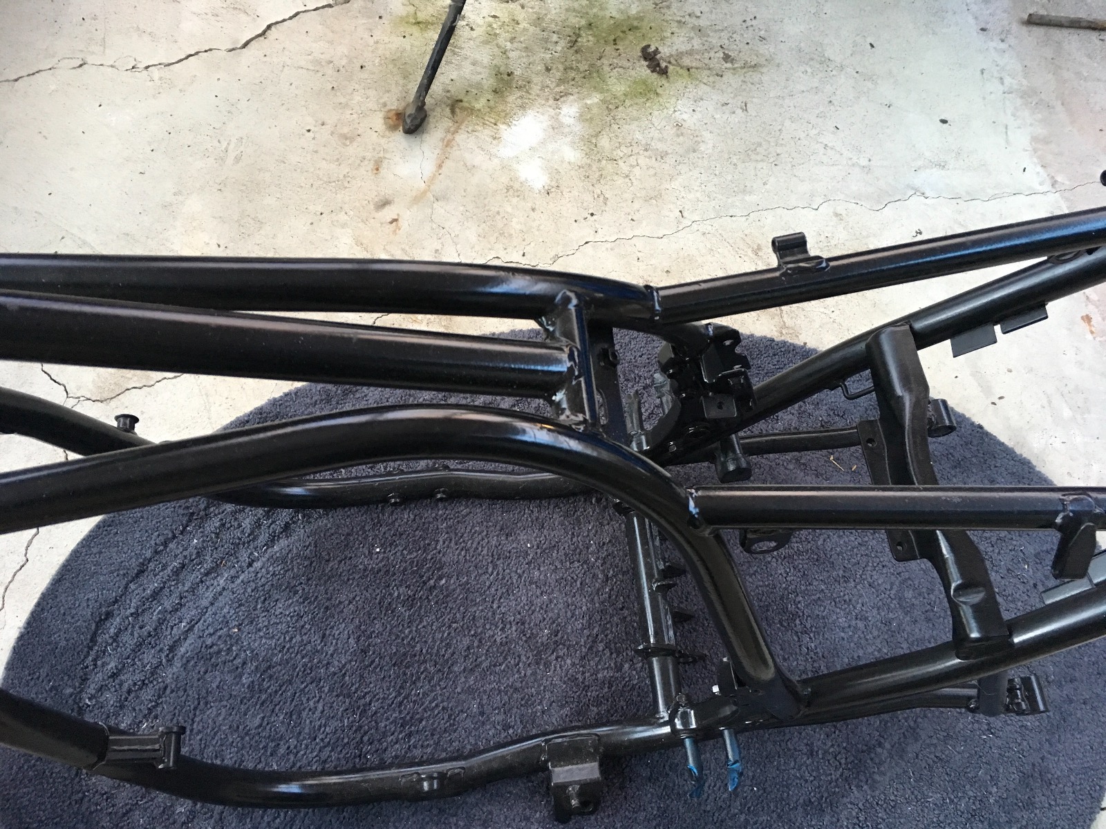

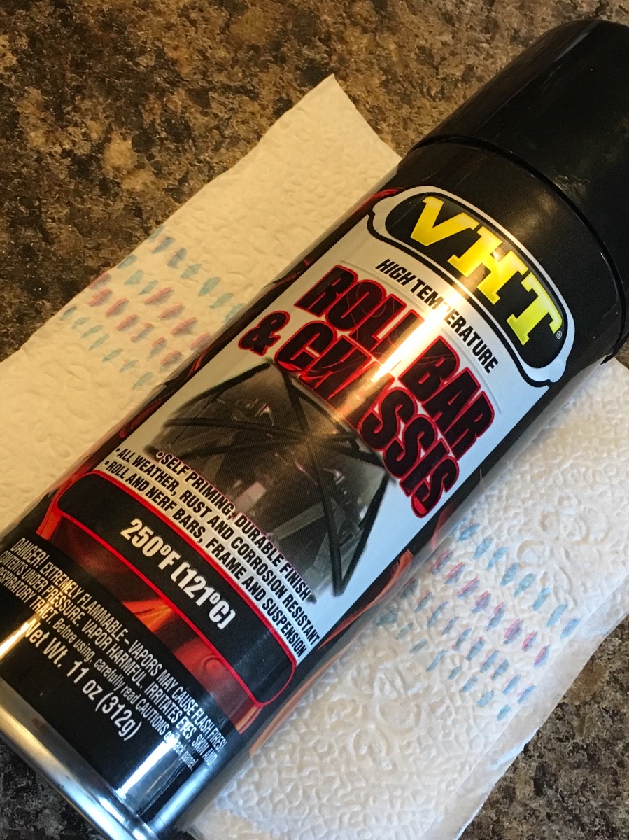

I’ve used VHT with good results. I started using it when I noticed it was undetectable when I did touch ups on a few rough spots on my 1978 1000 LTD. I painted an entire 1977 frame with it for a frankenbike build to use up all my extra parts.

It appears pretty glossy in the photo. Is that the case? Thank you.

I have a 1976 A4 frame fresh from powder coat. Picked a satin finish but it still has a nice gloss. Tomorrow I can set the to side by and take a photo. There pretty dang close. As far as matching factory color and sheen the VHT matched so well I cannot tell you where I made the touch ups.

From another topic >> reply By MDZ1rider: I've tried just about every brand of black rattle can I could find over the years, comparing them with original factory painted parts. Here's what I've settled on: Frame, brackets, seat pan and lower triple clamp - Rustolium Semi-gloss black.
Upper triple clamp - Rustolium outdoor Satin black Engine cases and front hub- PJ1 High Temp Fast Black S (satin).
Paint snobs may laugh, but I tend to stick with Rustoleum. The quality is good, It's easy to use, You can buy it anywhere and the price is reasonable. Kawasaki didn't put a lot of time and effort into frame finish. If you're looking for an original appearance, a rattle can of semi-gloss will do fine. VHT Roll Bar black falls in between satin and Semi-gloss if you feel Semi-gloss has too much shine. END.
