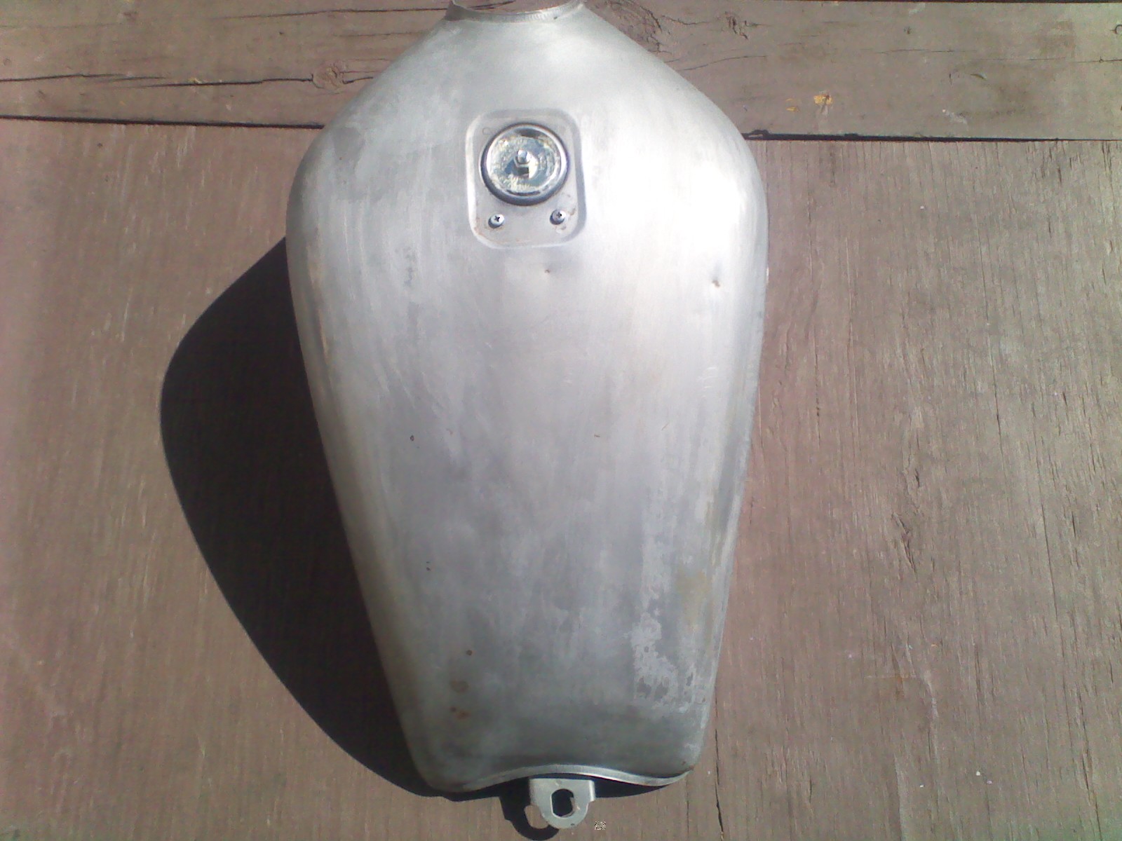

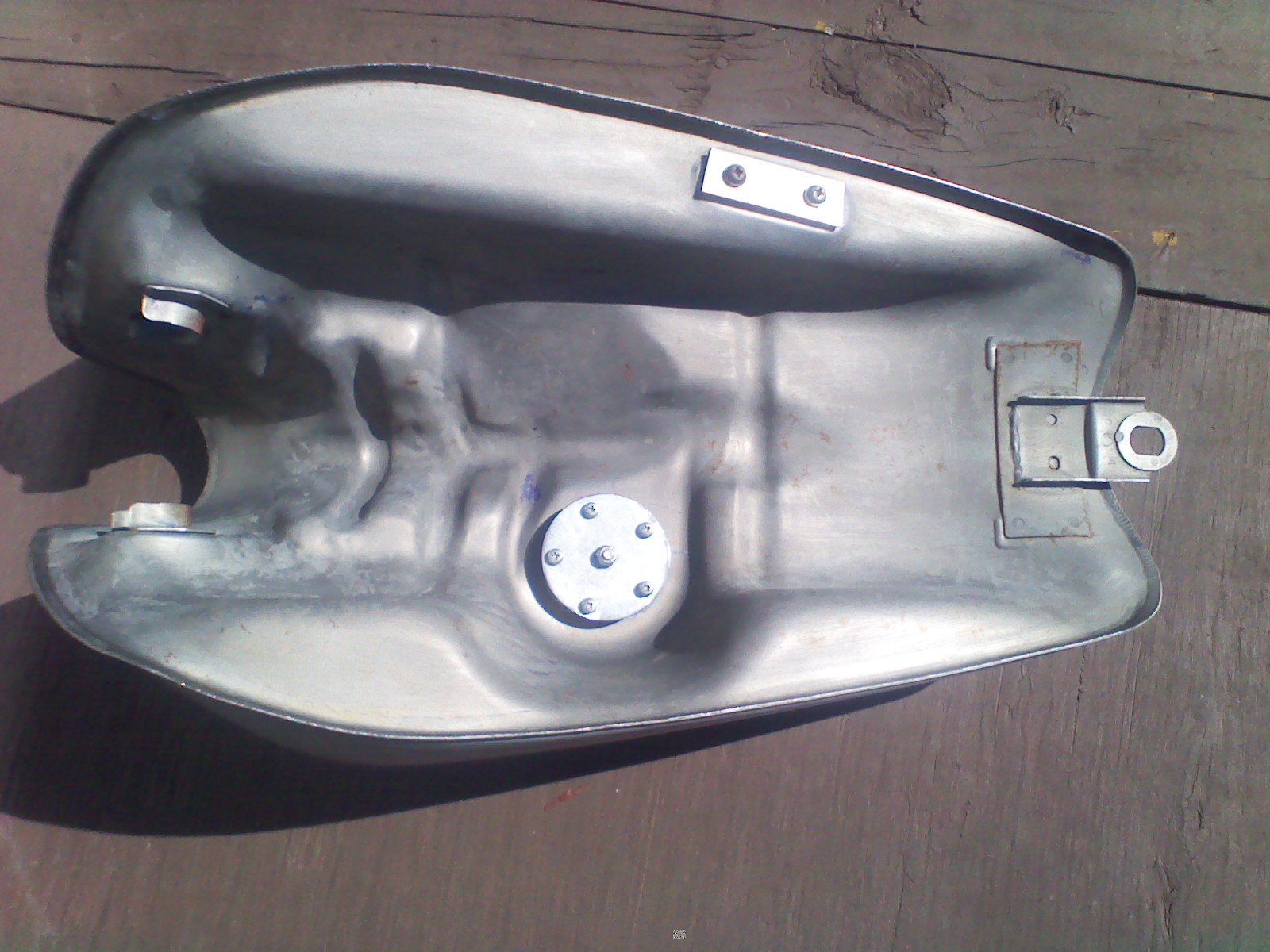

To seal the tank for treating rust I made block-off plates for the petcock & fuel switch openings, and used a freeze/test plug for the fuel filler opening. I put teflon tape on the bolt threads & used nylon washers and cut sections of sheet rubber to seal the block-off plates. The tank was already painted before treating the rust & was unscathed.

Did someone mention plugs? The expanding rubber plug martin mentioned above works great on the fill hole. Use the screws with o-rings to seal the cap hinge attachements.
The other holes need block off plates.
