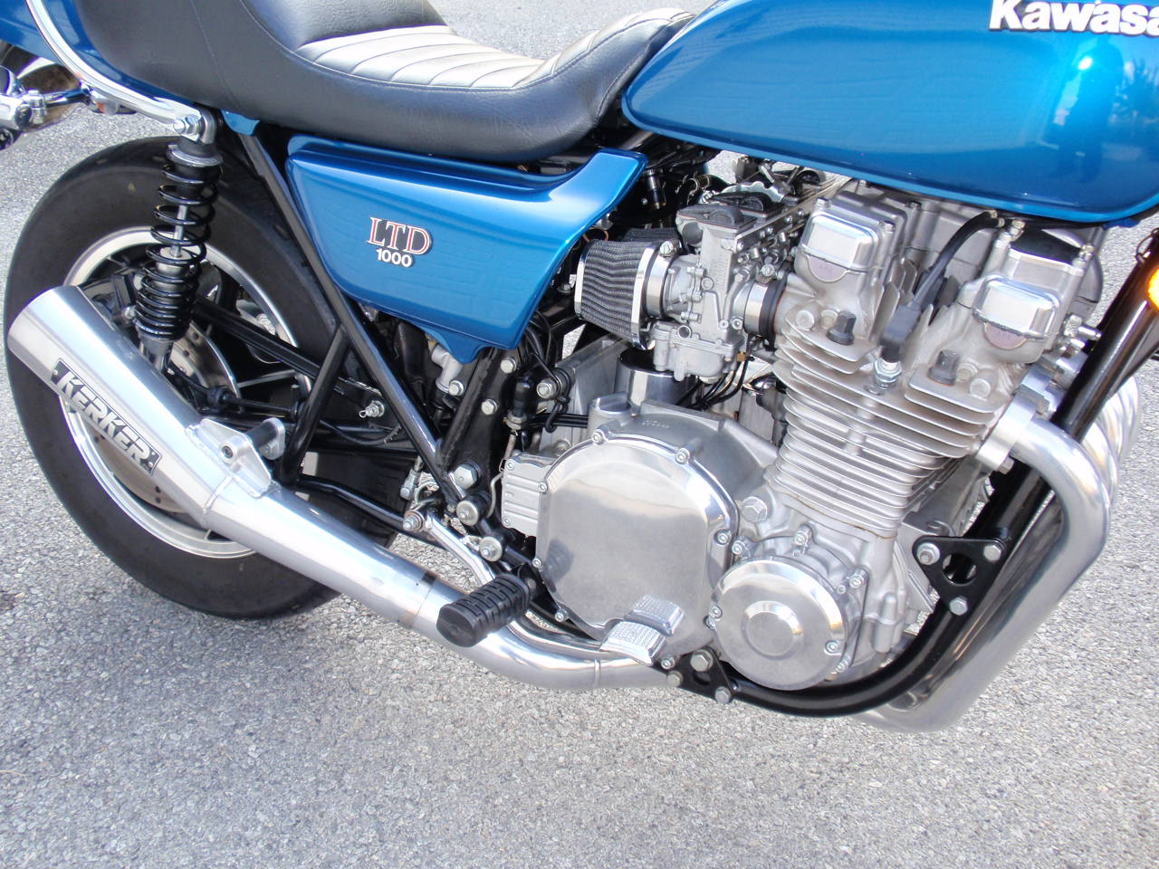

I agree with martin_csr on both points. Also, even if you did find a chrome shop that could redo your pipes, you might find the cost to be out of reach.
The ceramic-type high temp coatings are perfect for exhaust systems. Very "chrome-like" in appearance and durable. Here's a link to the Jet-Hot company that martin mentioned: www.jet-hot.com/classic-polish/ . Also, I've attached a pic of the Kerker system on my LTD. It was coated inside and out when the system was brand new and still looks great 20 years later. The company that did it was HPC. Not sure if they're still in business as I couldn't find any contact info.

Thanks for the pic. Looks great! 20 yrs is amazing. That system may never rust.
