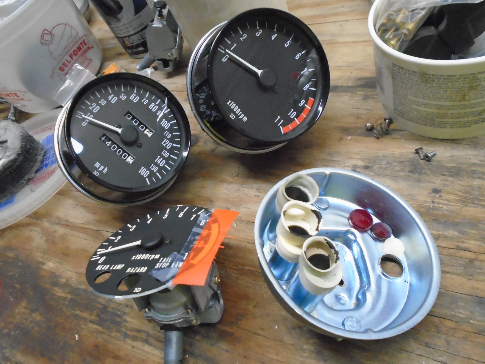

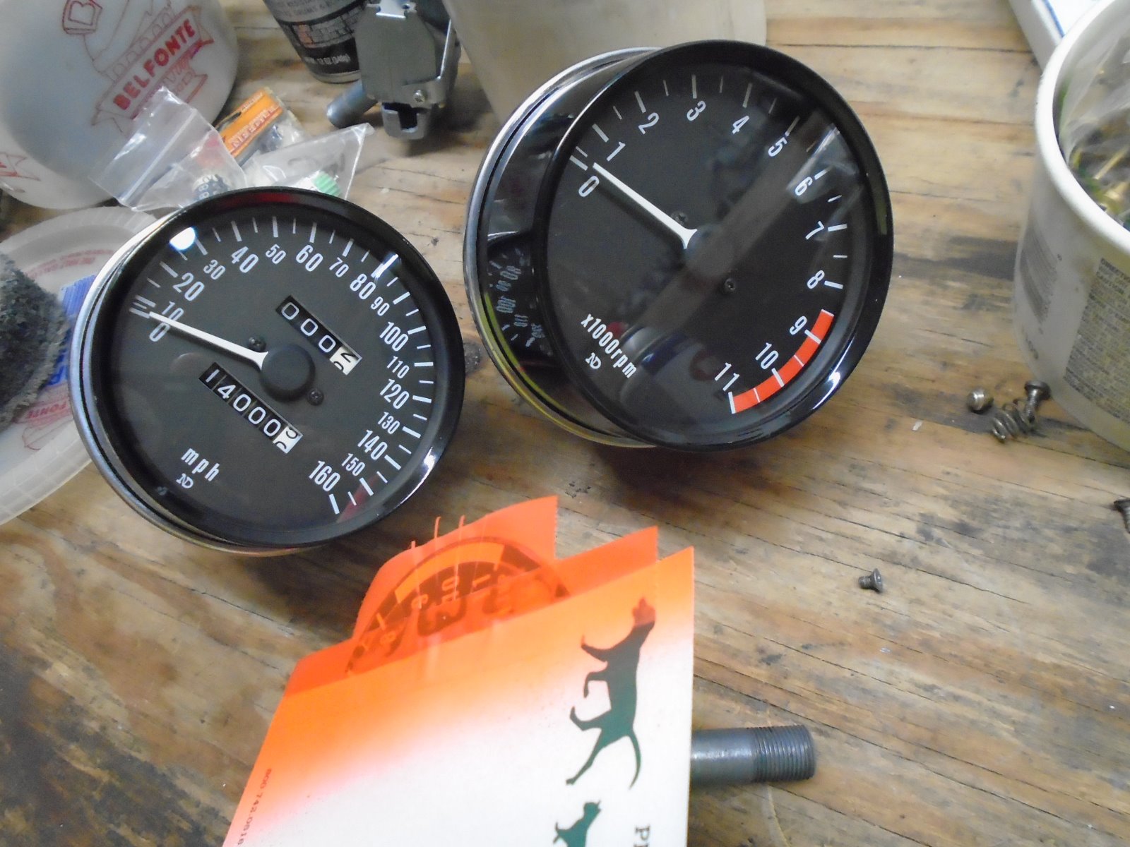

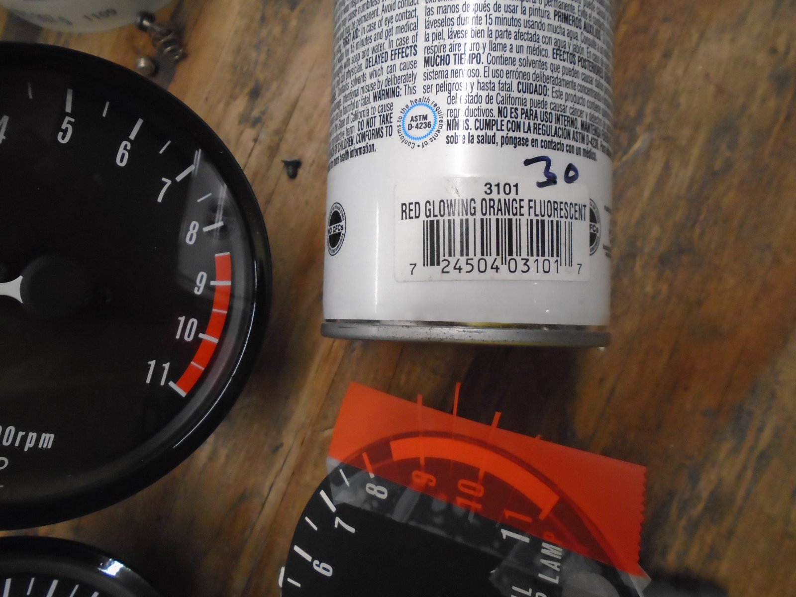

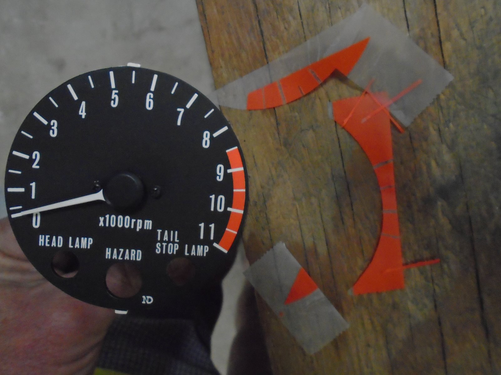

Thanks for the Kudos Mikaw! I can do instruments but at the same time I love to promote the DIY spirit. Got a crappy instrument, what do you have to lose by experimenting and gaining a wealth of information. Example of Mikaw's completed gauges and a Z1R i'm doing just because it was laying around and I got bored this morning. You can purchase replacement faces but if the existing is decent I just clean and on tach faces I re-paint the redline. Investment, scotchtape and a can of paint. The completed one of Mikaws was repainted also. Oh and a Steady hand/patience is required. Lots of other tricks can be applied also for the mechanical aspect. If it doesn't snow too bad today i'll shuffle up to the post office and you'll have them in a jiffy Mikaw.
