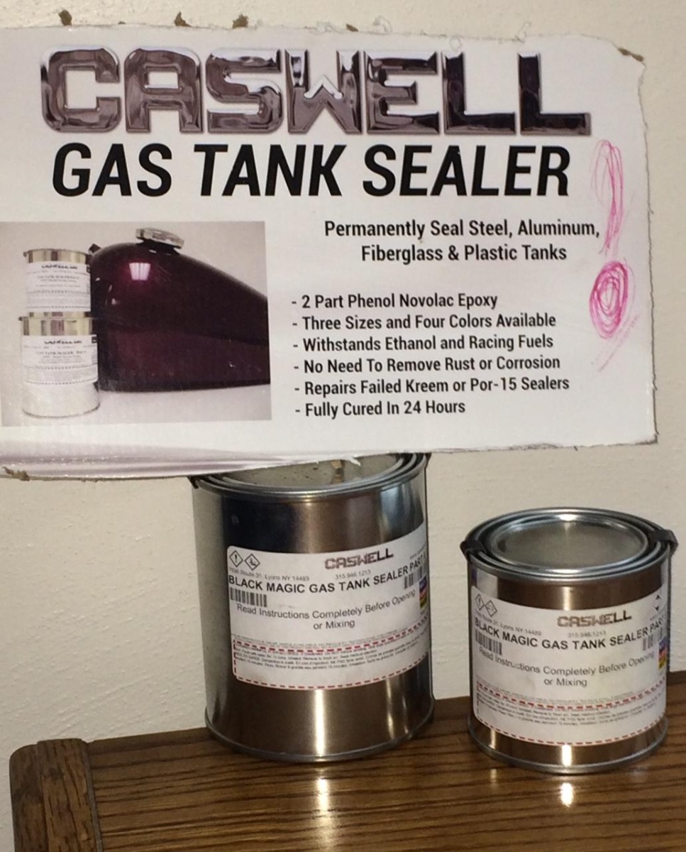

Here is the best sealer out! And I go back to using KREEM in the late 70's.
"CasWell.com" product. It is a 2 part Phenol Novolac Epoxy.
It actually like rust and scale. It gives it a substrate to adhere to better.
Phosphoric acid is good to use, I like the Home Dep rust remover gallon, about $17
And acetone mixes with water, and at the end of cleaning, it will all evaporate with compressed air.
I used it on a set of OEM Harley tanks from 1968 for my FLH.
Paid $49, This amount will do 2 Kawasaki tanks. In warmer air, (summer) when mixed has about 20 minutes work time.
