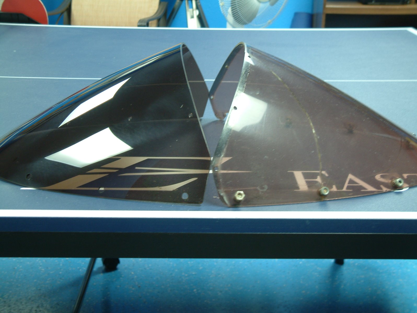

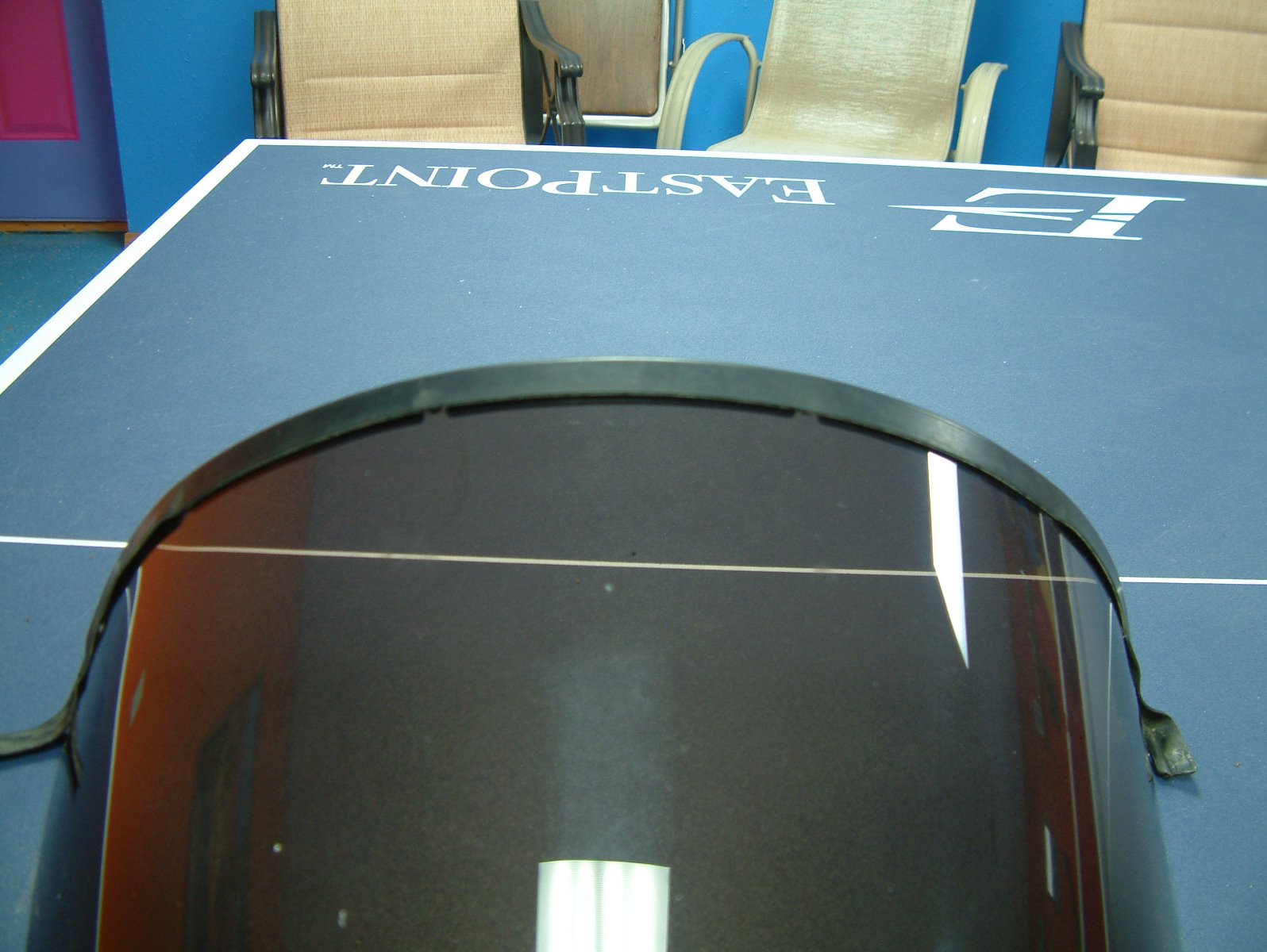

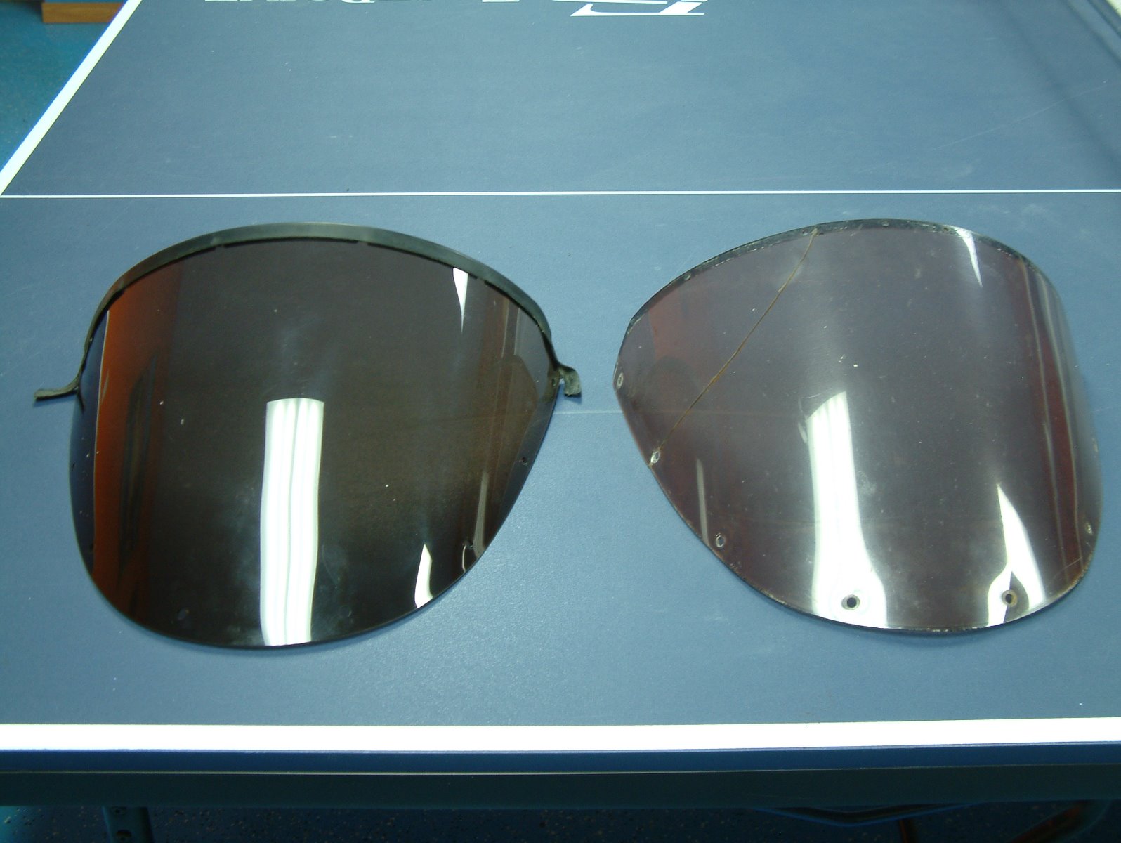

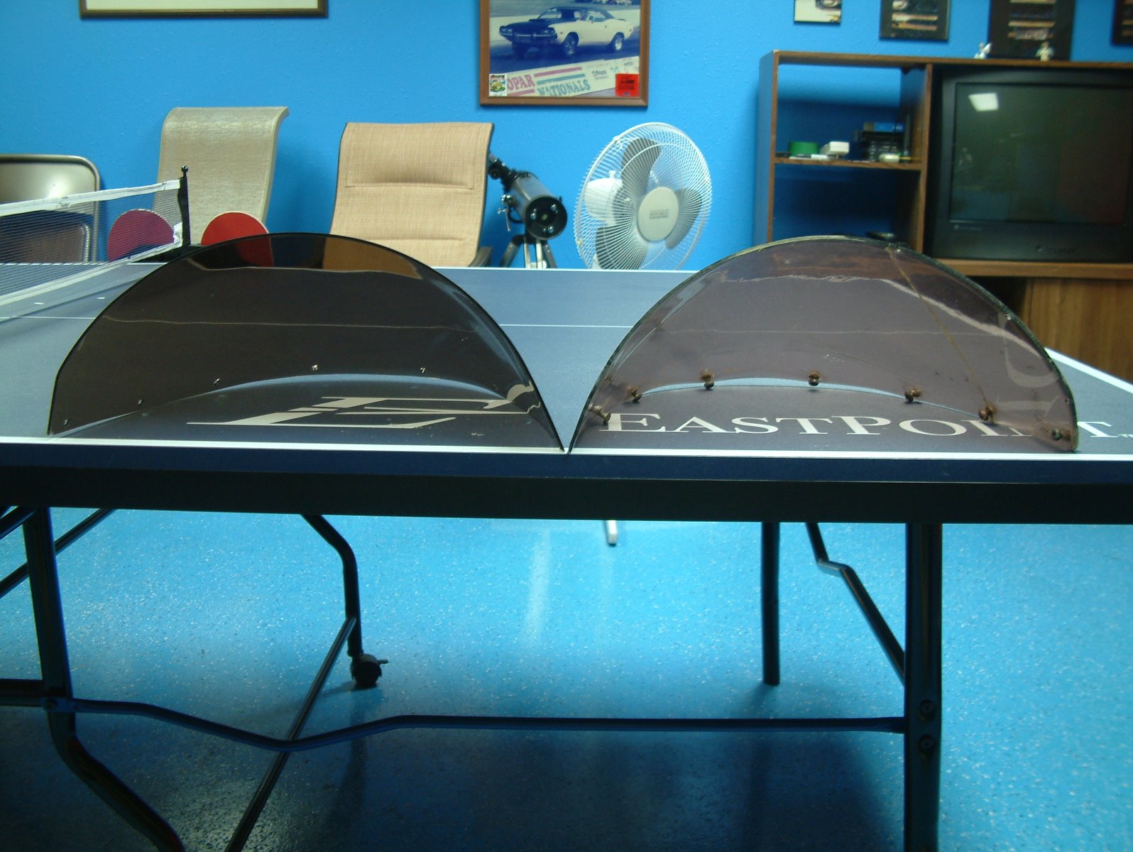

Got a windshield from Red Line Cycle, it is shaped and cut correctly and the color is at the least very close to right. When comparing it to my 42 year old stocker it's darker than were the sun bleached it and a little bit lighter than under the rubber trim at the back. I drilled holes to mount the stock rubber trim again, luckily all went well and they drilled without any problem. I used a standard steel bit in a drill press running at 650 rpm, and light pressure with a wood block under the plastic for support as I drilled.
