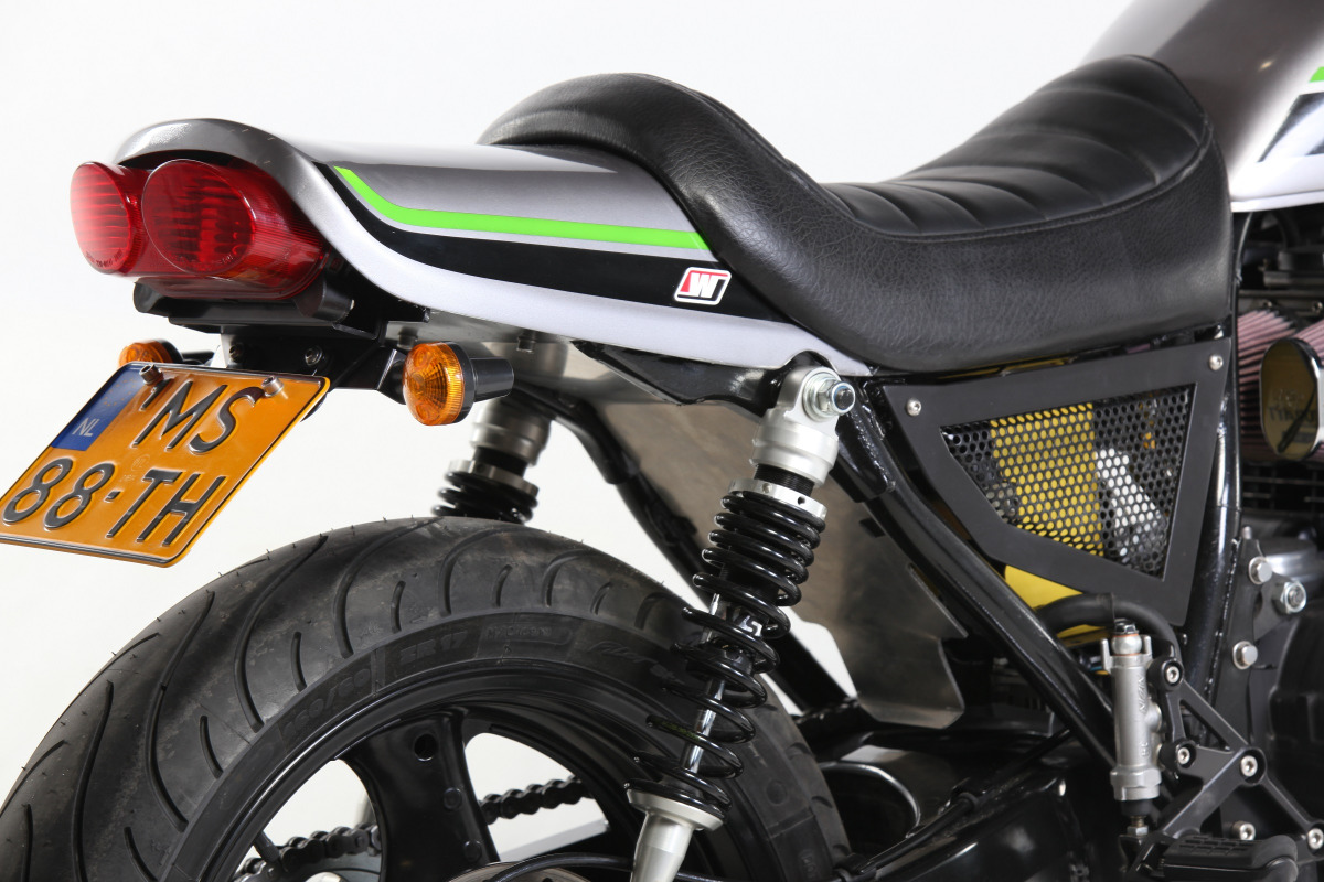

No eBay APP ID and/or Cert ID defined in Kunena configurationI bought a replica of a 900 duckbill off ebay.
It turned out to be too narrow for my CSR1000 frame but being fiberglass,I was able to chop it down the middle and widen it to fit;
