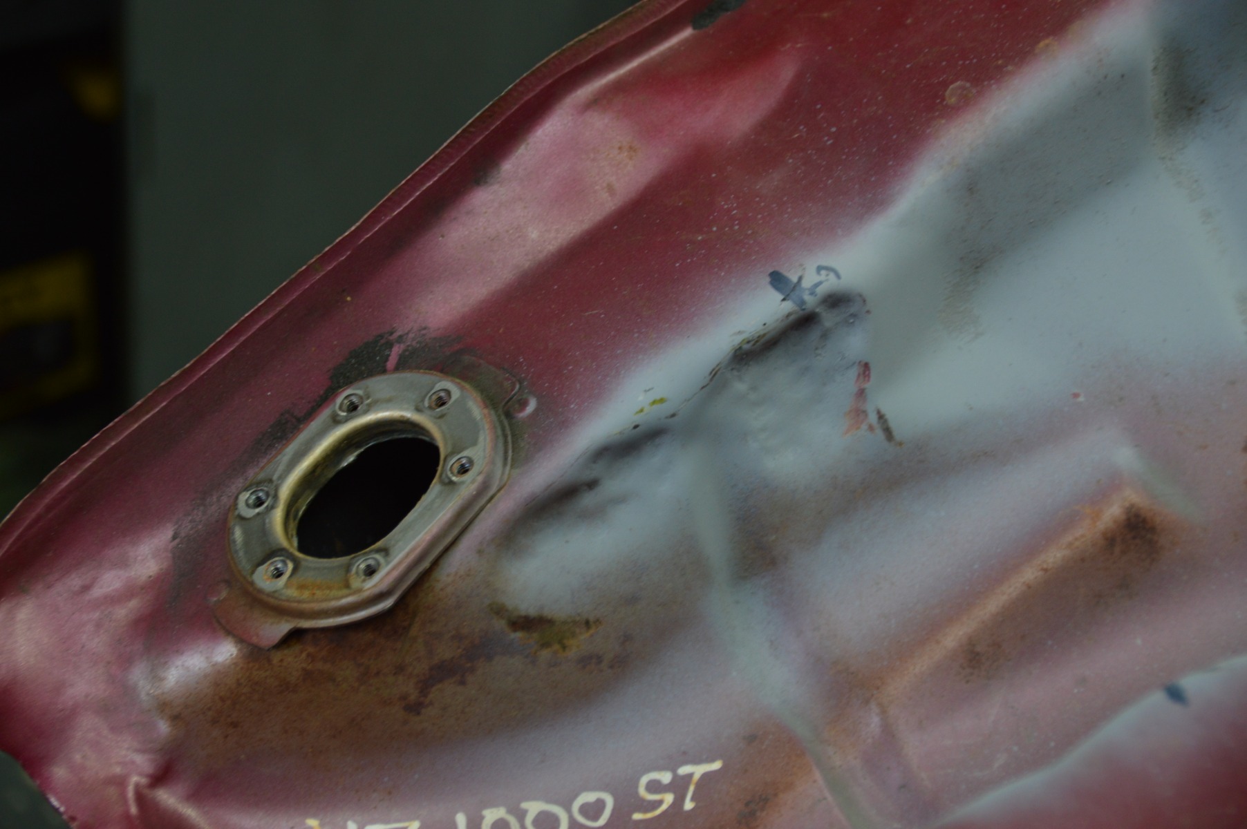

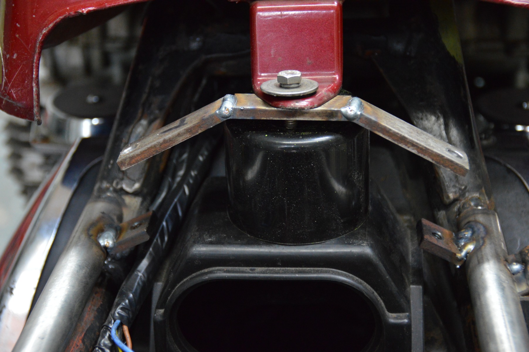

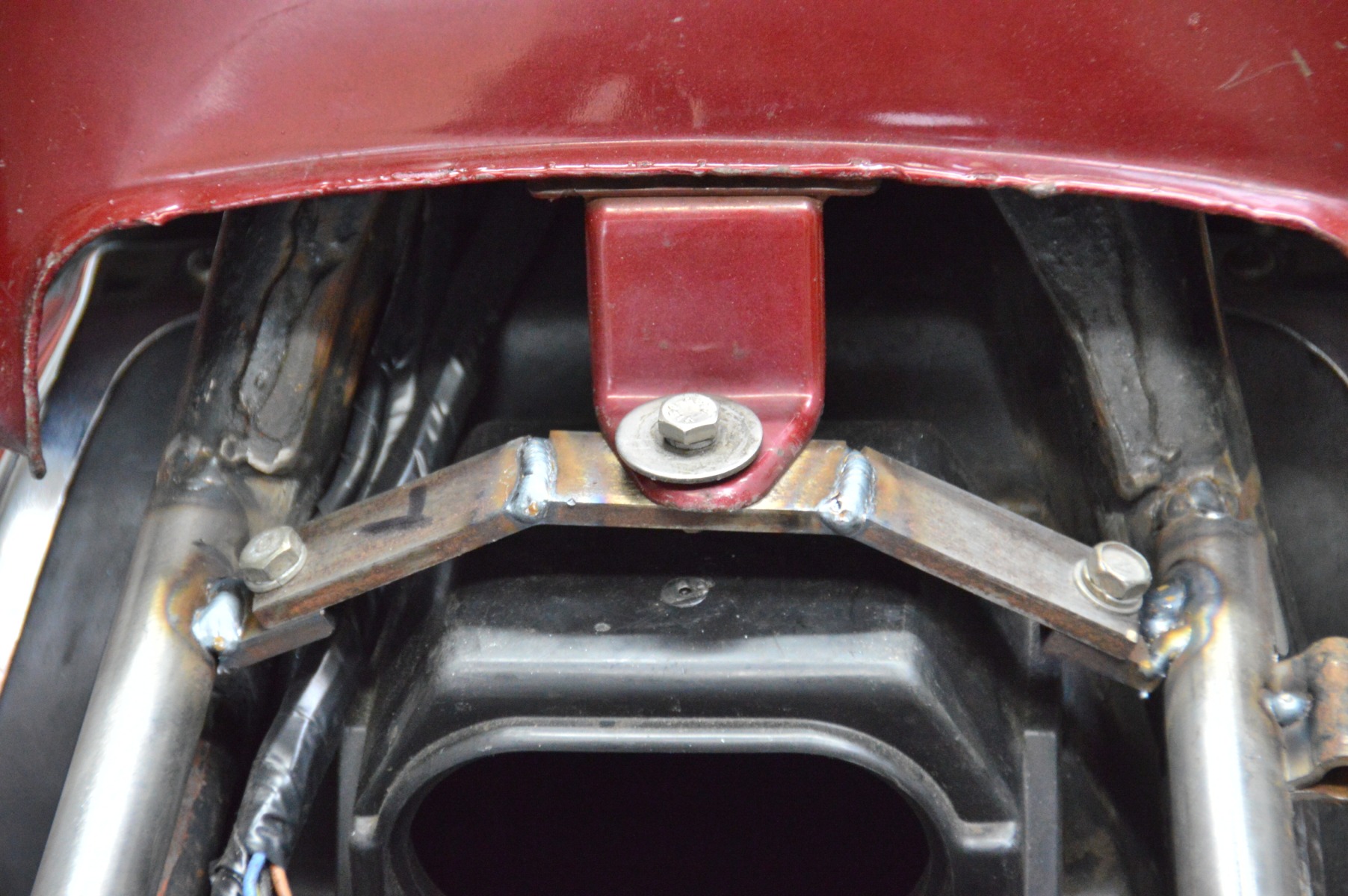

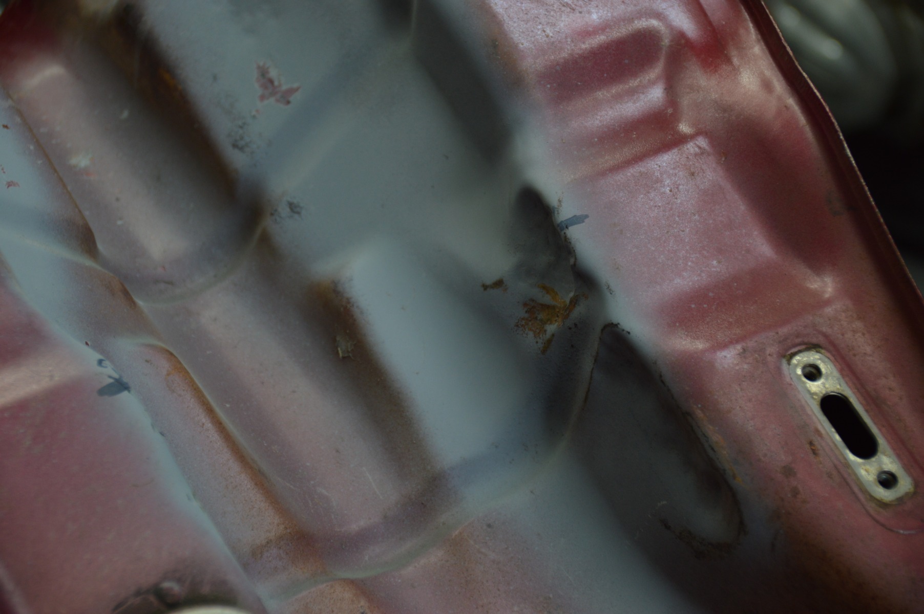

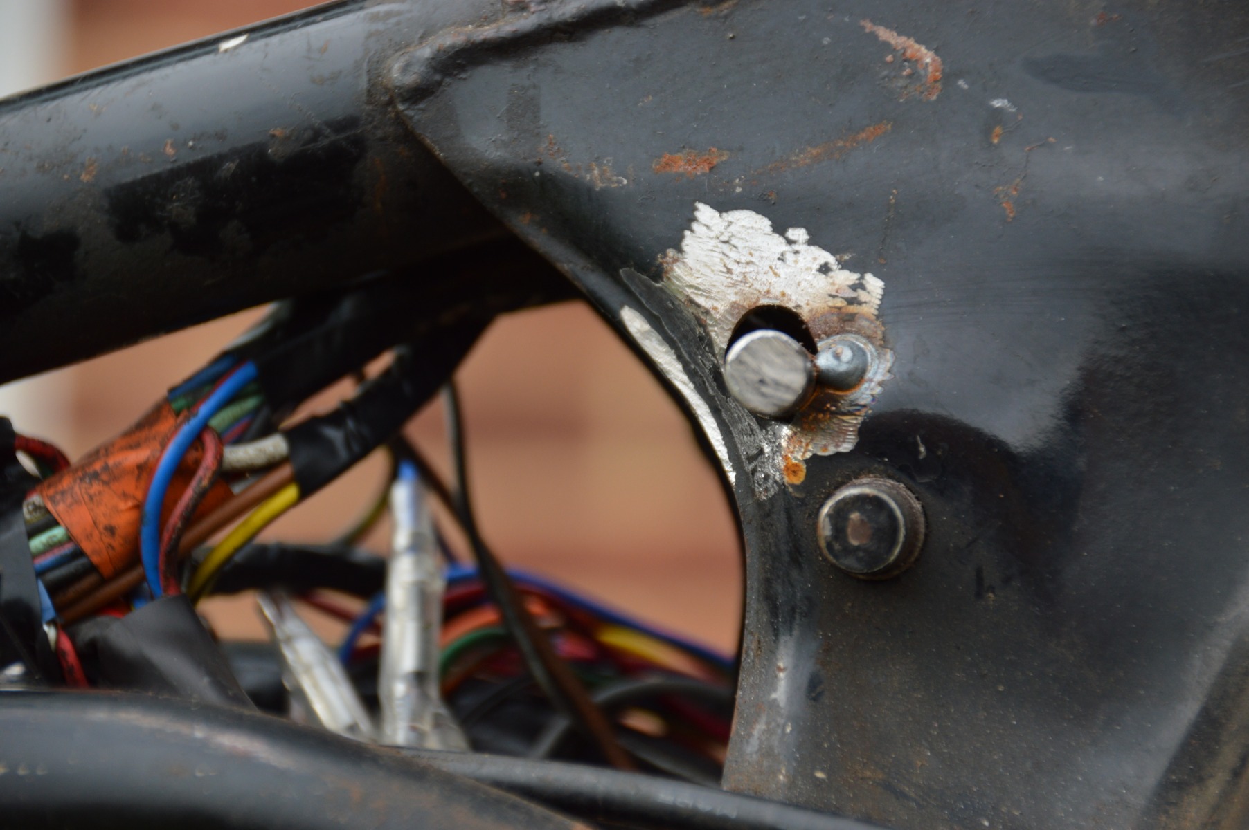

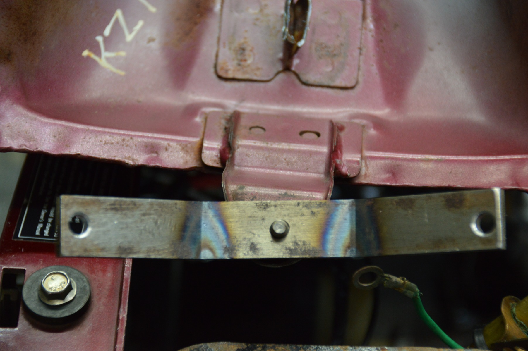

i thought id better answer my own question on the tank fitting. it may be of use to someone else. the forks clear the tank with minimal space but do not hit. CSR 1000 triples and legs fit as do KZ1000p triples and legs.. some pics that may be use full front mounting pin rear mounts i want to keep the original airbox so had to get a bit creative
