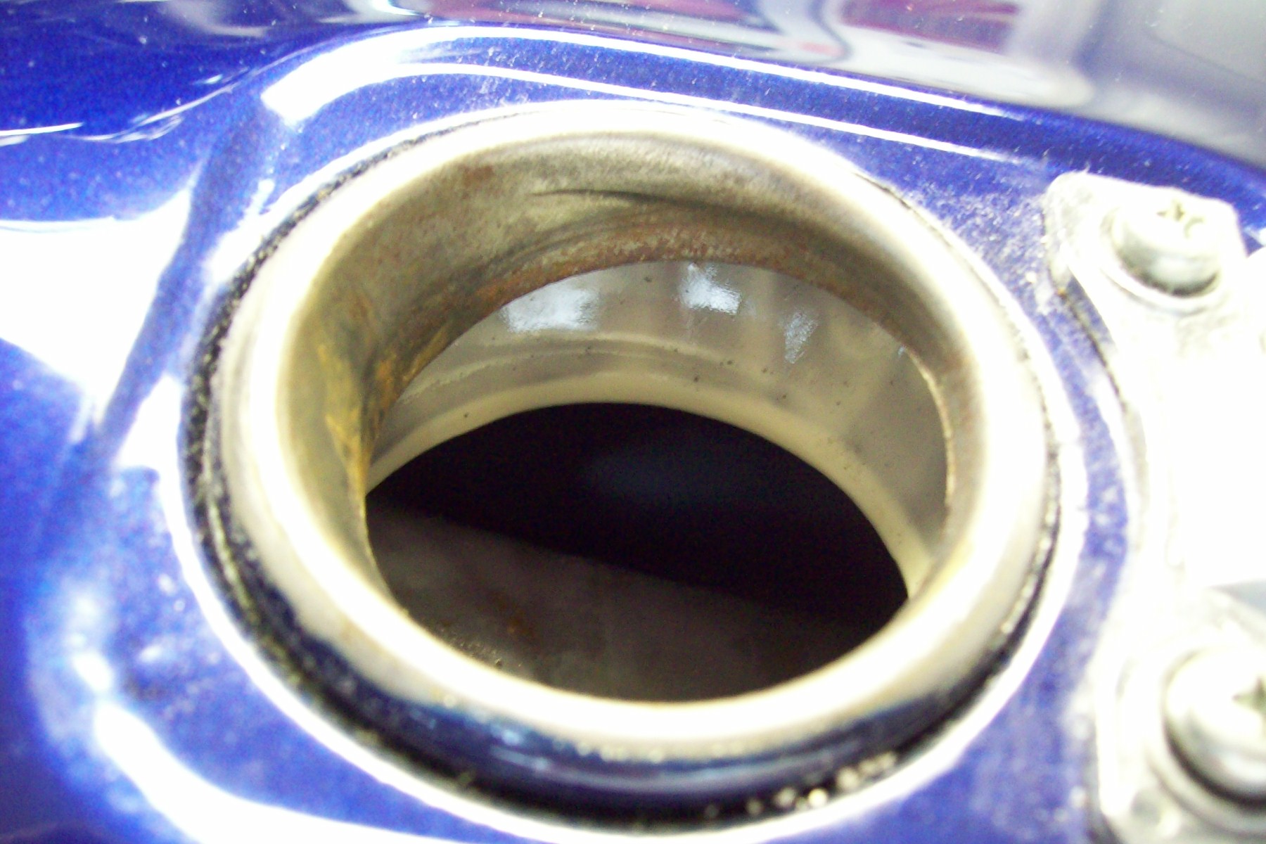

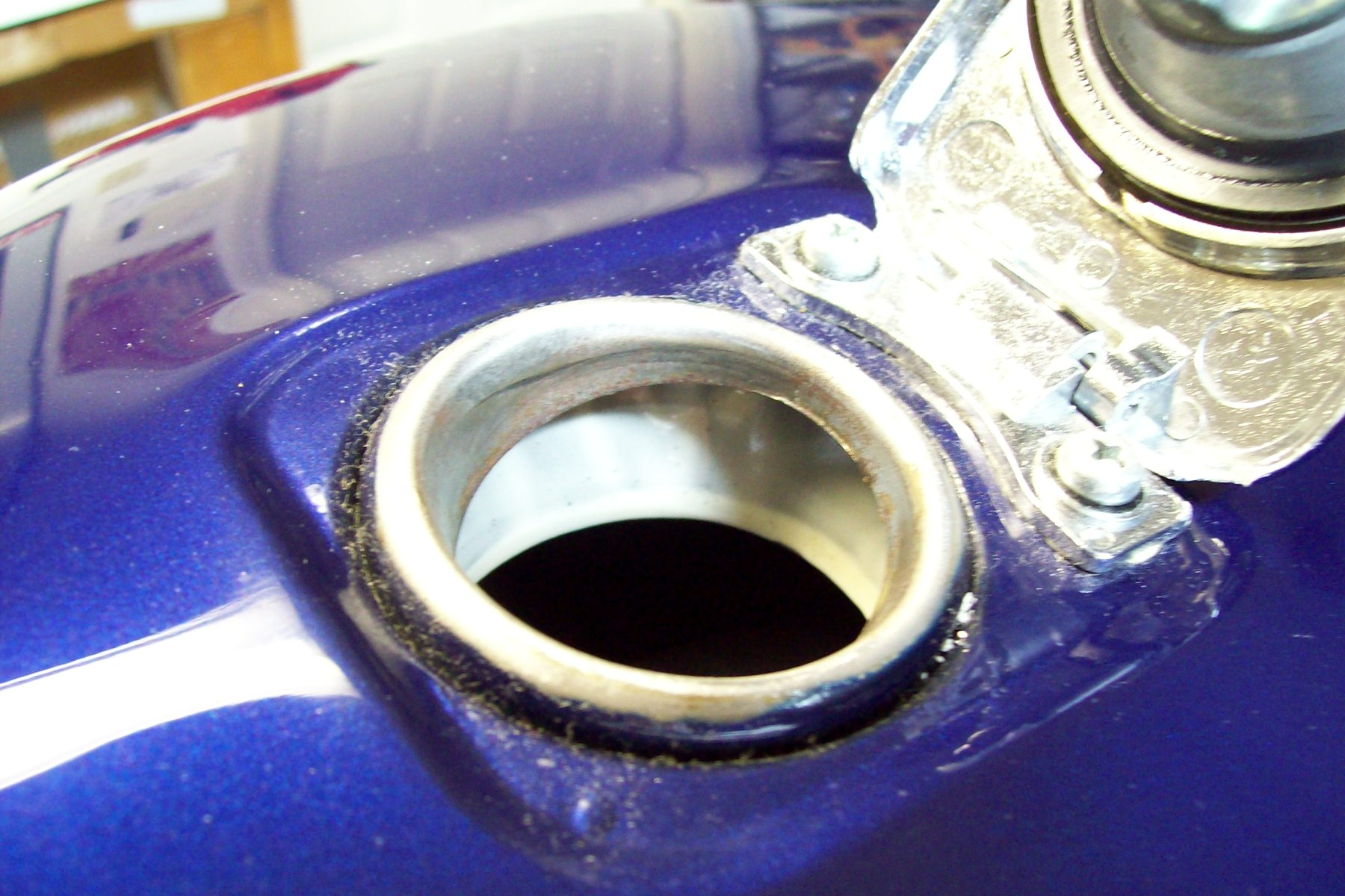

Are you sure your MK. II gas cap itself is leaking?? Kawasaki had a service bulletin on fuel leakage from MK. II gas caps. It was not the caps them self, the fuel leakage was coming from the two 5mm screws that bolt the gas cap to the tank. When I first put my MK. II Superbike together, I did have fuel leaking around my gas cap!!!! Kawasaki in their service bulletin told you to use two new o-rings that fit into grooves on the bottom of the mounting bracket of the gas cap. Then use a sealant on the threads of the two 5mm mountings screws and their plastic sealing washers to keep the fuel from coming up the threads. The bulletin also stated to make sure there was no type of paint on the sealing area where the rubber gasket of gas cap would come in contact with the tank. Plus it said never fill tank any higher than that inner lip that is about 3/4 of an inch below the top of fuel tank.
I went a step further than the service bulletin said. I used TB-1211 sealant on the o-rings, the two 5mm screws, and on the plastic washers that fit around the two 5mm screws. Then let it set up for 2 days or so before putting fuel back in tank. After doing this, my MK. II fuel tanks NEVER leaked a drop of fuel ever again!!!! I have always run my MK. II's on race fuels like VP's C12, or UniCal leaded 105. In real hot weather a fully filled fuel tank with race fuel would expand so much that the caps actually hissed!!!! But no fuel leaks!!!
The inner lip I am talking about can be seen in this photo. The white coating is Kreem coating I did back in 1979!!!!
Notice there is no paint on the sealing surface where the gas cap rubber would touch the tank.
You can see some of the TB-1211 sealant oozing out from under the cap mounting bracket.
