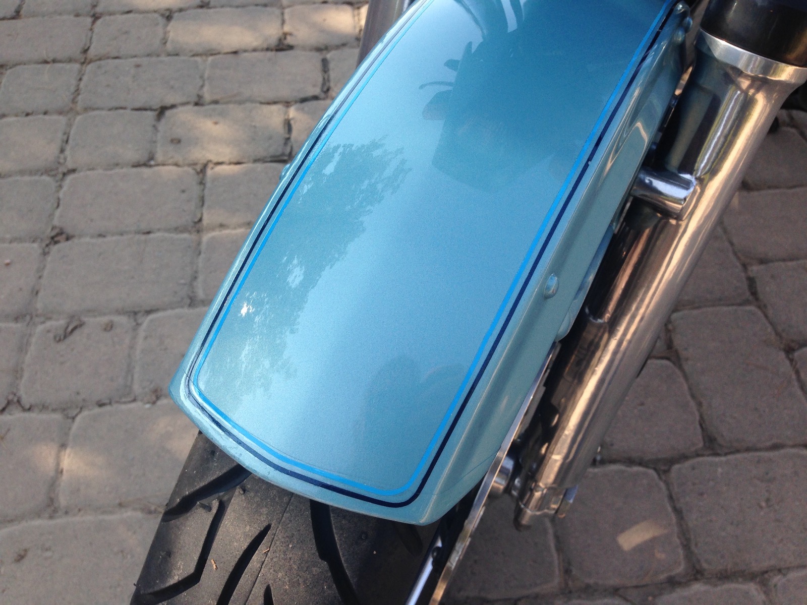

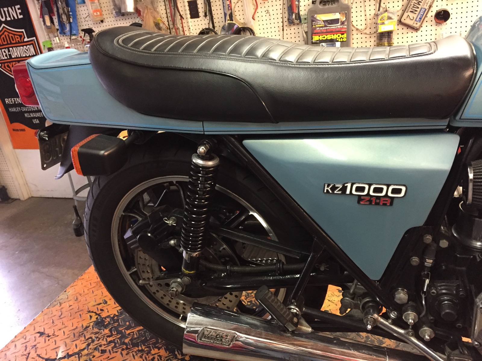

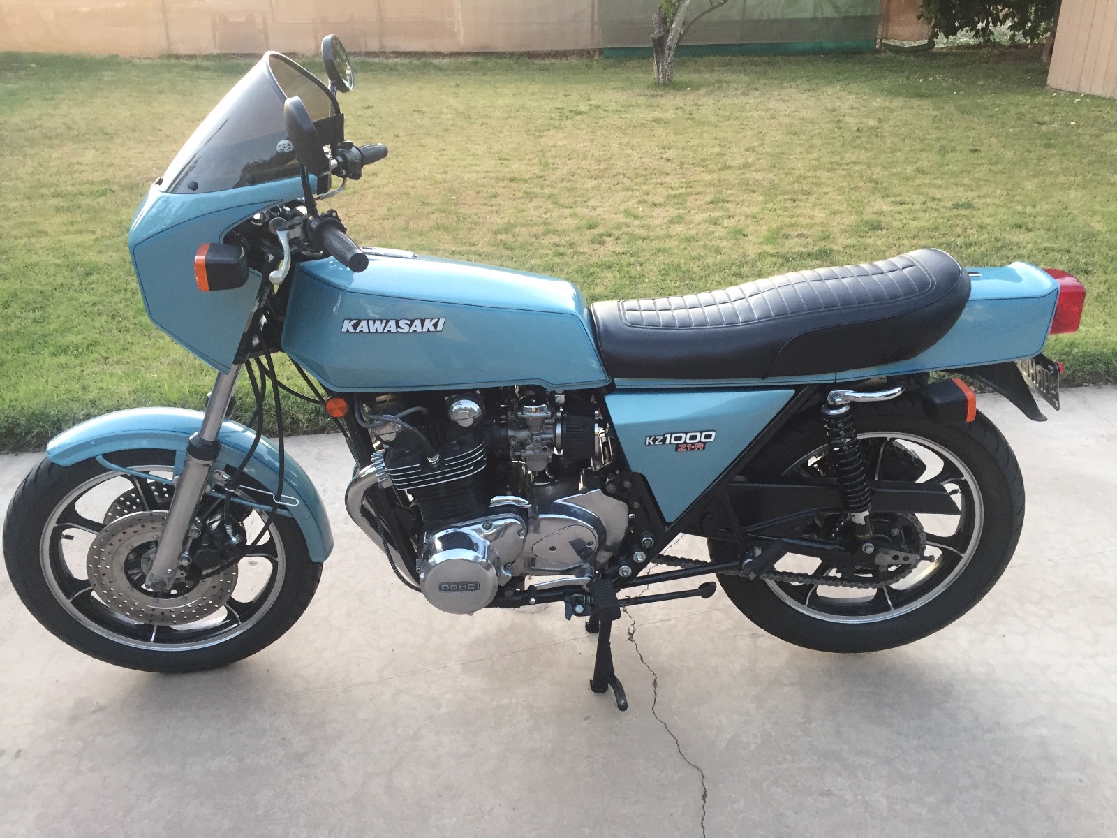

Just to post a few pics and share info about the paint color ( I thought) matched Stardust Silver Metallic. See pics for the formula. After I was mostly done, a friend found an original piece of his Z. Comparing them, his looked more silver, but I like mine better, it's close, but richer in color.
Instead of buying decals, I used pinstripe tape, substituting dark blue metallic for black, and ocean blue for whatever they called the lighter blue. I didn't get thru the jobe without a couple flaws, but I'm pleased overall, and I saved a lot of $ over having a pro do it.

Looks great! Be proud!
How did you like the Wanda paint? I've never tried it but I did work with some Sikkens (same parent company as Wanda) folks back when they were trying to enter the aftermarket paint supply market in North America. I was working for a Japanese OEM auto company and the Sikkens guys were developing formulas and comparing them to our vehicles at the port. I was amazed by their keen eye. They would hold up a chip to a vehicle and proclaim it "too blue"..or green...or dark,,,or muddy...wtf? I was flumoxed but learned a lot during that project. Another interesting tidbit is that as an OEM we had to send color chip samples to the FBI each year. Apparently they kept a full set of paint chips for every OEM car company, which came in handy I'm told when investigating hit and runs.

Thanks, Ed. I liked the Wanda just fine. That part of the job was flawless. The metallic laid out perfectly. Using the infamous $10 purple paint gun. No fisheye eliminator needed. I'm sure the Sikkens guys would pronounce my color too green, but my eyes like it. I hope to park it next to an original Z1R someday to see
the difference

Keep in mind that the original painted parts have had the better part of four decades to fade. I'd bet that if we could time travel back with the most perfect part we could find, that the forty year old paint would not exactly match a month old bike.
What you have looks terrific, and might be exactly how a brand new one looked.

Good thinking there. You would need a time machine to verify a "perfect match". We can only speculate.
Appreciate the compliments from all.
