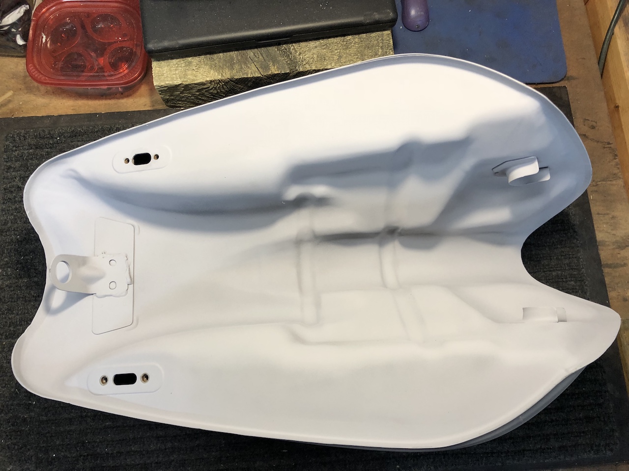

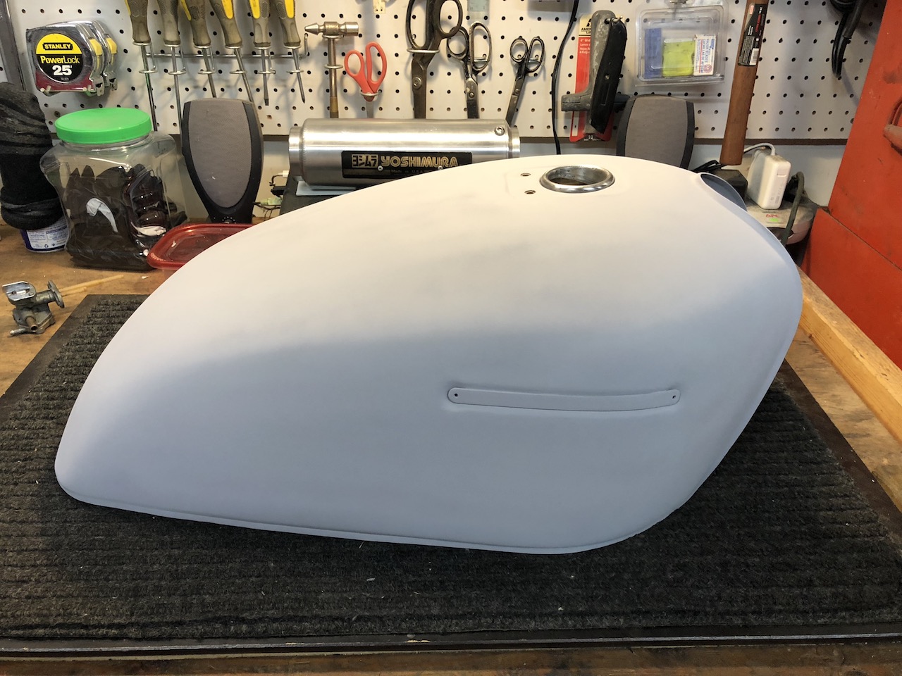

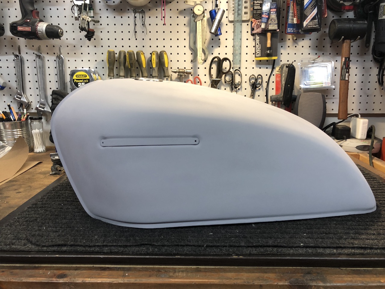

I stripped off the botched paint job all the way down to bare metal to find absolutely no dents or bondo. But whom ever painted the tank before I bought the bike used an aggressive flap wheel to sand the factory paint off and left deep sanding marks all over the tank. So I gave it a coat of metal etching primer and a single coat of filler primer that totally covered all but the deepest of scratches. It needs a lot more sanding and primer, but we have already gotten snow flurries up here, so my garage is too cold to apply more primer to get it perfect.

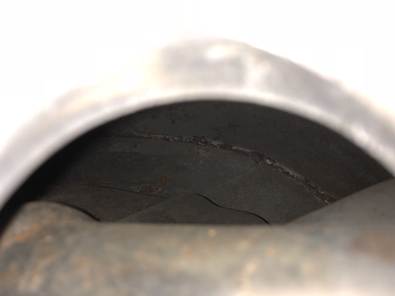

The inside is full of 30+ years of gas shmutz but no serious rust spots of any kind and the paint never showed signs of pinhole leaks.
It does come with the fuel level sensor and petcock, but both need new gaskets to be leak free. The gas cap is also included.
