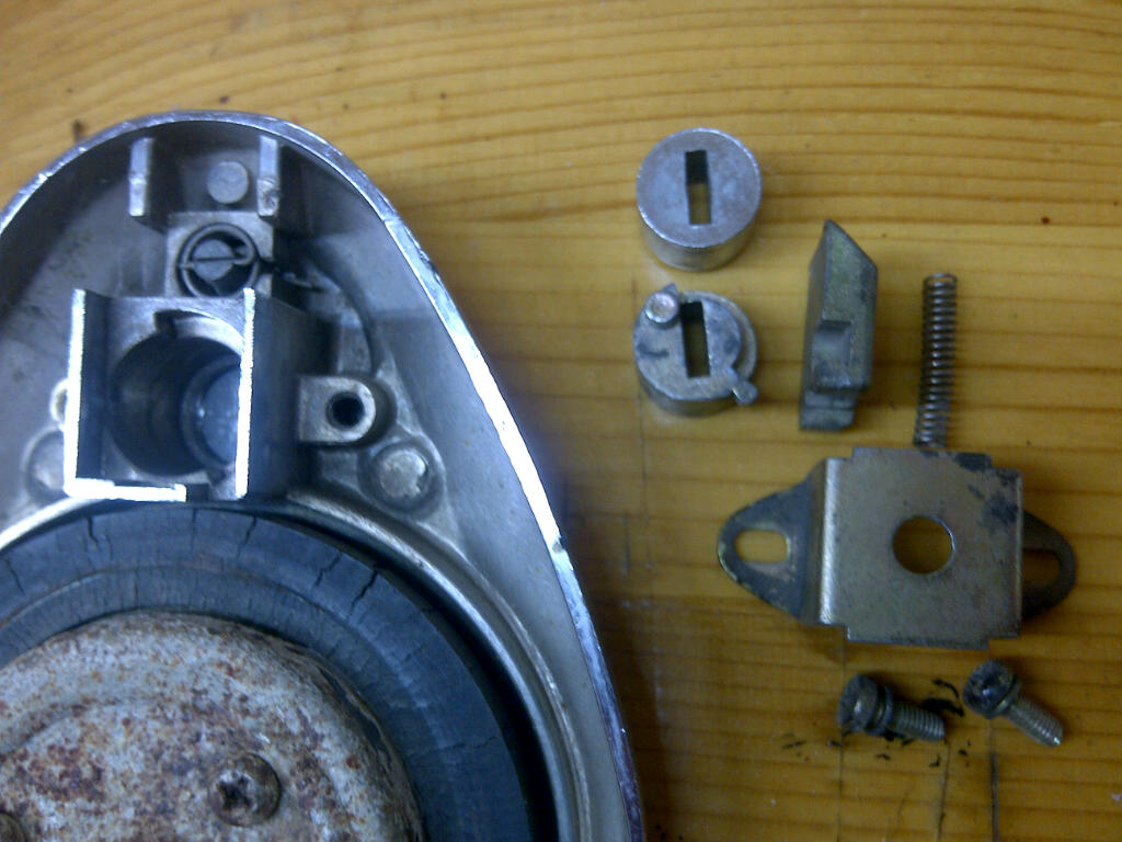

Re: tank without key
13 Jul 2018 13:55
ONLY A FEW PARTS IN THERE TO GET MESSED UP.
This one had the walls on the cap body that the latch rides against pinching the latch, so it would not slide.
