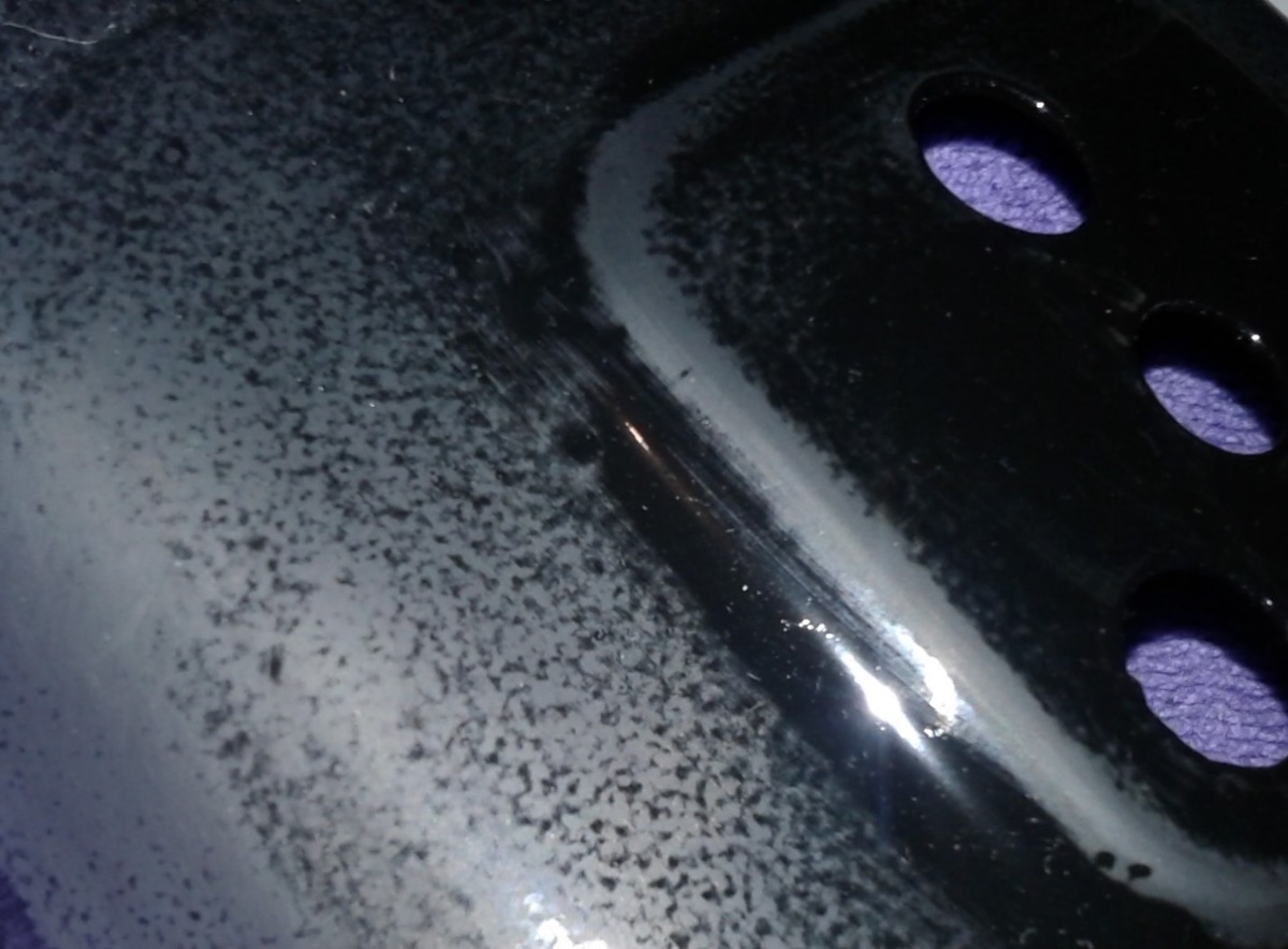

Clarification please...should this be sanded till no orange peel before clear??

Read where peeps have said not to sand till orange peel gone, ...so, I know the rear fender shown is not ready for clear BUT if I shot this with clear, would I see the orange peel through the clear??? Please clarify. Thanks!!!

The smoother the surface the less chance you have of orange peel showing through. Don't sand so much that you cut through the color down to the primer though.
And it goes without saying that how well your clear lays down has a lot to do with your materials and skill. Wet coats will bury imperfections in the substrate but you walk a tightrope between getting runs. Also, if you plan to sand and polish the clear you can live with some orange peel too so there is less to worry about in that case.

Did you spray the black? if base coat? you don't sand base. If single stage urethane, non-metalic, you can sand it. But being that back fender, limited veiw? I would just clear it. Then you could wet sand and buff the clear.You need to be a Chemist nowadays, with all the types of product out there!

Yes, it's a gloss black base. I'd shot my base coat in 2 coats at this point, ...I walked away for 5 mins and them damned kids were horse playing (Argh!!) getting all that dust airborne!!! Needless to say, NOW that everyone has been WELL informed to stay clear from my entire work area when I'm painting, I'm prolly gonna sand good n smooth, then shoot 2 more coats of base, then a couple coats of 2K Spraymax Clear, ..allowing a good week to cure before adding my pinstripes, once pinstripes are on, allow a good 4 days to gas out, QUESTION: After this 4 days of gassing pinstripes, do I then need to scotch-bright to crack surface before spraying clear over pinstripes? Then 2 or 3 more coats of 2K clear. Then, after a solid week, buff and wax to desired shine. I'm getting excited about this.
