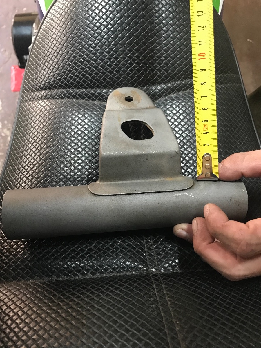

The head light attaches to the bracket via the forks (fork ear bracket what I call them). These are rather hard to find, the GPZ headlight bracket doesn’t work on the Lawson but the B2 does, You can use any headlight from GPZ B models and they are not hard to find, I must have around 13 of those headlights but I am in South Africa (unfortunately). I will take a photo of a custom bracket someone had on a bike I bought but removed it as I found the original part.
