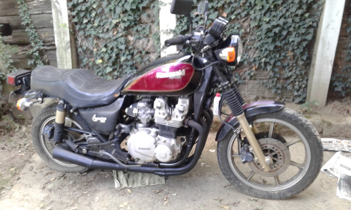

Thanks!! But I got a pretty decent pic of my bikes tank, I've owned it for nearly 15 yrs now. I bought this bike as I trying to get over the loss of my 1982 GPZ 1100 that had been stolen from me and wrecked.
The Spectre photos are a "Before" pic......the "After" pics will be forthcoming.
Low budget on this one, ...rattlecan painting
