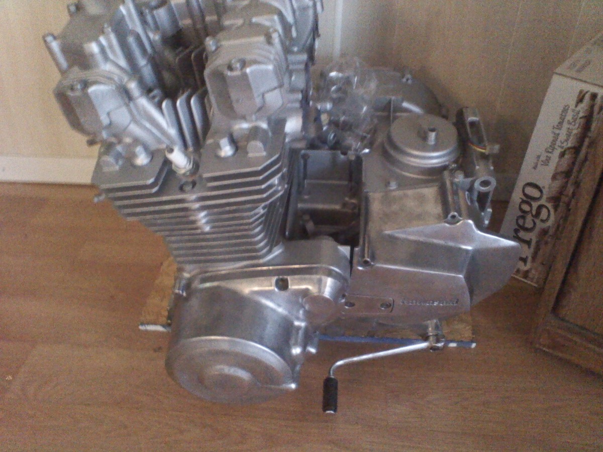

I don't know the original engine paint, but I have been using the (500 degree) high temp aluminum engine paint. It does seem to match pretty close, but I did notice that after a few years, is does seem to discolor towards yellowing tint.. ( the best description I can think of). The 2000 degree paint is too "powdery" and dull for my taste.

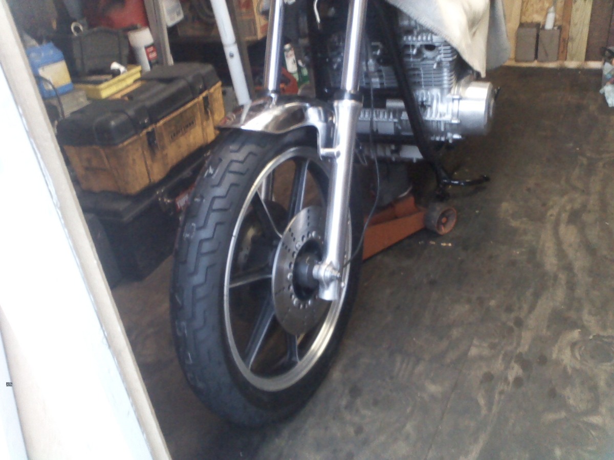

My forks were horrific when I restored Kz1000 #2, so I stripped off the original clear, wet sanded with 600 grit, then polished them on my bench polisher. They looked oh so good with no coating.. but I wanted to keep them looking good, so I used the polyurethane wheel clear on them. It dulled the finish a bit, but after 3 years of neglect they still look great.
The motor cleaned up sitting in my LR, next to the TV, right where it belings.
The front forks during bike assembly. I thought I had some pics of them up close, but I can't find it.
