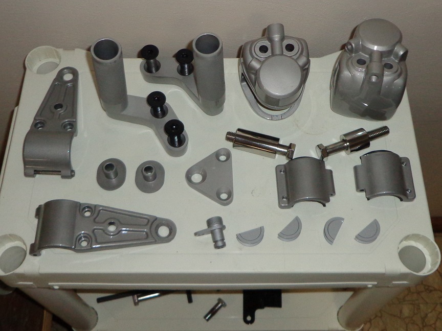

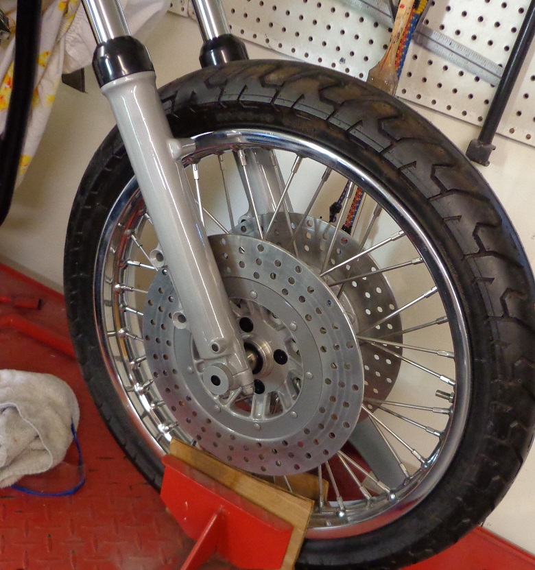

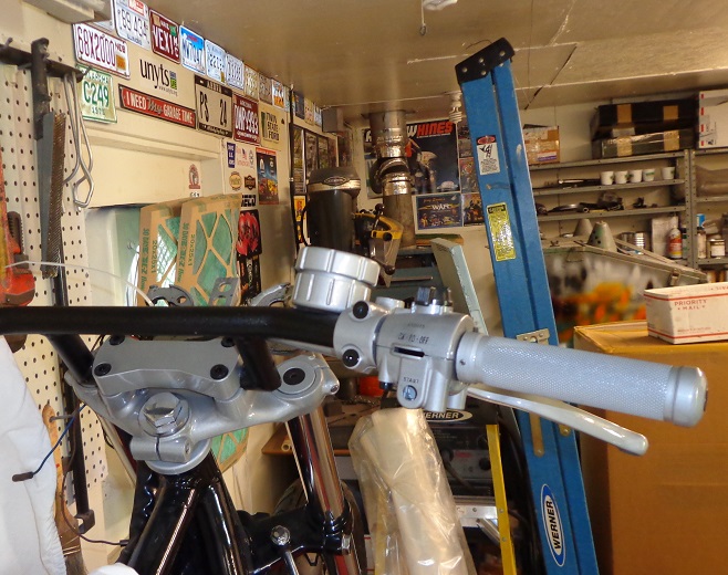

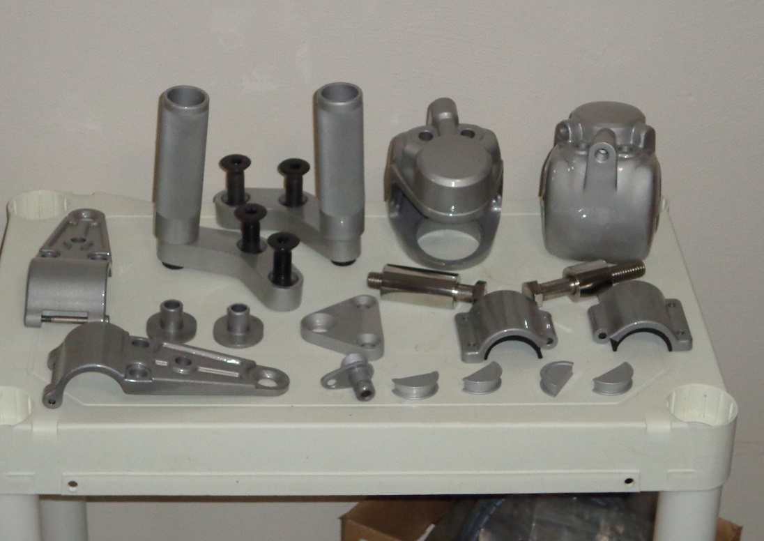

Been doing it for 20 years! Cheap powder coating! Back when PWDer started! I did it all the time! fresh glass bead! wash with hot soapy water, dry it with hand held propane flame! Spray it down with lacquer thinner! then Clear It! Simple and easy for me!
Here is a few pics of stuff cleared!
