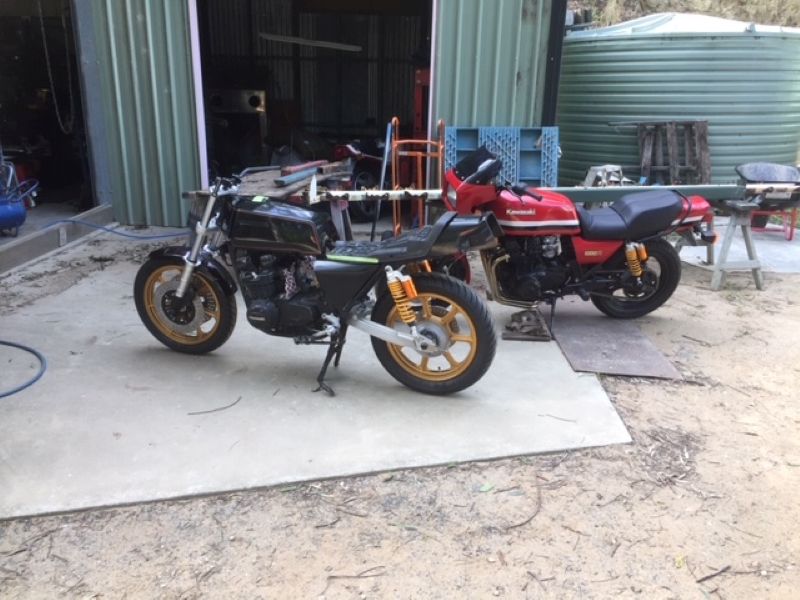

If it helps, I've just fitted a 80 750/1000 ducktail onto an 82 gpz frame and I have to fabricate every mount, and even change the seat lock, also cutting some off the rear of the frame and making a new rear section, It was quite a big job.... Not to sure with the older 900 style but I doubt it will go on without some modification.. Its now the Black bike in the 2nd picture
It was a lot of fiddly work..
