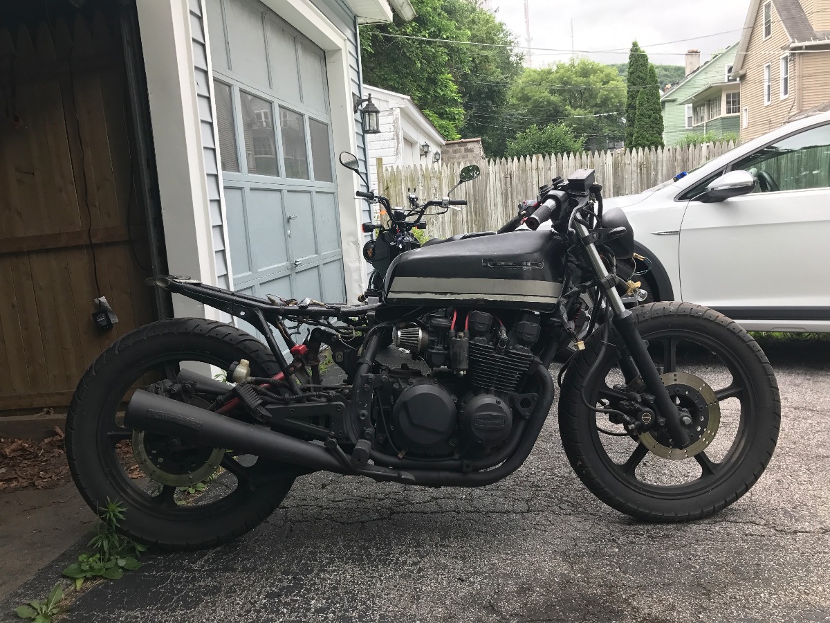

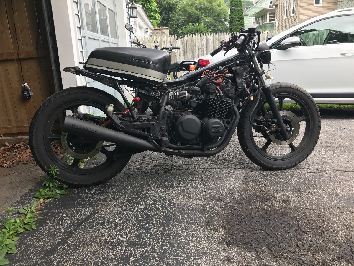

got an 82 tank (coffin shaped, no curvy turn down part) and it does fit. A few wires seem to be in the way (coil packs maybe too) for a dead on perfect fit but it does go on and look nice.
What does the 81/82 look like with the tank off? any differences in the front of the frame I should be aware of?
also... Check it out!
so JFarhanbod on here and DTT forums had an 84 he slapped this gen tank on. Mine is an 83 so the brackets that hold the ignition coil packs are slightly in the way. I whacked them down with a BFHammer and am gonna grind them off and remount the coils, or possibly update to newer more compact ignition coils and a new ignition system for mo' powa? Dunno yet.
I'm debating on keeping the wiring harness of hack and chop it to bits and somehow tuck the harness into the frame tube.
the tank does fit nicely though, but it's going to be even more work to get the bits and pieces tucked into an accessory tray under the seat pan.
I've got stuff to rebuild the stock susp, but I'm considering doing a gsxr front end over the winter here in upstate NY.
I need to either borrow a welder, or get someone experienced to do that rear hoop. That's a current hold up.
for reference, though, it's a 1982 KZ550 tank. Found it from an auction in california. no rust cancer. The inside is clean just a teeny bit of superficial rust. Gonna POR coat the tank on the inside once I clean it out nice and good.

Thats an 81 tank . Same as the two above . The one in the bottom pic is a 81 too even though they say in the add that its an 82 .
Looks good on there though . Frames different on the 81 They had shocks instead of mono shock .

That tank does look good on that frame. It seems to slope forward a bit which looks nice. This might leave a few extra ounces of gas in the tank when you are low so watch the reserve closely... get gas sooner rather than later.
The Kz550A standard tanks, and the 81 Kz550D Gpz tanks look to be the same on the outside, but they are not all the same underneath. In addition to some having the fuel gauge sender, some of them, including the gpz tank, have more clearance for coils underneath. The sheet metal has two larger arches molded in. The earliest ones don't seem to always have that. They will all clear the coils, but I think they added more room for air to get to the coils. I don't think it will matter for you, as even the ones with more clearance probably would still require moving the coils or using smaller coils.
As a side note, the early ones without the extra clearance probably hold more fuel.
Good luck on the build.
