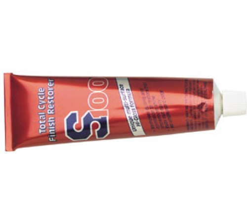

I’ve owned my 1977 KZ650-C1 since it was new. A couple years ago I noticed the tailpiece had developed very minor hairline cracks on the surface. I used CS-100 Cycle Restorer on a soft cloth to gently polish them out, and I was very pleased with the results. It is a very gentle polish. The paint on my bike is all original, and it has the original clear coat on it. I don’t know if your model has clear coat or how well S-100 will work on your paint. If you decide to try it I recommend you first do a small spot that doesn’t show in case you’re not happy with the result. It also works extremely well on the engine side covers, cylinder head, etc., so if you decide not to use it on the paint it won’t be wasted. You can buy it on Amazon, eBay, and lots of cycle shops. It comes in a tube; below is an image of it.

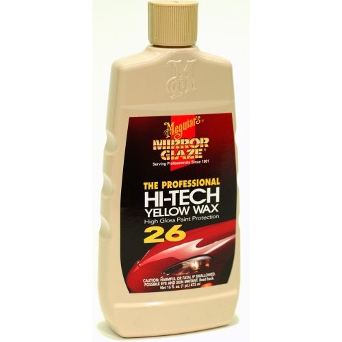

When I finished polishing the paint I waxed it using Meguiar’s #26 yellow wax to protect it. Ed
