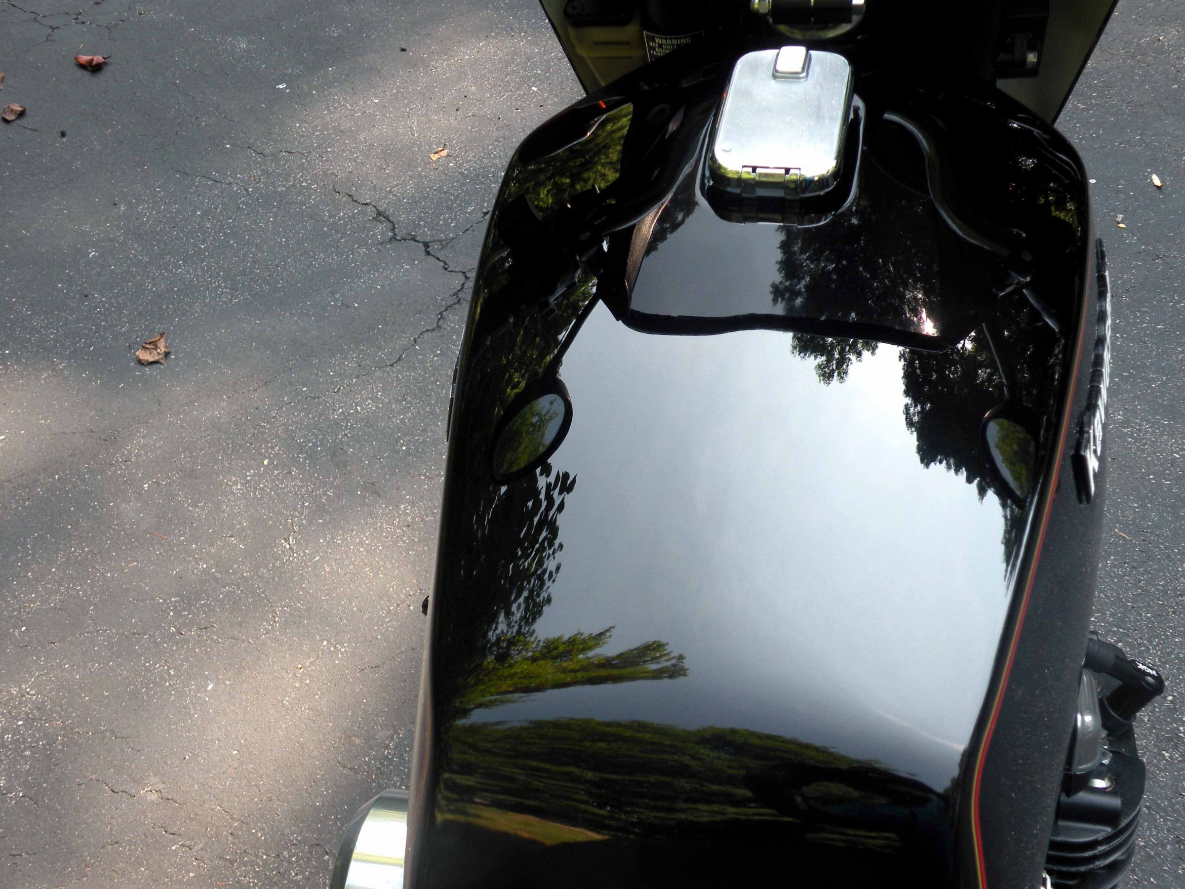

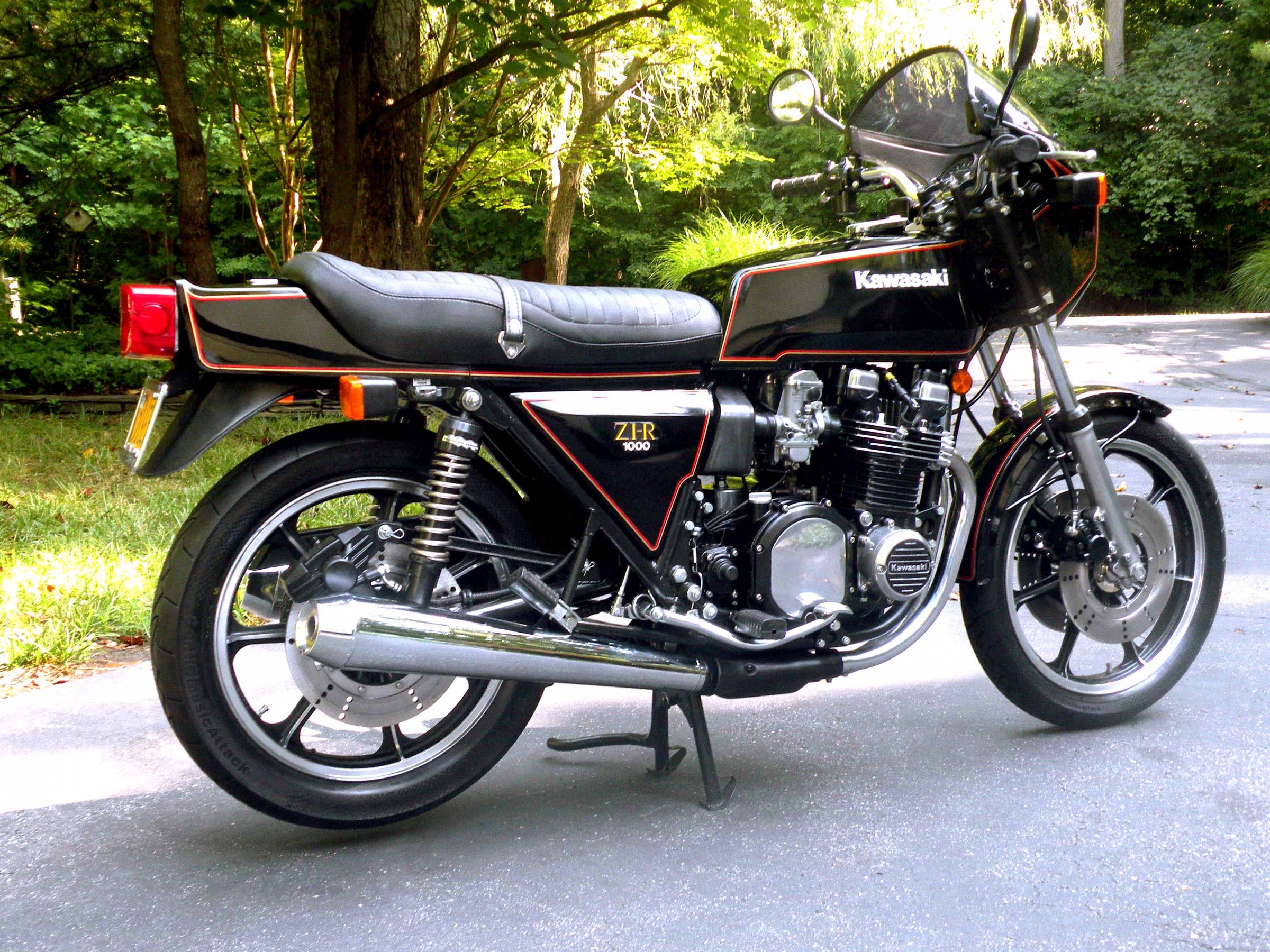

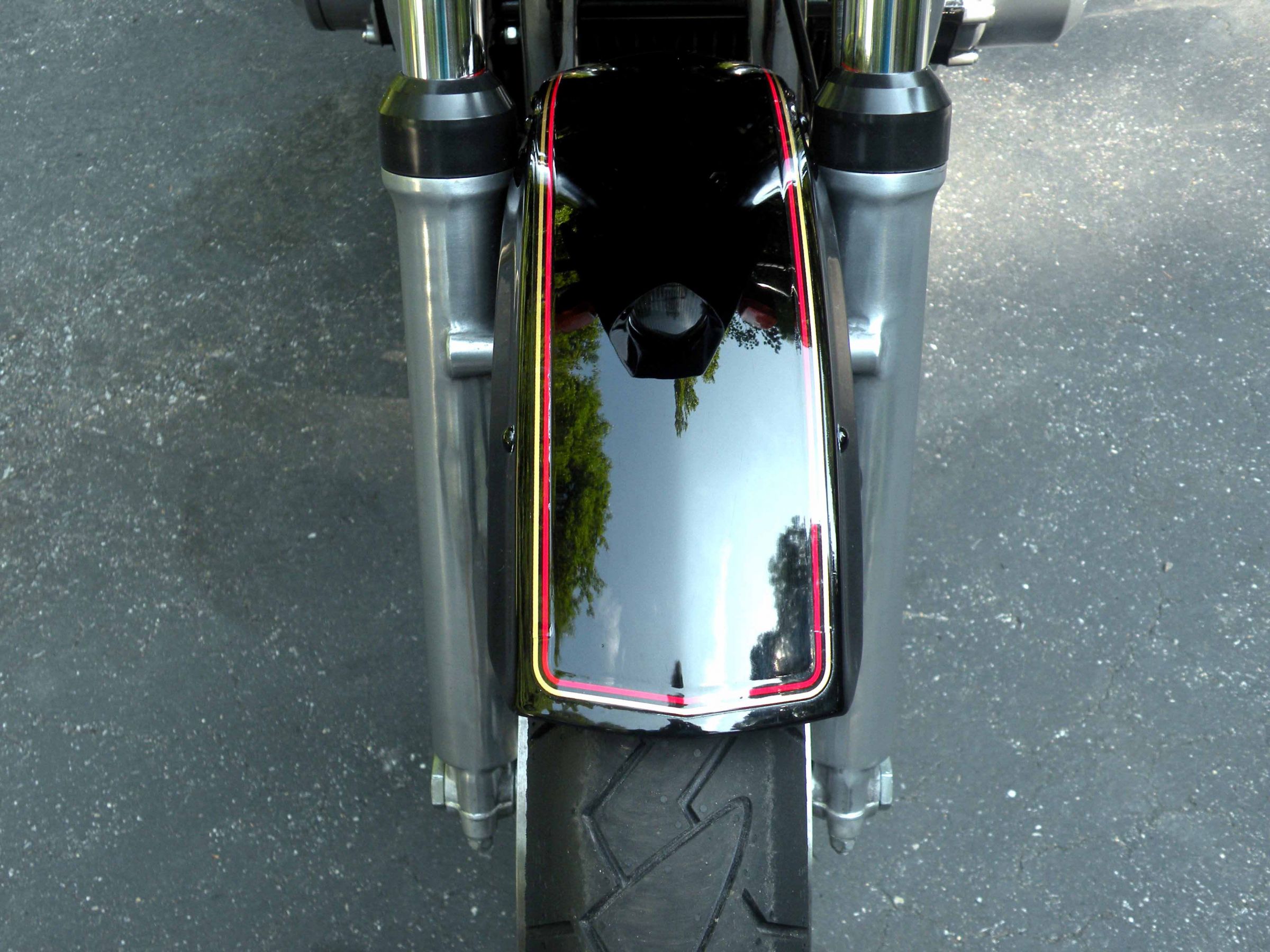

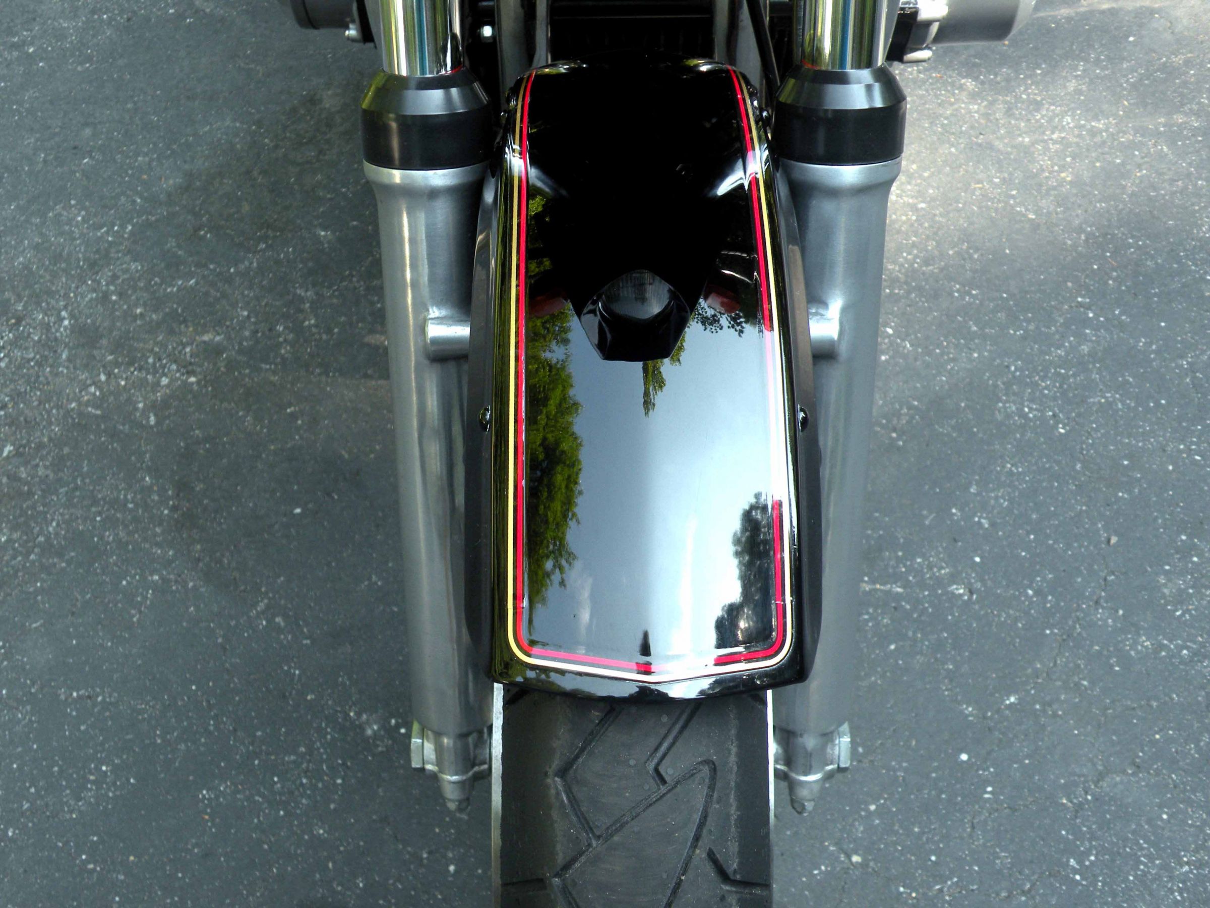

Here's my 80 Z1R I painted last year. It was done in my driveway using an EZ-up canopy for my Spray booth . I used the $9.95 HF purple spray gun for the primer/base coat and upgraded to the $30 HF gun for the clear (smaller tip with better atomization). I used all House of Kolor paints. I used a original factory replica pin strip kit and applied clear over it.

I have read everyone's reply with great interest. I don't ever plan on painting another fuel tank after I get this one painted. I see no need to buy a spray gun, a bigger air compressor, and then build a spray booth. Its just not going to happen. I live in a small rented house. My landlord and I have a great relationship even with all my bikes and parts filling up the garage. He can see that I run a super clean shop. The garage floor is still spotless, no oil stains or other mess at any time out there. I am NOT going to take the chance of blowing the relationship I have with my landlord by building a spray booth in this house. He just happens to live next door to me too!!
I cannot believe how great MDZ1rider's Z1r paint job looks!!! Thats the kind of finished job I am looking for. I might just have to live with the dents if I can't find someone to paint my tank. I already ordered a pin stripe kit from Diablo Cycle up in Canada. Thats the only place I could find that offered a stripe kit for the '80 MK II paint job.
That finish is better looking than any stock paint job I have ever seen!!!! Its better than perfect in my book.

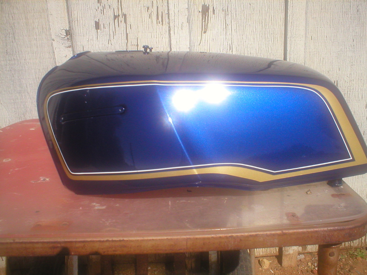

The gentleman that is painting my MK II tank just sent me a photo of his finished work. Here is the tank just out of his paint booth.

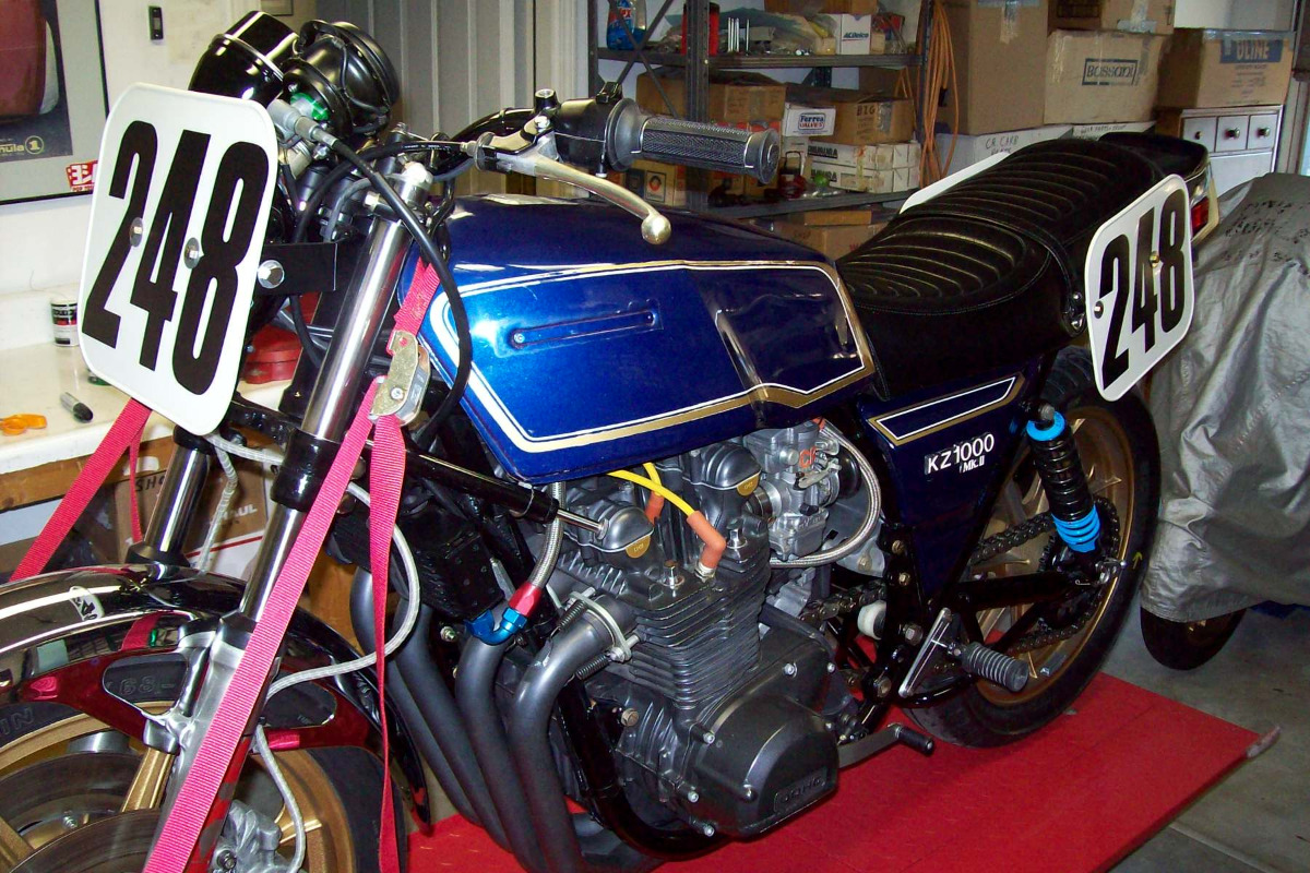

Here is a factory painted tank I dug out just to see what my MK II would look like in all blue paint again!!!
Can't wait to see my newly painted tank in person. Just have to wait till it cures for awhile before he wants to ship it to me.
