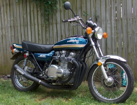

I have the same body set on my 75. The tank edges chip rather easily so be careful when mounting or removing the tank.
