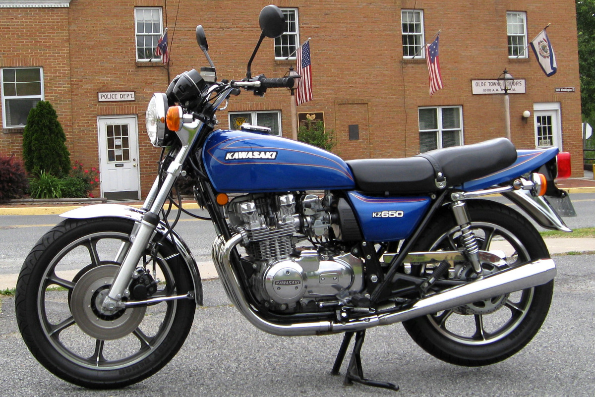

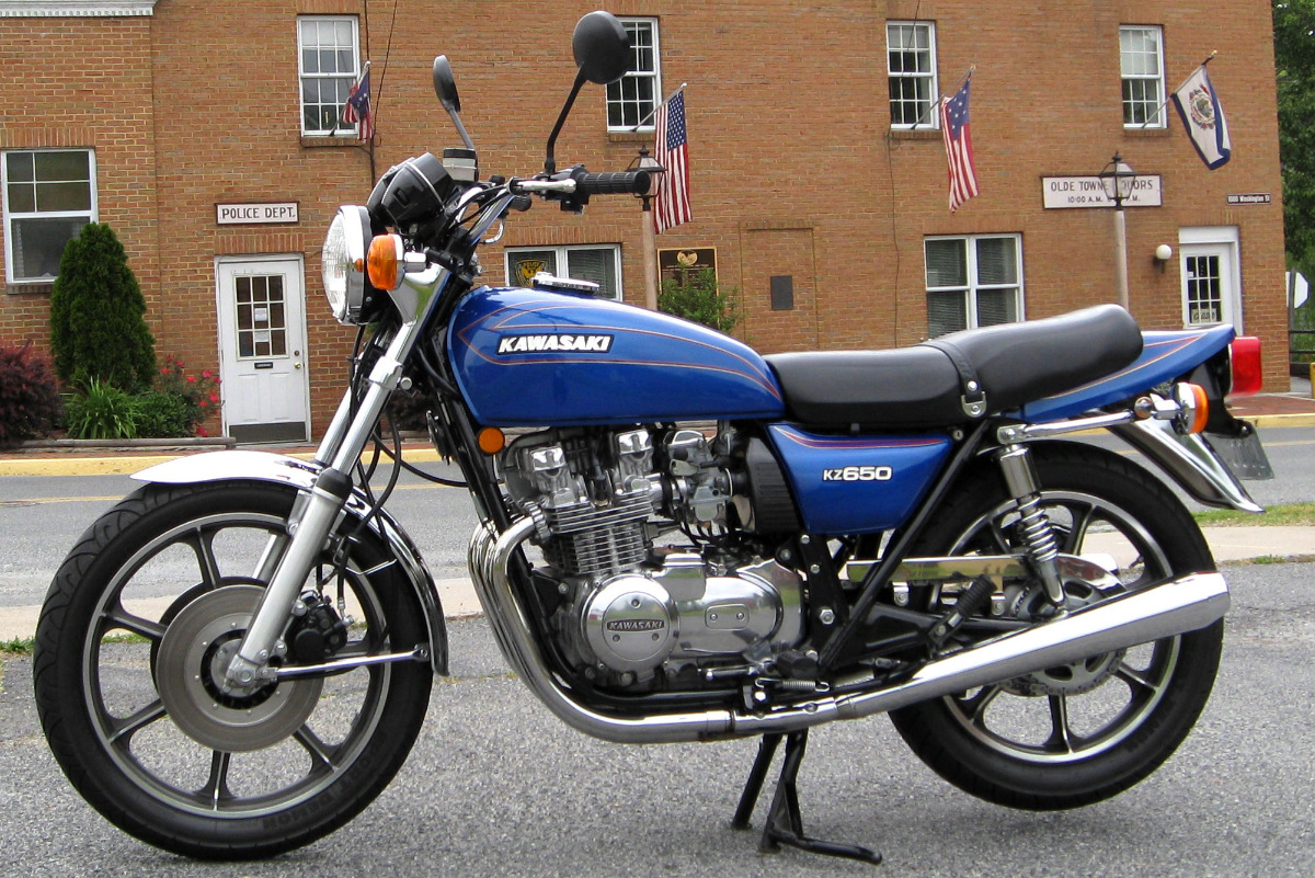

Re: 1979 KZ650 Bobber Help!
07 Nov 2016 14:38 - 07 Nov 2016 14:39
Last edit: 07 Nov 2016 14:39 by 650ed.
- Posts: 7993
- Thanks: 1648
07 Nov 2016 15:25 - 07 Nov 2016 15:25
Is that your bike or just a C-model example? very nice.
Last edit: 07 Nov 2016 15:25 by martin_csr.
07 Nov 2016 15:30
That's my bike.
