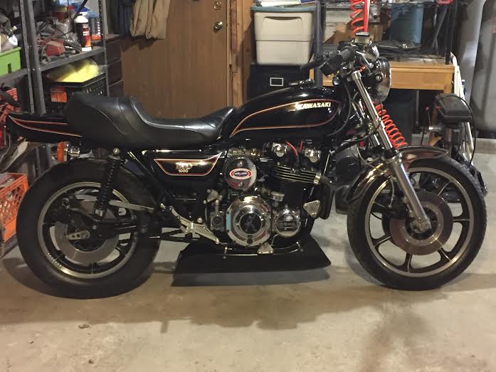

07 May 2016 17:17 - 07 May 2016 17:18Street Fighter LTD wrote: 78 LTD Just a thought
Dave![]()
That’s exactly the graphic I was thinking of, but my tank is a different size and shape, I wonder if it would look right. I would guess the side covers and tail are the same?

08 May 2016 03:35Mine is just a standard 900 tank. Those graphics are for an LTD tank. They are a different size and shape; but It might look okay.Patton wrote: Pic?
But I think I could do the same thing with Red/Grey Duo tone pin striping tape, as long as I can shoot clear over the tape.

These photos show a tank I did. Shot the base coat and a couple layers of clear, then waited a couple of days and rubbed the tank down with gray scotchbrite before applying common peel and stick pinstripe tape. Last step was a couple more layers of clear of course. Easy job, just a little fiddly to get the stripes even from right to left.
