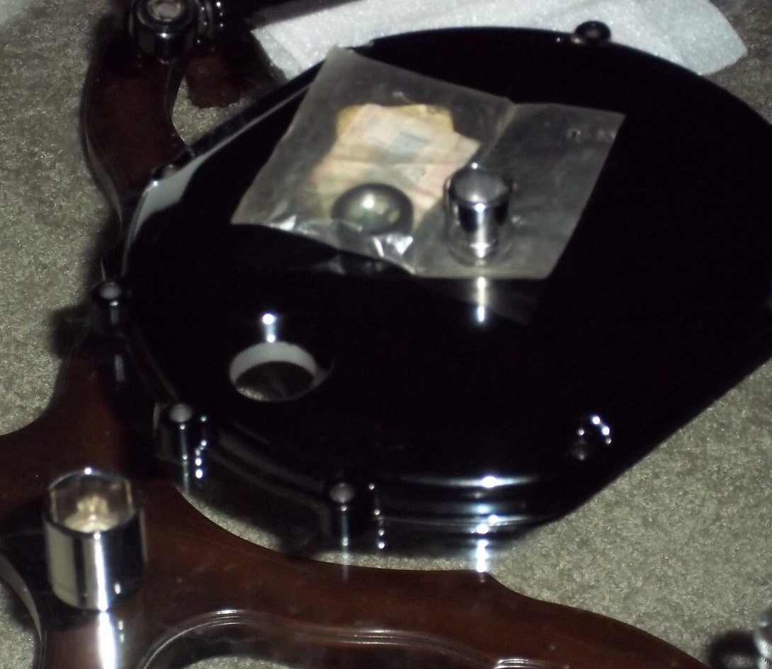

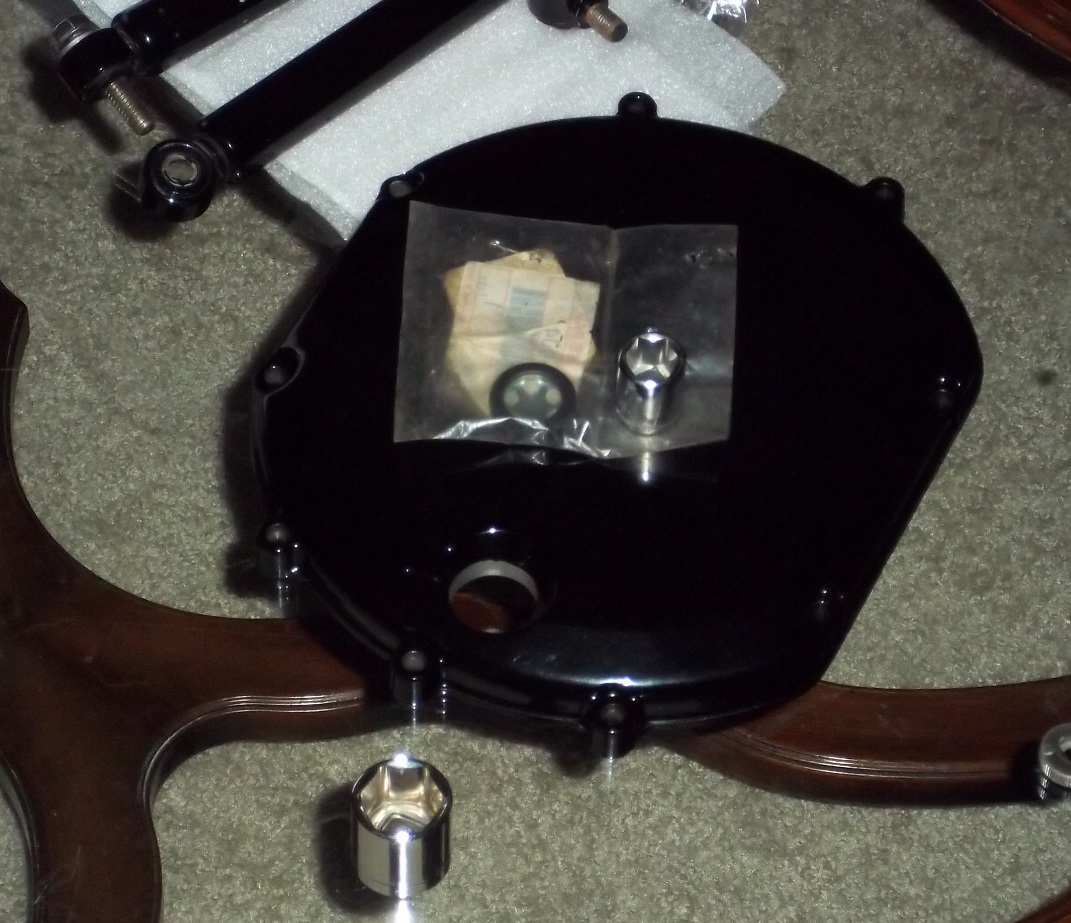

Hi Davi, You can take 2 sockets. 1 Bigger to catch it, as it pushes out. Then 1 socket just a bit smaller than glass in diameter.
Put them in a vise and just tighten the 2 sockets that are sandwiching the sight glass.
Almost like a hydraulic press. That's how we changed universal car joints when we were Kids.
It has a solid dried up sealer on them. Make sure to lean the surface
And most important if you powdercoat is to tape off the open hole, so it stays nice and clean and fresh aluminum.
I have had these project parts sitting for years, finally doing work with them.
