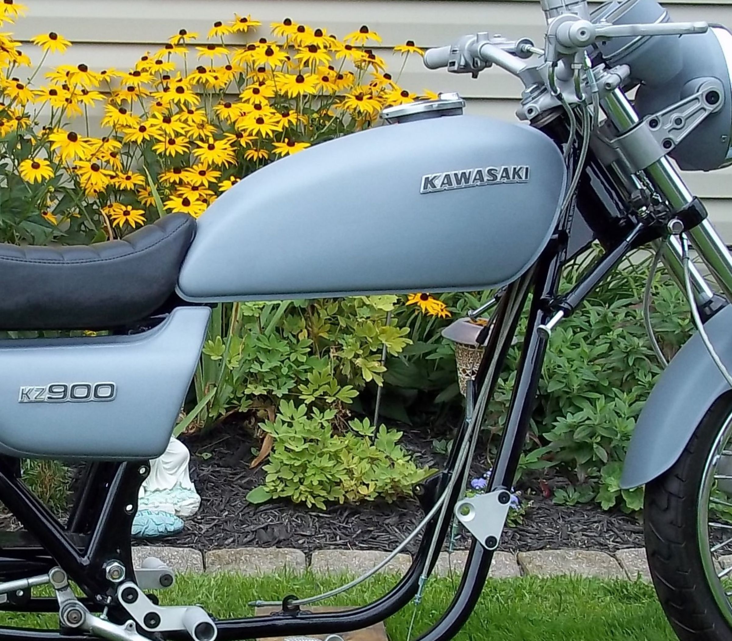

So I am getting close to getting my CAD/CAM files for my custom KZ badges. Then it dawns on me, if I am going to have them CNC'd out of brass stock, my side cover KZ900 badges need to match! So thinking about having the stock rear badges blasted and brass plated so they match. Never had brass plating done, so I am curious if anyone else has done this or had it done before? Tips and tricks? Recommendations on who should do the work?

Are you sure the side cover badges are not plastic? The tank badges are metal, but I'm pretty sure the side cover badges are a plated plastic.

14 Mar 2016 16:44MDZ1rider wrote: Are you sure the side cover badges are not plastic? The tank badges are metal, but I'm pretty sure the side cover badges are a plated plastic.
They are definitely metal.

If your going to wright a program for tank badges? Why not do the sides also. I mean if your using a CNC machine! I don't know if it is goverment job lunch time employee work? Or if you are paying Someone? Go for the Gusto!
And early Z1 and KZ 900 emblems are aluminum! The later KZ1000 are plastic I glass beaded mine, put black paint in and clearcoated to match my simple cheap theme of silver and black.
