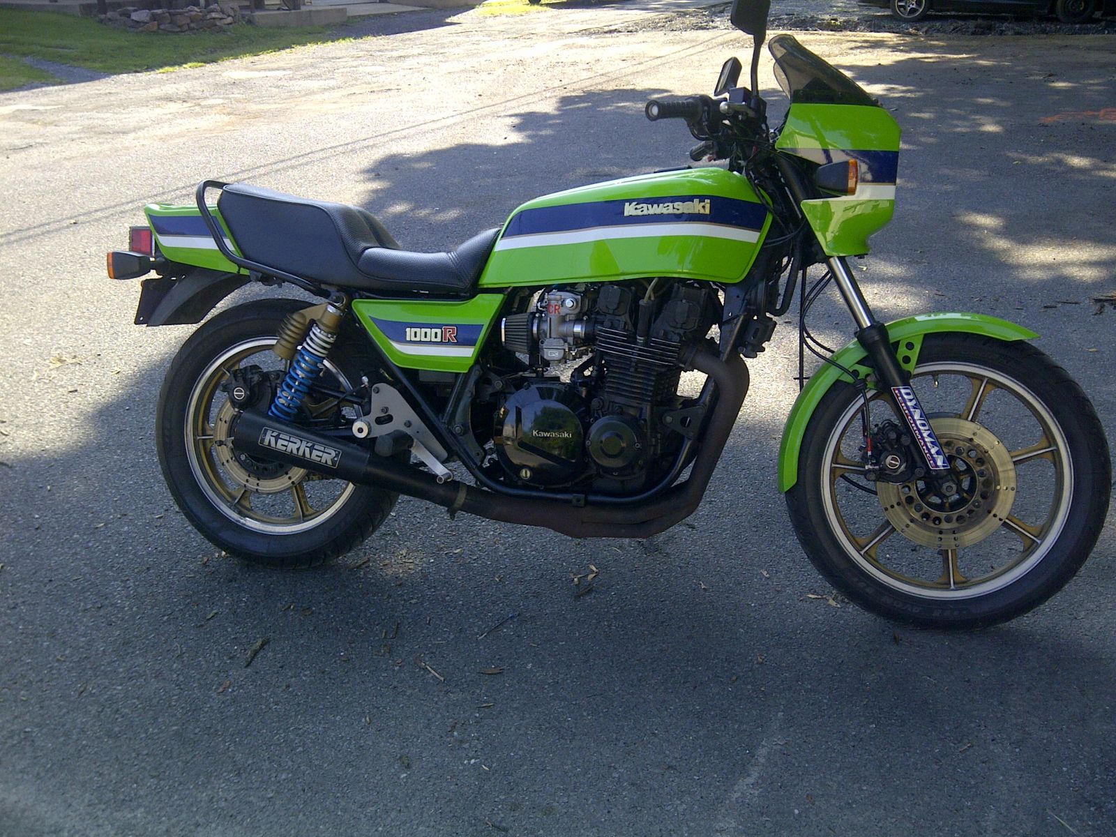

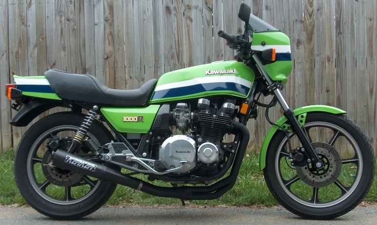

03 Feb 2016 16:11It's not a Z1R. Looks like parts off a lot of different motorcycles to build that bike. Looks like a Z1R tank though. What options you have for an angular tank is a 1978 or 1980 Z1R, 1979 or 1980 KZ1000MKII, or the Eddie Lawson look tank from 1982 or 1983, or a 1981- 1982 GPZ1100 tank that looks identical to the Eddie Lawson. None will be cheap, but GPZ would probably be cheapest. I've never seen a GPZ tank on an older KZ1000 though. Don't know if they fit.obie83 wrote: You guys think the bike in the link is a zr1

04 Feb 2016 03:25 - 04 Feb 2016 04:07What motorcycle do you have? A couple of things to compare is the way the donor tank mounts & also the shape of the upper triple tree. Kawasaki.com. partzilla. eebbaayy photos. If the triple is kinda angled forward like on the 750E, then a larger tank may work; but if it's kinda straight across like my 650-CSR, then the triple may bang against the tank. one possible fix would be to weld a blob of material to the steering stop peg.By obie83: You guys think the bike in the link is a zr1
