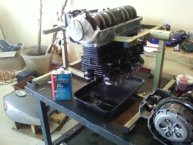

If the original paint is trashed I would use Airplane stripper, you can find it at an auto parts store.
