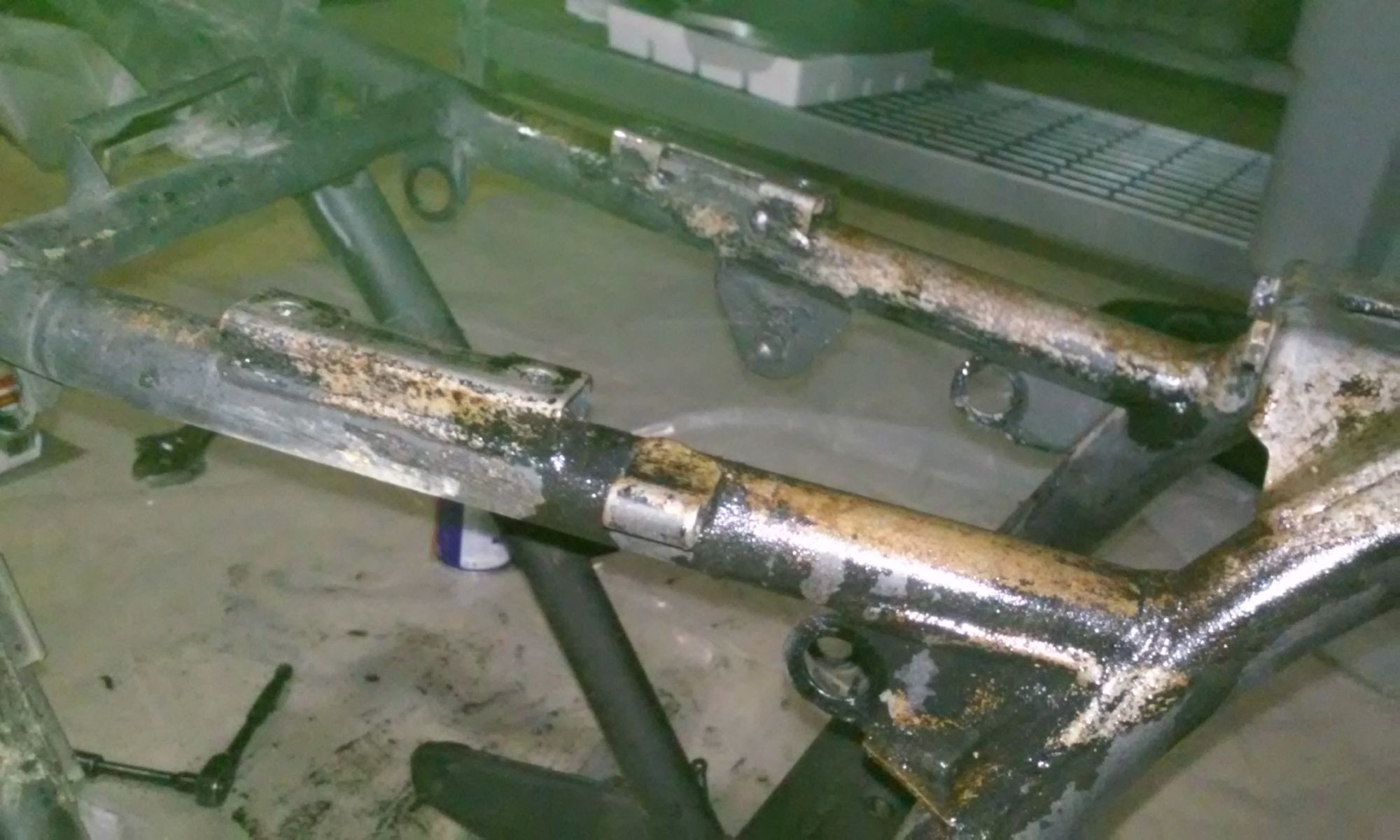

I have the frame in my basement and Im using aircraft stripper to remove the paint I'm noticing very light light rust type spotting on the metal? Also how quick could the frame start rusting without paint on it? Should I do this quickly?

I wouldnt worry about it. Youll need to wash the frame anyway to get rid of all the paint stripper and whatever else. Thatll produce more (flash?) rust but itll come off easy enough when youre preparing for paint.
Though maybe you need to think about paiting somewhere else. If youre inside and getting rust while stripping,it must be damp. Not the best place to paint

Re: preventing frame rust while stripping paint
15 Nov 2015 01:09davido wrote: I wouldnt worry about it. Youll need to wash the frame anyway to get rid of all the paint stripper and whatever else. Thatll produce more (flash?) rust but itll come off easy enough when youre preparing for paint.
Well I moved it to the garage again. Its cold but probably not as much humidity. Since its cold now and we're running the humidifier now inside. I'm thinking of getting a dremel with a brush head to get the paint off quicker the frame paint is really difficult to get off

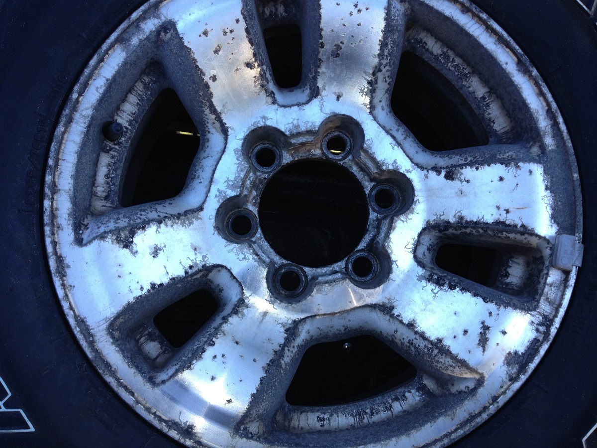

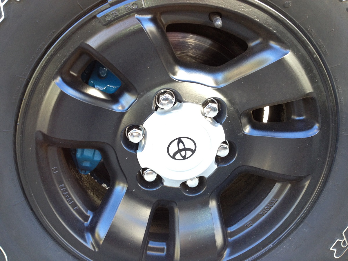

VHT also makes an Epoxy Paint, that is salt & rust resistant, that I used on my pitted & corroded wheels, It's also self priming, so no primer needed
I used a flap wheel in a 1/2 inch drill to get them as smooth as possible, then cleaned with Simple Green then brake cleaner before painting
before
after
Pete
