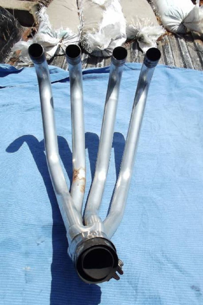

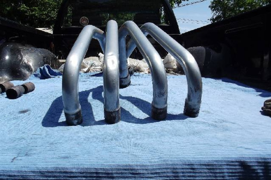

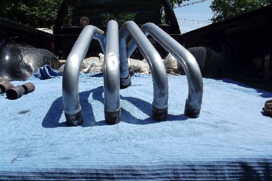

I had this Bassani header pipe powder coated silver about 12 yrs. ago for about 60.00
this is how it still looked last year when I sold it

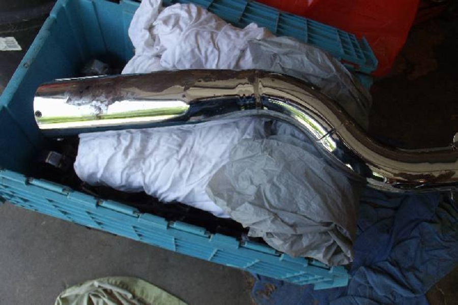

This is the other half of the pipe that I did not have powder coated, chrome peeling away all over, if I would have knew better, I would've had the back part coated too
