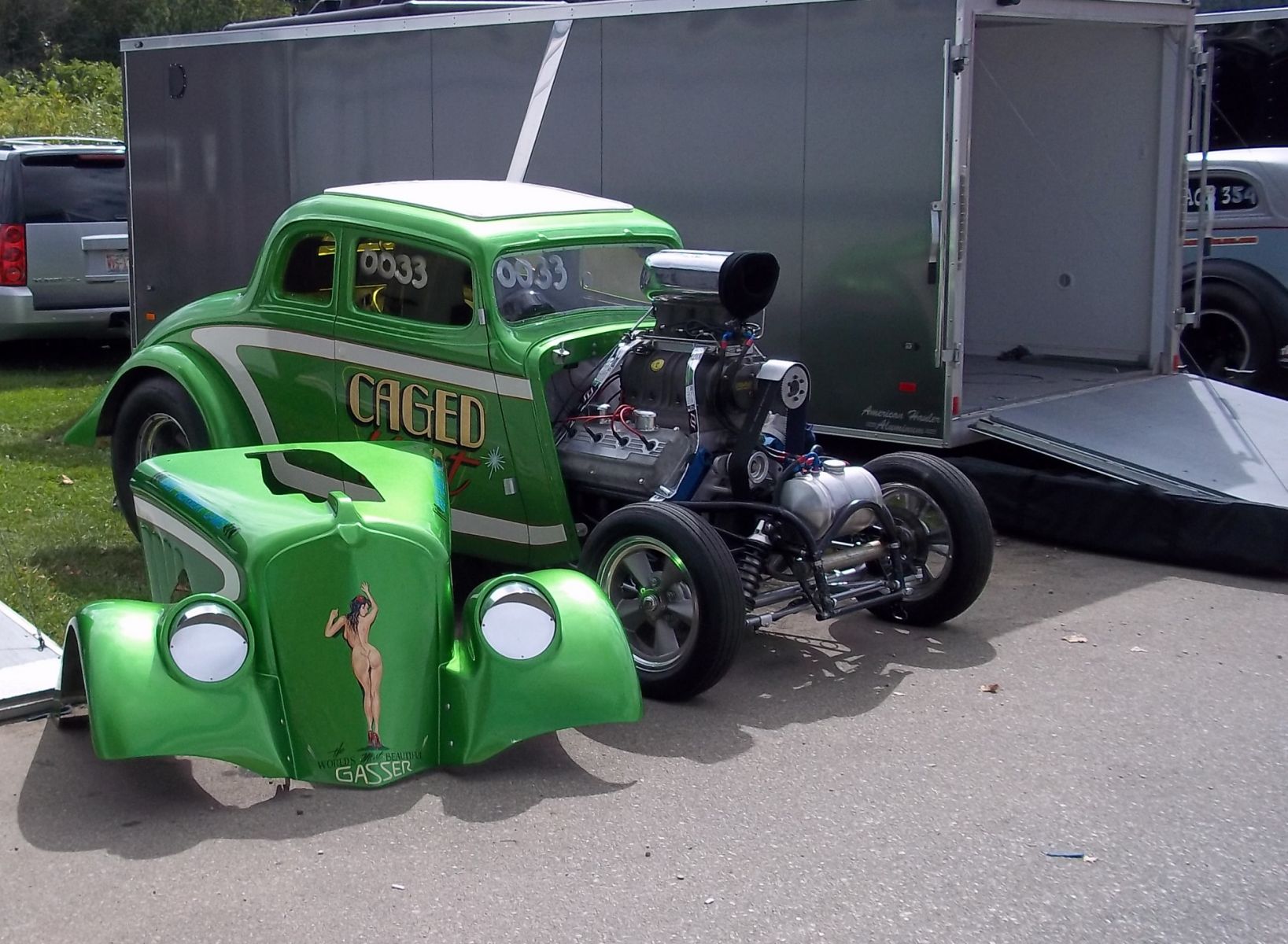

Keystone won't have kawasaki codes. He is looking for a car manufacturer code.
Just look at his chip chart with the greens. He can lighten or darken any green close to what your looking
Last time I used keystone here they were using Valspar base coats. A pint will be plenty. My paint guy will mix a minimum of 4 ounces.
Check out the new Chevy synergy green Painted our gasser last year with it, it was base coat /clear

Is your engine air cooled? I don't see radiator.

18 Nov 2015 03:47No Radiator here, It's cooled with Methanol fuel, 1/8 mile at a time!car5car wrote: Is your engine air cooled? I don't see radiator.
Drag strip only AA/Nostalgia Gasser. Early gen. Hemi 354.
