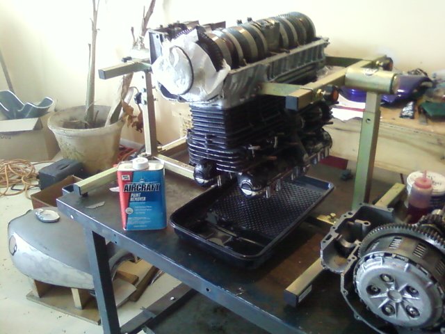

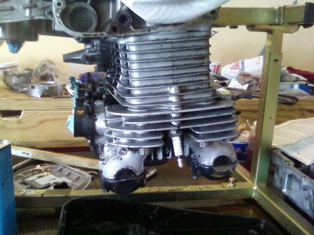

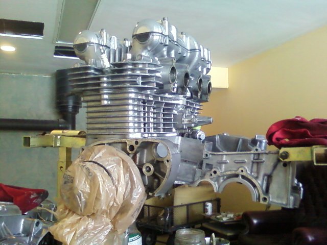

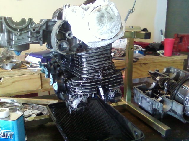

A little late to the party but Klean Stripe Aircraft stripper worked great for me,.
Wear gloves and eye protection, this stuff will burn you.
and do it in a well ventilated area or wear a respirator, or both

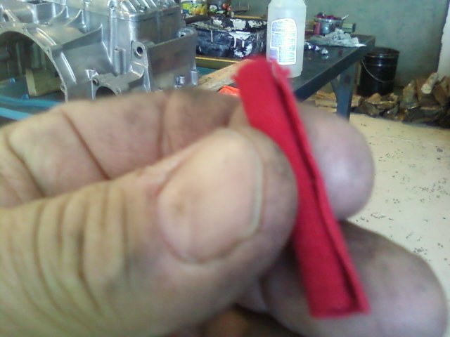

I poured some paint stripper in a small tin container and used a natural bristle paint brush to apply it to an area then almost right away started scrubbing it with a tooth brush, it loosened it up real quick.
Then I use a squirt bottle with warm soapy water to rinse it off into a catch pan.

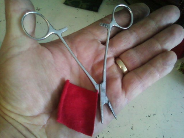

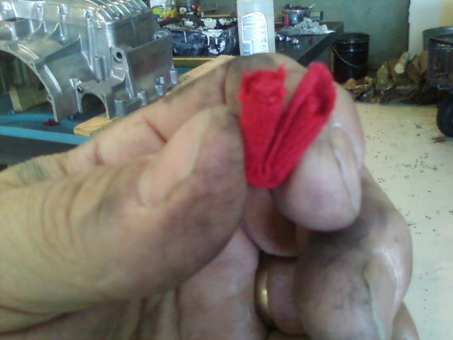

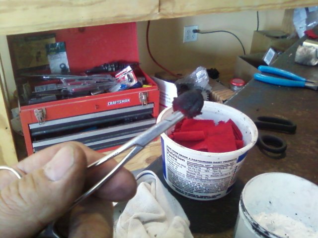

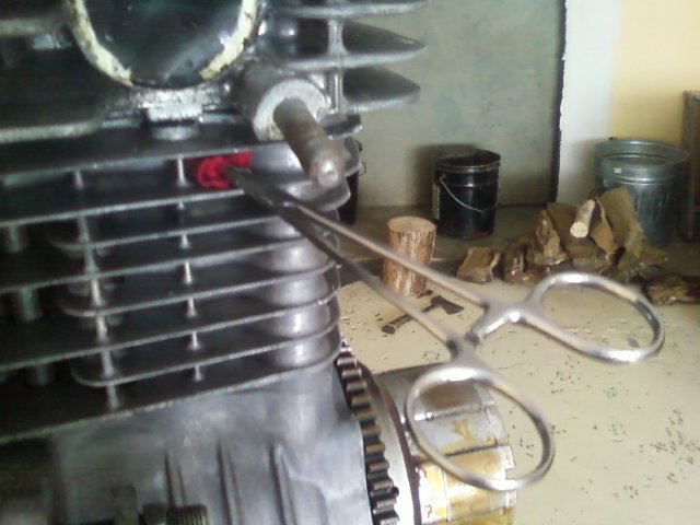

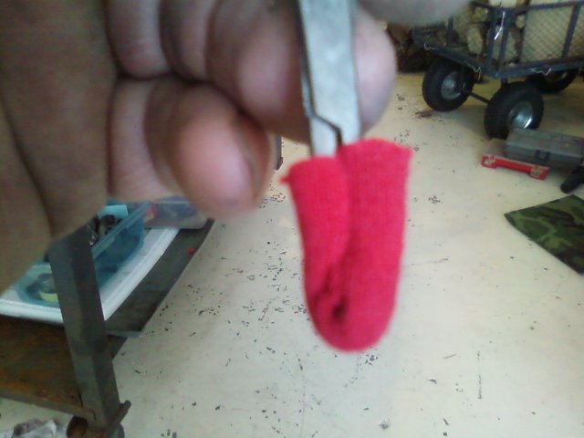

You will still have to dig it out of the nooks and cranny's, I use cut up squares of old cotton tee shirts and a pair of hemostats for that.
I don't paint my engines so I use WD-40 as a solvent for the final cleaning and for protection against oxidation
