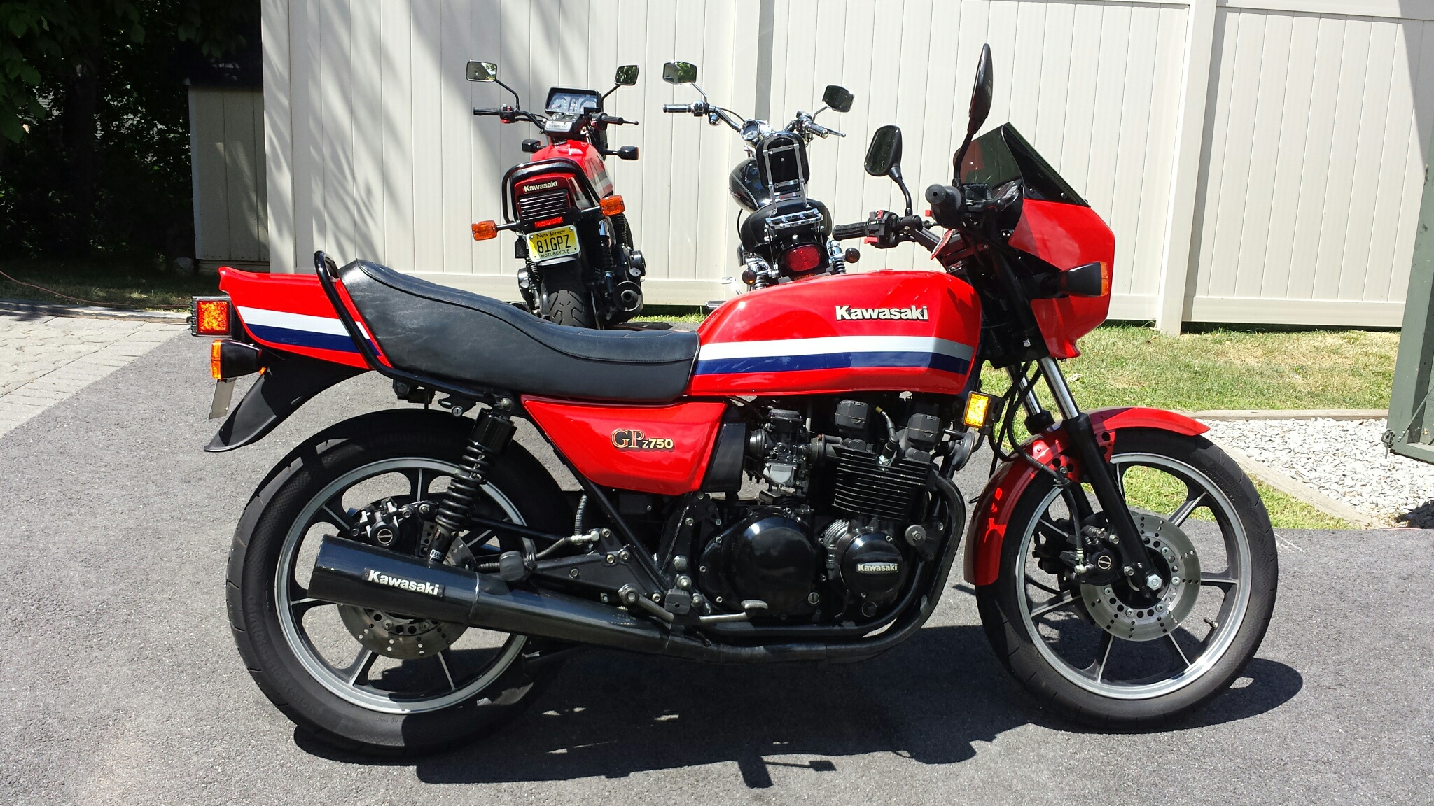

I am having my upper fairing repainted this week, as well as the spare, and would like to know if there is an official color or color code for this particular shade. I am aware there were not color codes for Kawasakis in the 70's but was this the case for '82? All of my searches bring up "firecracker red" but nothing more to really go on than that.

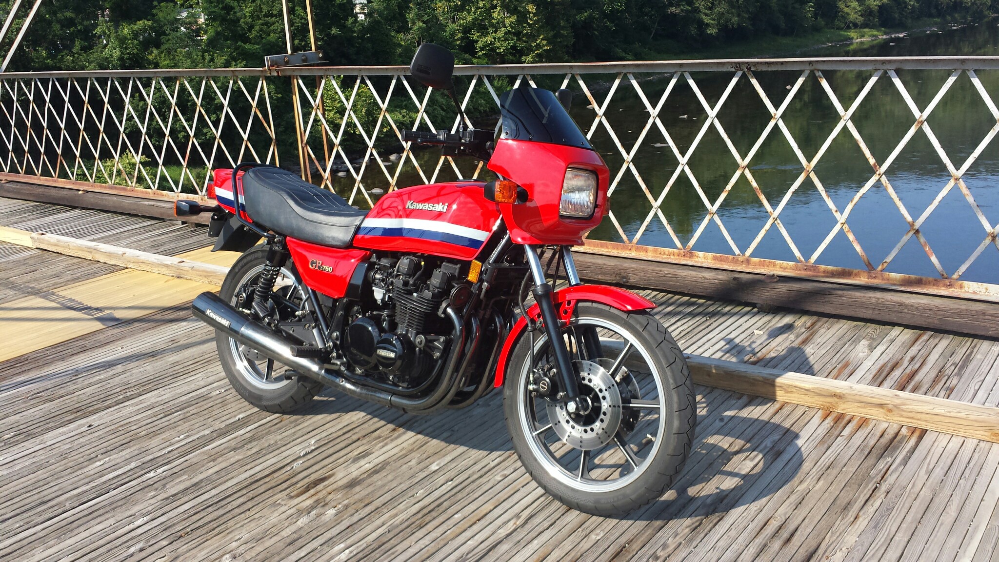

...I had my '82 GPz750 painted a month or so ago. If you like the match, I'll find out from my guy exactly what he used. I'll be out of town starting tomorrow until Tuesday of next week. If you can wait that long, I'll let you know what he used when I get back.

...That's what we did, matched the color to a NOS-OEM front fender.
...Below is the result, with that front fender.

KraZyRIDER wrote:
ThatGPzGuy wrote: If you have a body part with the same color in good shape the paint can be matched at some auto paint stores. Call around...
And that's what I've done at this point. I wanted to save some time by possibly finding a code or a real name that would be accessible to my body guy. I'll call him with the Ford Cardinal Red and see if that helps.
