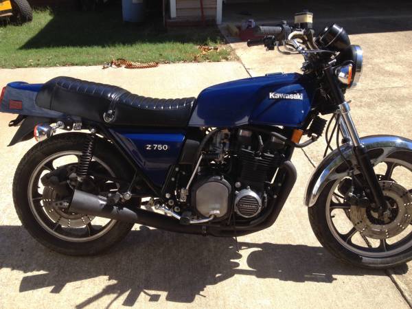

No help probably, but Tony posted a picture a few years back, and said where he got his painted and it looks real close to me.
Here's the picture. Tony died a couple years back. kzrider.com/component/joomgallery/kz-100...-kz1000-a3-mk11-4515
