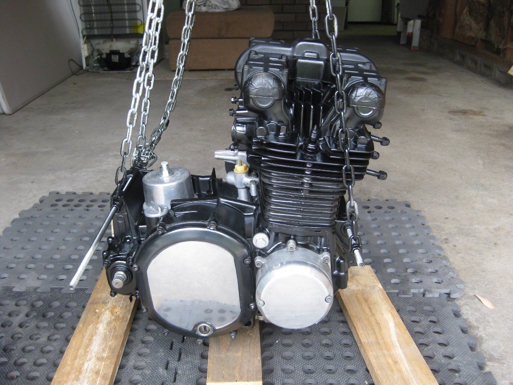

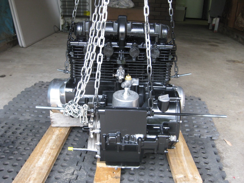

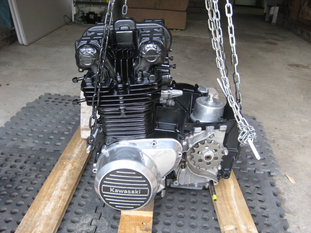

Finally had a chance to do a re repaint of my Z1-R engine over the weekend.
Previous attempt was a pretty inconsistent and crappy mess so had to rub/scrub the affected parts back (again!)
Anyway got a chain block and some threaded rod and made up a lifting and supporting rig for the job.
Hoisted up the engine, washed it and blew off any dust/moisture.
Masked off the parts not to be painted and checked temp - about 20degC and not too humid.
Applied the VHT engine enamel (satin black) per the instructions and was very excited to watch the paint dry -
came out pretty good, a huge improvement on the previous fuckup!

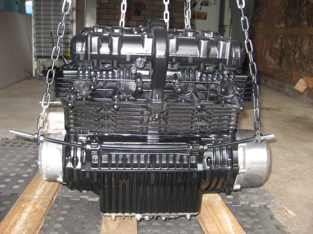

Final pic - from rear -
The photo flash has made the finish look worse than it appears in the flesh in places -
especially the shot from the front.
The sides and back of the motor were the worst areas before but have come up pretty good
this time. Just have to wait for the paint to cure and then will muscle that big fella into the frame,
which I'll cover in bubble wrap to protect against slips and fumbles.
