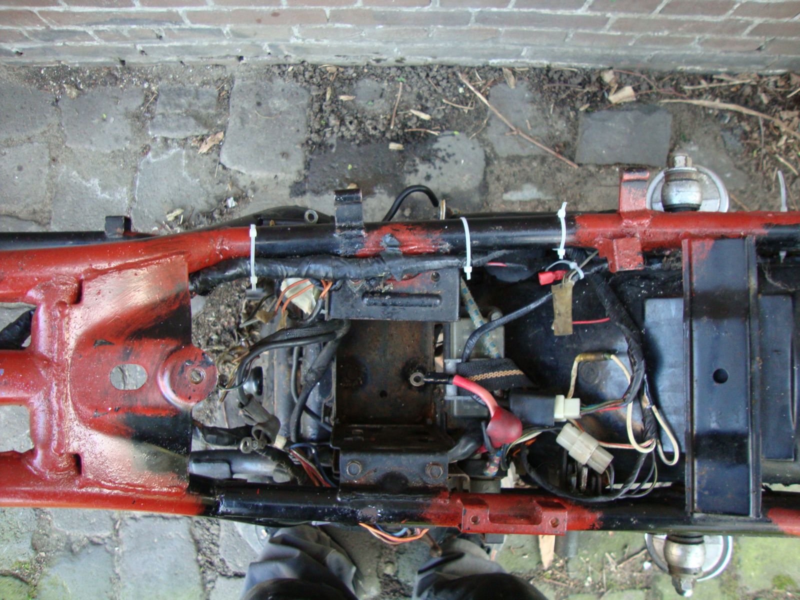

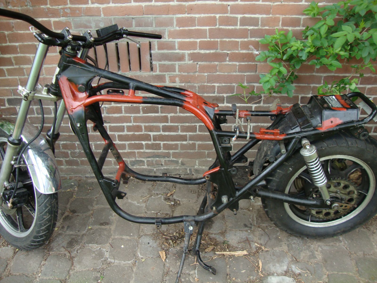

The back of the frame looks pretty close to my CSR,(except the bracket hanging off the back of the loop)
unfortunatley,I whacked off the hinges and shortened the loop on mine ,so I cant take measurements from the frame.Ill have a look at the seat pan today and take a photo for you.

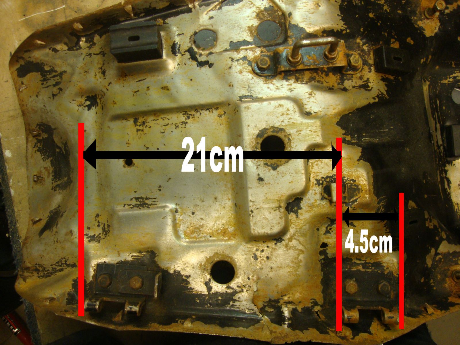

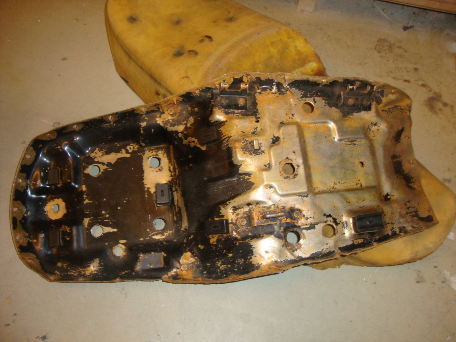

Spannering today,so I pulled out the CSR seat pan and took a couple of pics. You can see the position of the rubbers,the 2 hinges and the hoop for the lock. The hinges and lock hoop are bolted on ,so it would be possible to move them.
Hope this helps.If you need more detailed measurements,let me know.
There must be someone on here with a CSR and an LTD who could do a physical comparison? It would be good to have a difinative guide to the similarities and the differences twixt these two models (then again,there are a load of
different LTD models apparently.Whats the difference between them?!)
Good luck.
