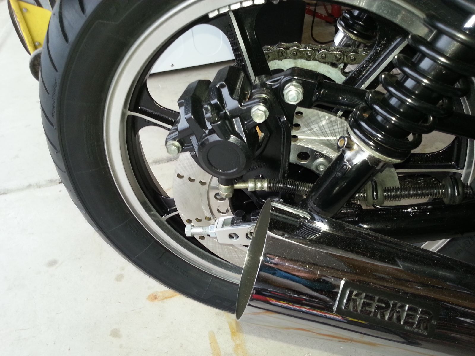

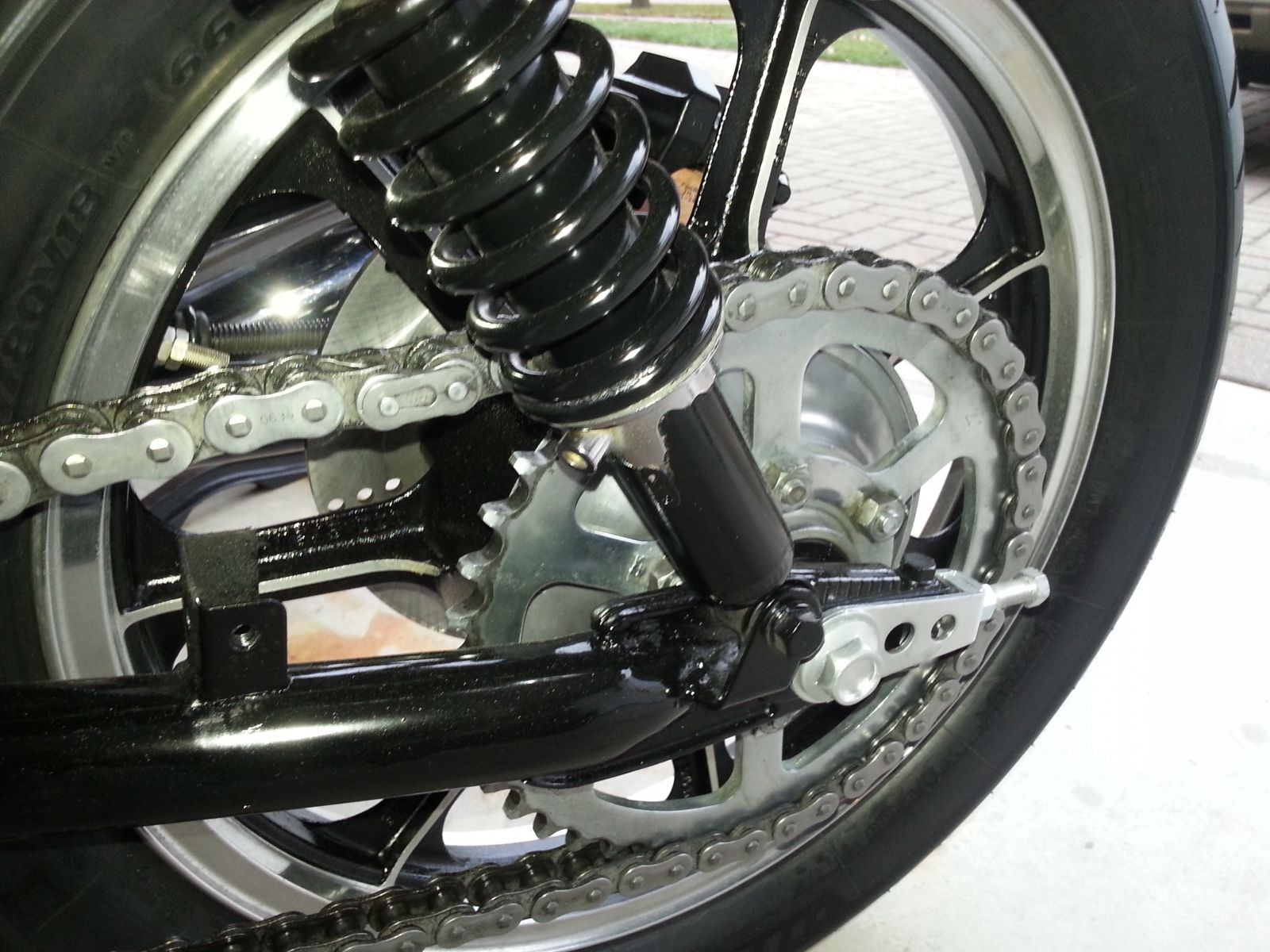

Just freshened mine up first time since 1982. Cleaned the alum. with Flitz and painted with rust-olem gloss black.
