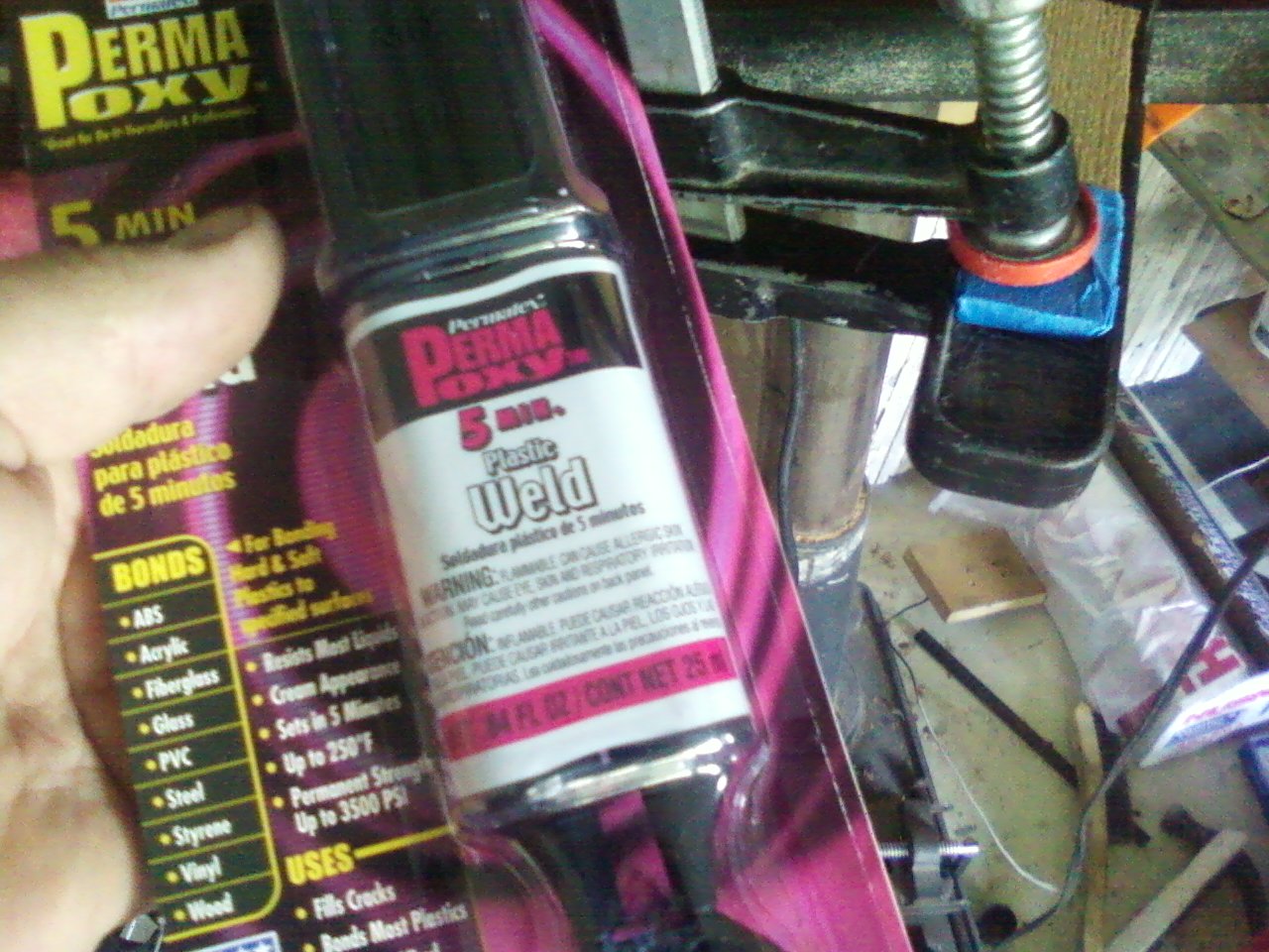

Plastex Rigid Plastic Repair Kits - Click Here
Haven't tried it myself. But did look up some videos on YouTube.
I have tried the LockTite version plastic repair epoxy similair to the PermaOxy. Stuff did not work at all and peals off. I have the PermaOxy but haven't tried that yet. Good luck.
