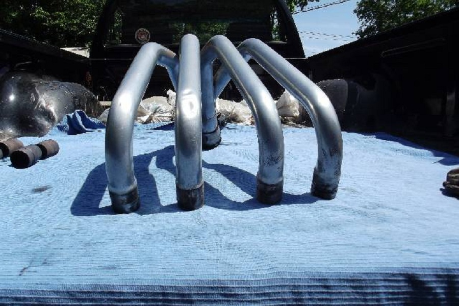

I have done a few now.
It all depends whom does the work. My powder coater is a mans man pro, very experienced and only puts out very best work. He bakes it on in a huge oven.
3000 degrees coating.

That looks really good- as does the rest of the bike that I can see!! :ohmy:

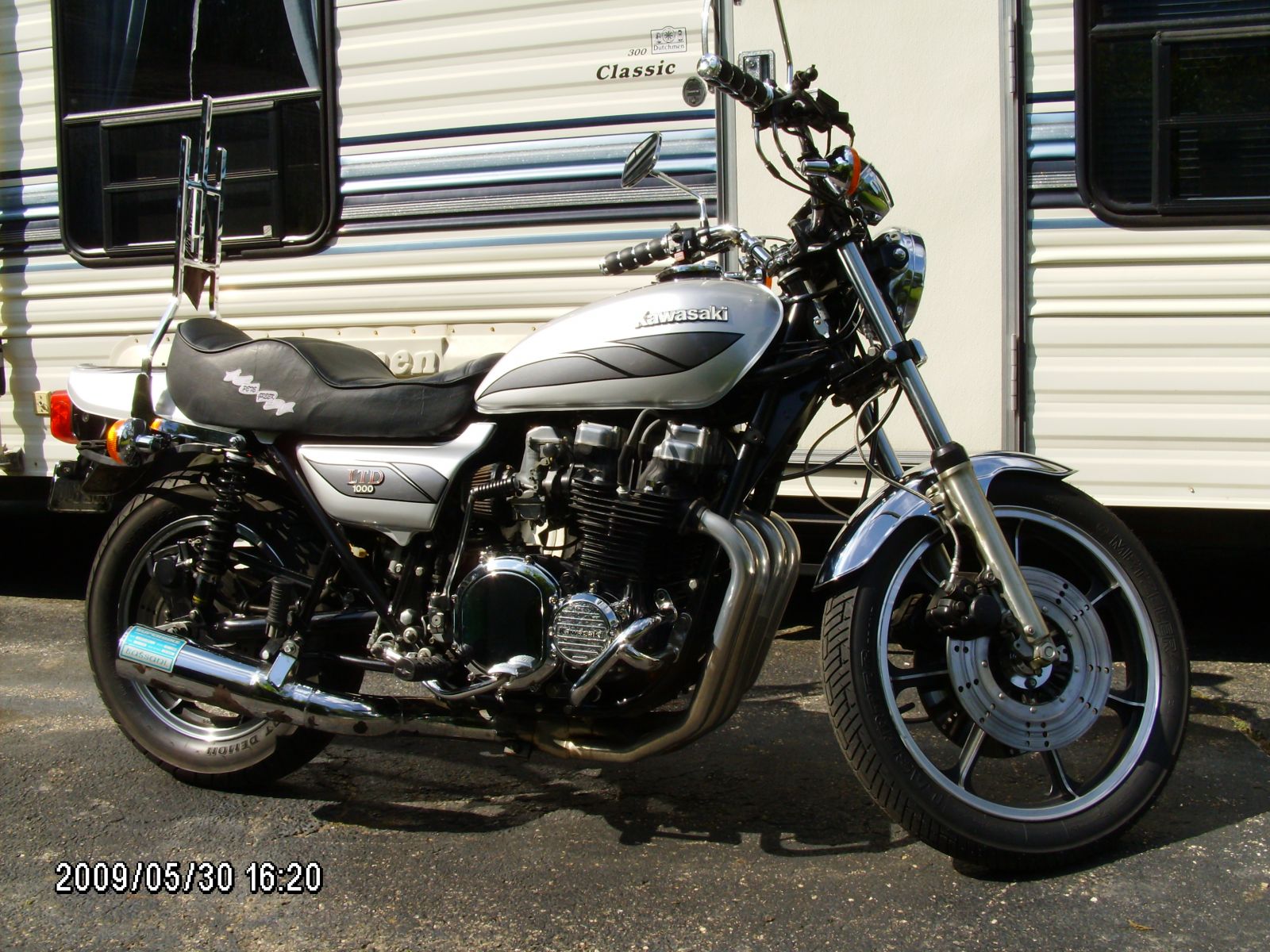

This is my Basanni Headeer pipe that I had it coated in 1988 in silver, & on the bike before I switched it for a Vance & Hines in 2010, because the chrome rear was peeling & flaking, NEVER discolored !! , only a spot on the bottom from oil that had burned on it , because I couldn't see it

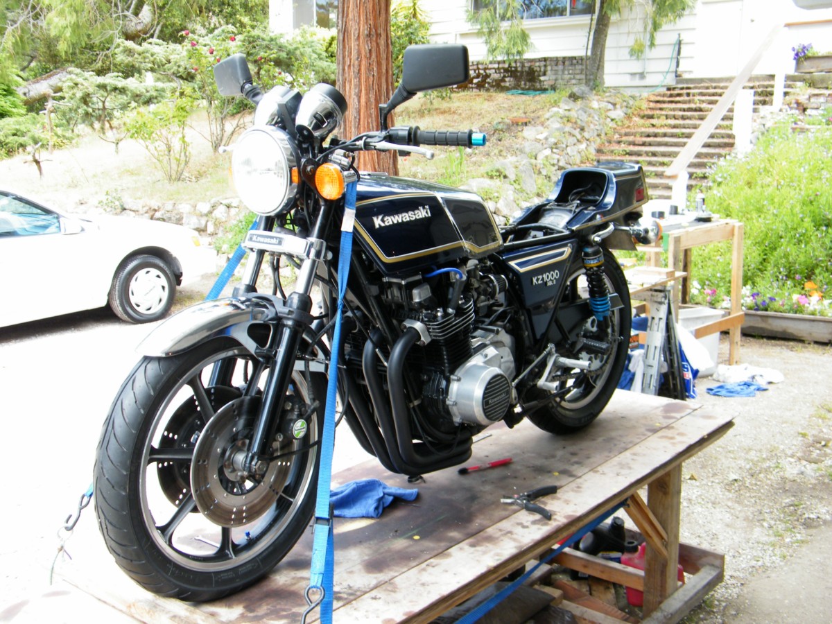

I've had the Kerker exhaust on my 650 since the '80s, and it got really rusty over the years.
Around 2006 I had it sand blasted, and high heat powder coated, black.
The sand blasting did open a few small holes in places.
Cost $200 at the time, and I was in the same boat, buy new or give the old pipe some life.
The pipe is starting to get rusty again, but not as bad as it has been.

hey Pete, what does that Basanni pipe sound like?

4thekz1000, I loved the way the Bassani sounded, I'ld call it more throaty than Kerker, or Vance & Hines, recently bought a stainless upswept from Motogp werks, for the 900, I hear they sound really nice,, cant wait to install it, hopefully before the end of summer
