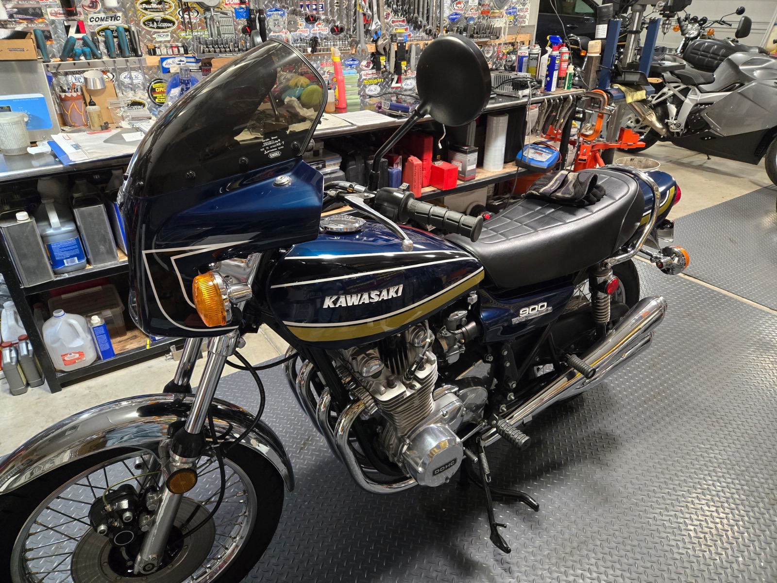

26 Apr 2026 09:05I´ve ever loved the fairing from " Johnny the boy",..( and of course the bikestyle AND the exhaust-system).
(( In the past 45 years i`ve often build up some bikes in that style with these half-fairings,..and nowadays i like the little bikini-fairings like the " EMGO-Viper", as on my Z1000 also pretty much))

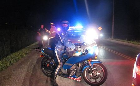

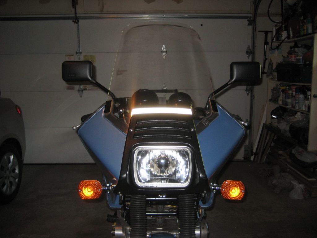

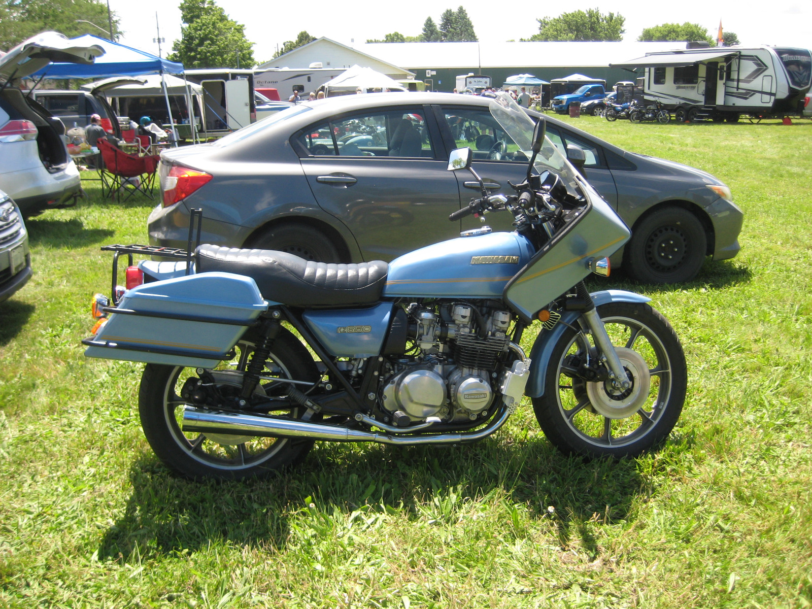

I put a old Vetter Quicksilver faring on my KZ650 I dressed up for touring rides. It has a 1982 Spectre 750 engine in it converted to chain drive.
The fairing was well used when I bought it for $40 but it has since gotten a bunch of upgrades. It did not come with a mounting bracket or turn signals, so I bought a NOS mounting bracket and adapted some repop MK2 turn signals. The headlamp has also been swapped for a LED unit.

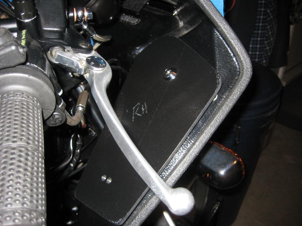

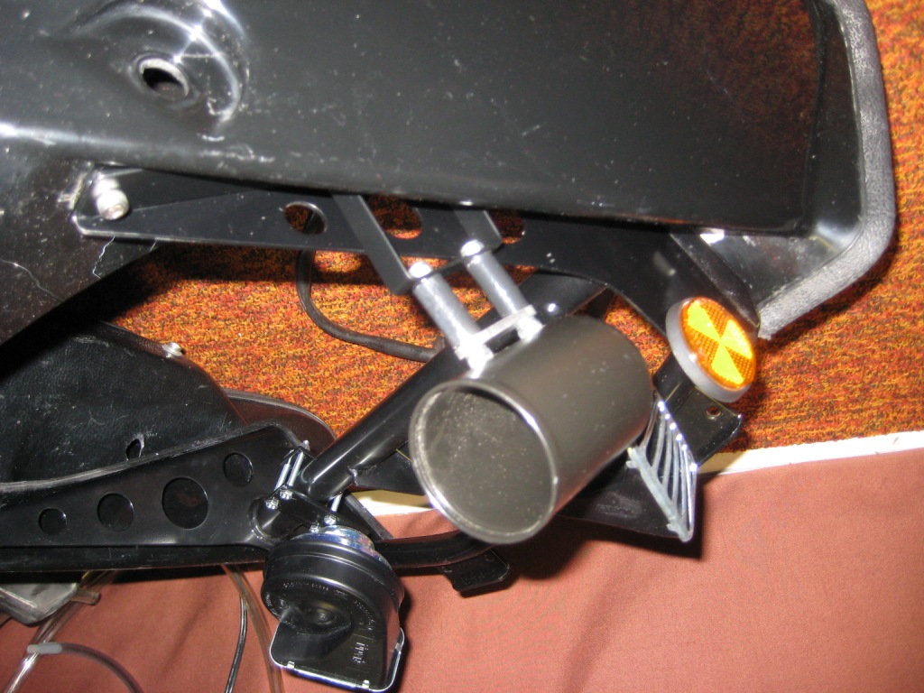

I made some locking hard covers for the storage bins and wired in a 12V power plug for cell phone charging. The covers are 1/4" ABS plastic sheet and the locks are meant for cabinets.

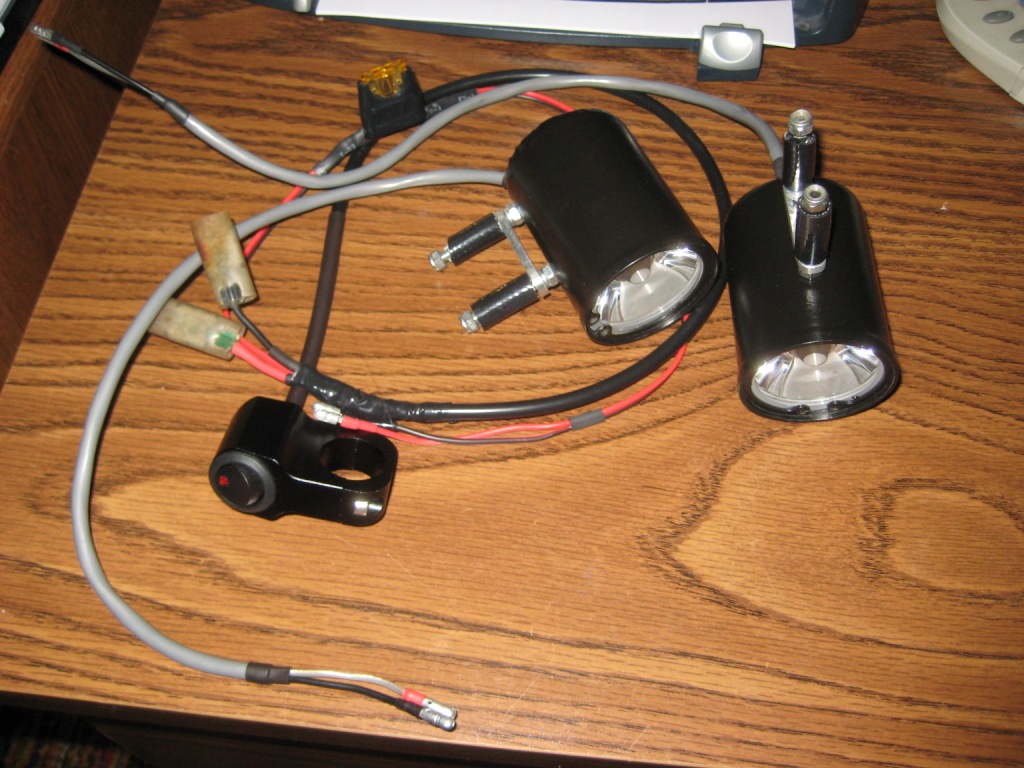

I also mounted dual Fiamm horns and some LED bulb driving lamps under the faring using the stock mounting bracket and some brackets I fabricated. The lamps have custom welded housings that were originally transmission mount shells for a 1969 Dodge Dart.
I like the wind protection that this fairing gives if its raining or on cooler Fall rides. I usually ride this bike with a open face helmet to get the full effect of being behind a wind screen. The Quicksilver seems to be the correct size for a middleweight bike like the 650.

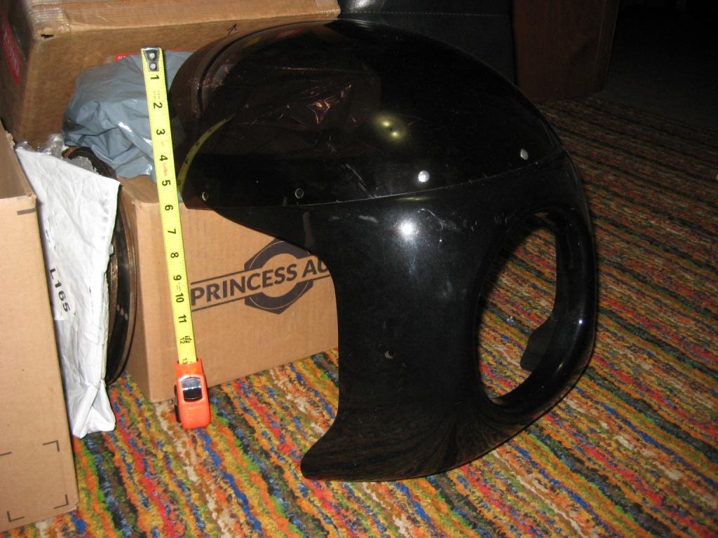

The DFI project bike I have planned is going to use a Emgo Viper 1/4 faring. I bought the faring used for $60 but it was missing the mounting hardware kit and some of the wind screen mounting bolts.
I plan to make custom mount brackets and already have better wind screen mount hardware.

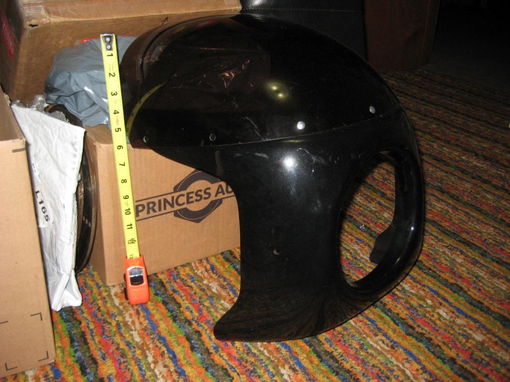

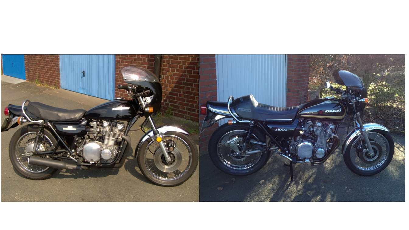

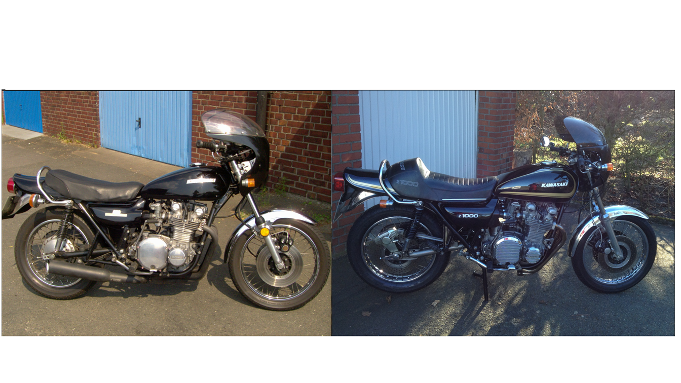

25 years ago I had a fairing from a BMW R90S on my Z1B; ...in the end it looked nearly similar to how the Viper fairing looks on my Z1000 today.

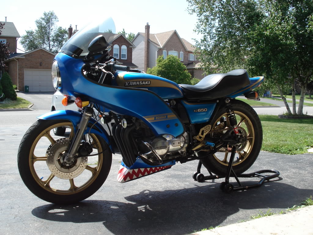

30 Apr 2026 18:41The Rickman fairings are great.Rickman fairings are my absolute favorite (I've got both a 1/2 and a full fairing).
The best thing about them is that Rickman made a fairing bracket set that mounted up to the stock Z1/KZ frame. They pop up on ebay every so often and are worth snapping up. I have two sets myself.
No storage compartments in them, but they sure cut through the wind.
I had one on my 650 for many years, until it got taken off for a repaint, and I decided to not reuse it and put on higher handle bars.
