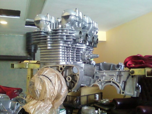

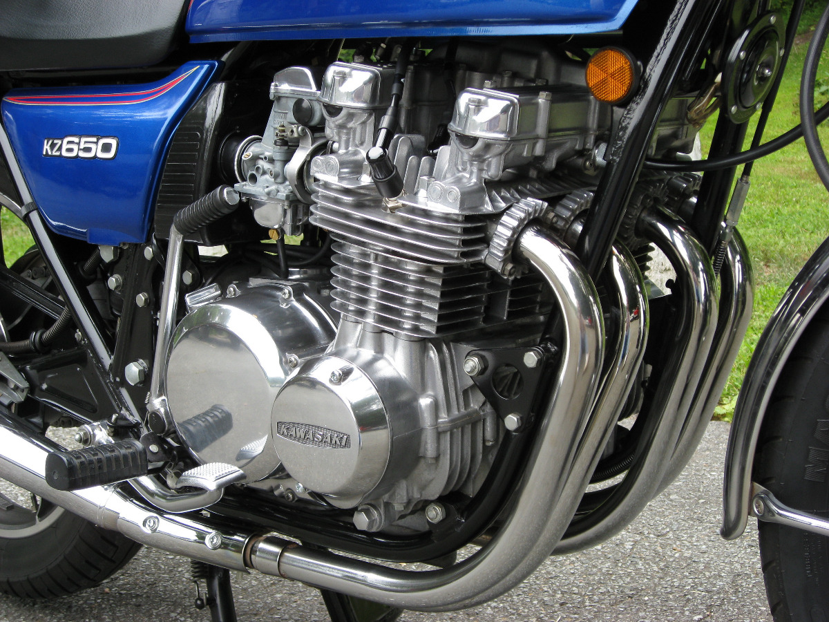

I've owned my bike since it was new. I didn't polish the cases at all for more than 20 years because I thought they had some sort of clear coat. Actually, they did not have any coating at all on them. Over that period they oxidized and looked VERY dull. I polished my cases and cylinders BY HAND. It's not a big deal, but it takes time. I found it therapeutic as I saw them come to shine. Everyone has there own method and there own favorite polish. Here's the result of my hand polishing and the products I used. You be the judge. Ed

Ed there's no denying that your polishing skills are top notch. You were actually the inspiration that led to my trying the whole polishing by hand endeavor.

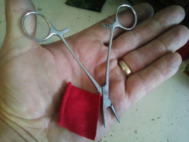

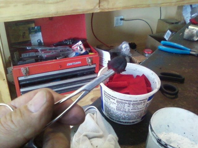

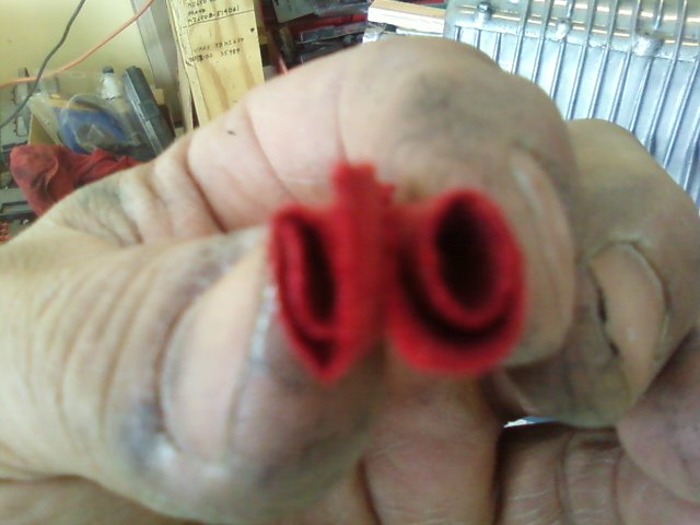

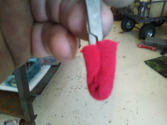

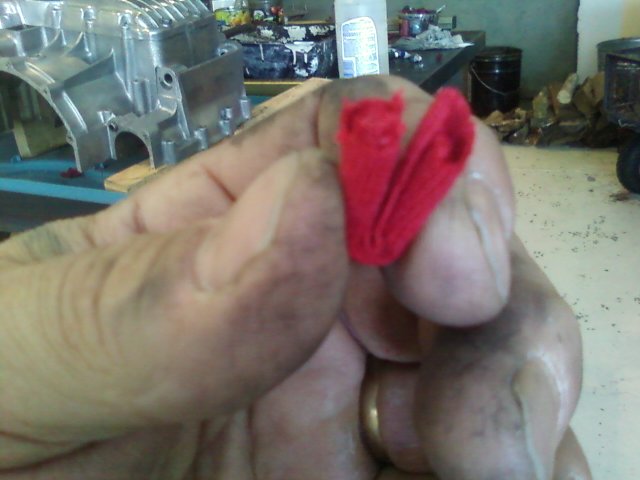

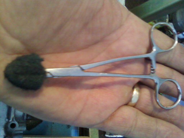

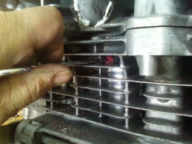

I used a small hemostat with cut up squares of Scotchbrite and cotton tee shirt for the stripping, scrubbing ,cleaning and polishing this last time and was very happy with the way it worked for me.
