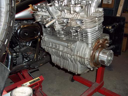

I believe "4"'s lower case engine is still in the frame with his top end off.
"4", I would put any cylinder back on in place. Use a pressure washer, some simple green and a parts brush.
Spray and wash, the blown off with air. Dry with a propane torch or a hot paint strip gun, to get the moisture out of the pores. If you've never done this you would be amazed at the moisture.
"4" should know this, He is familiar with powder coating aluminum.
Then spray away. I have a rebuilt engine that has been on an engine stand for 14 years, full of shop residue, paint dust and oils. I am going to blast this off when it ever warms up and stops raining in western new york.

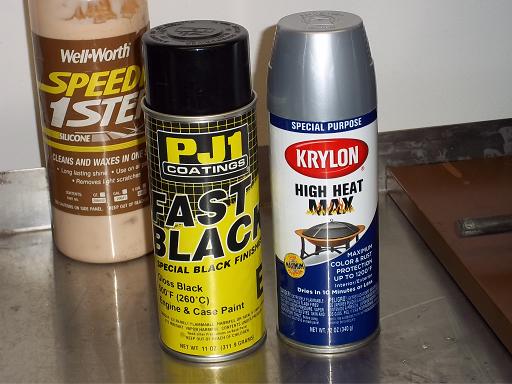

I have GLOSS black! PJ1. Always loved gloss. I used to use just black lacquer 35 years ago.
Then I just seen this Krylon paint, ( it's new! ) Hi temp special 1200 degree. I bought it just to try it on my grill,
this is aluminum. I'll see if it rubs or smears, I'll test a gas rub. Krylon is the best rattle can for others.
And to anyone who paints an engine black! Take the time to sand the fin edges down, like the 73 Z1 engine.
I see so many clyinders and blocks just all black? Mill, scotch wheel, file or block sand before you paint!

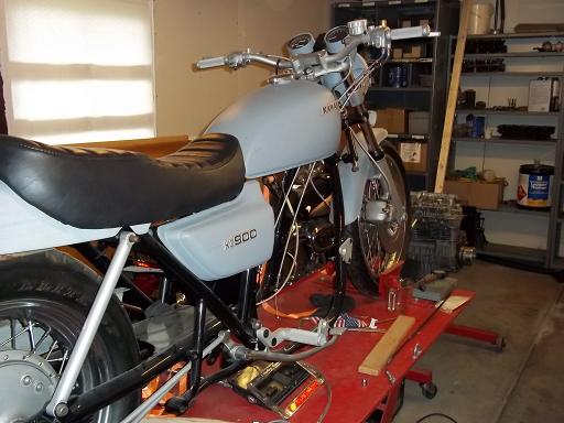

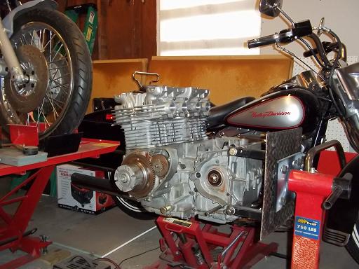

Here are some pics, The Z-rod is sitting in it's new home. In it's small suburbian garage. WTF?
And which one is sleeping with the enemy? :laugh: :laugh: can't we all get along?
