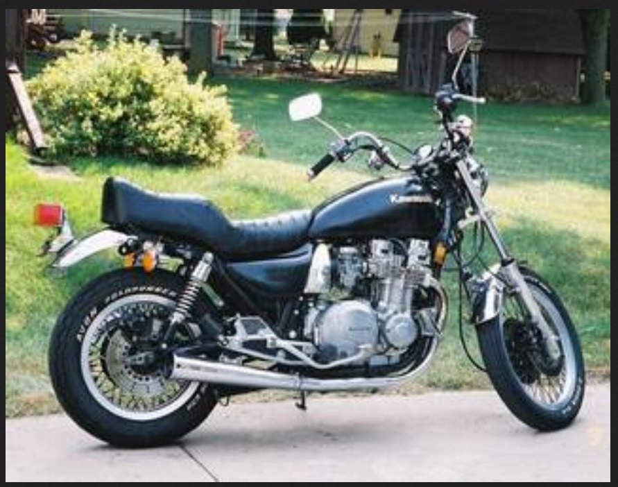

Mine is a stock 81 LTD 1000 K model and it does not have the tail.

13 Mar 2014 19:37 - 17 Mar 2014 17:53Attachment SAM_0639.jpg not found
Look at my avatar picture, it is a 1981 KZ1000 LTD, has pods, missing stock air filter.

Brian told me my bike is a csr.I dont know the difference.Being an 81 it has the j motor.

Am thinking CSR was basically the same as LTD, but with spoke wheels and cable driven tach.
