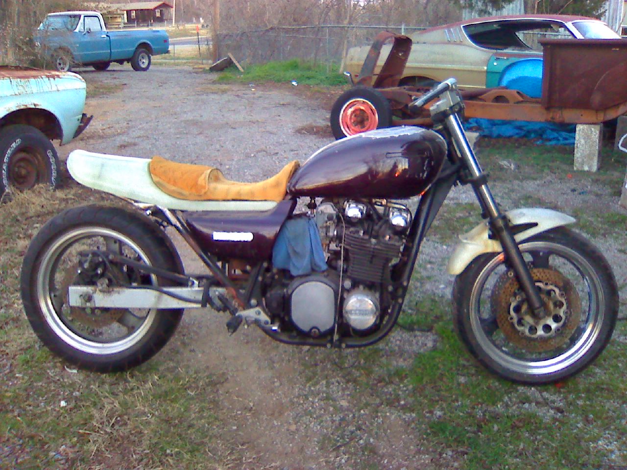

I was wondering if the 77 style, smaller, flatter seat or something like that style is compatible with the frame of the LTD, as I want to use the 79 style rear fender and seat on my LTD for my build. I know the fender isn't a drop in piece as there are no bungs to bolt it in, and I can put those in, but do any other Kawasaki seats out there fit the hinges on the 82 frame?
I think the king and queen style seat on the LTD''s is fugly and I want something sleeker for my cafe build. Any suggestions, other than making a completely custom seat pan, foam and cover?
