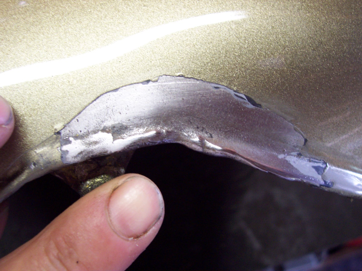

Here is crack area

If you can find a welding shop who can Braze or silver solder the leaking area & then repaint the tank, you should be good.

Since the tank is already cleaned out have it TIG welded.....just regulate one PSI of airflow into it to prevent a big bang. TIG at the leak pinhole spot will not generate much heat and will not do any more paint damage. POR 15 is the best ..... but as a last resort when you cannot weld an area.

Have it welded and any compitant painter can blend it. And it's hidden by the seat so double bonus.

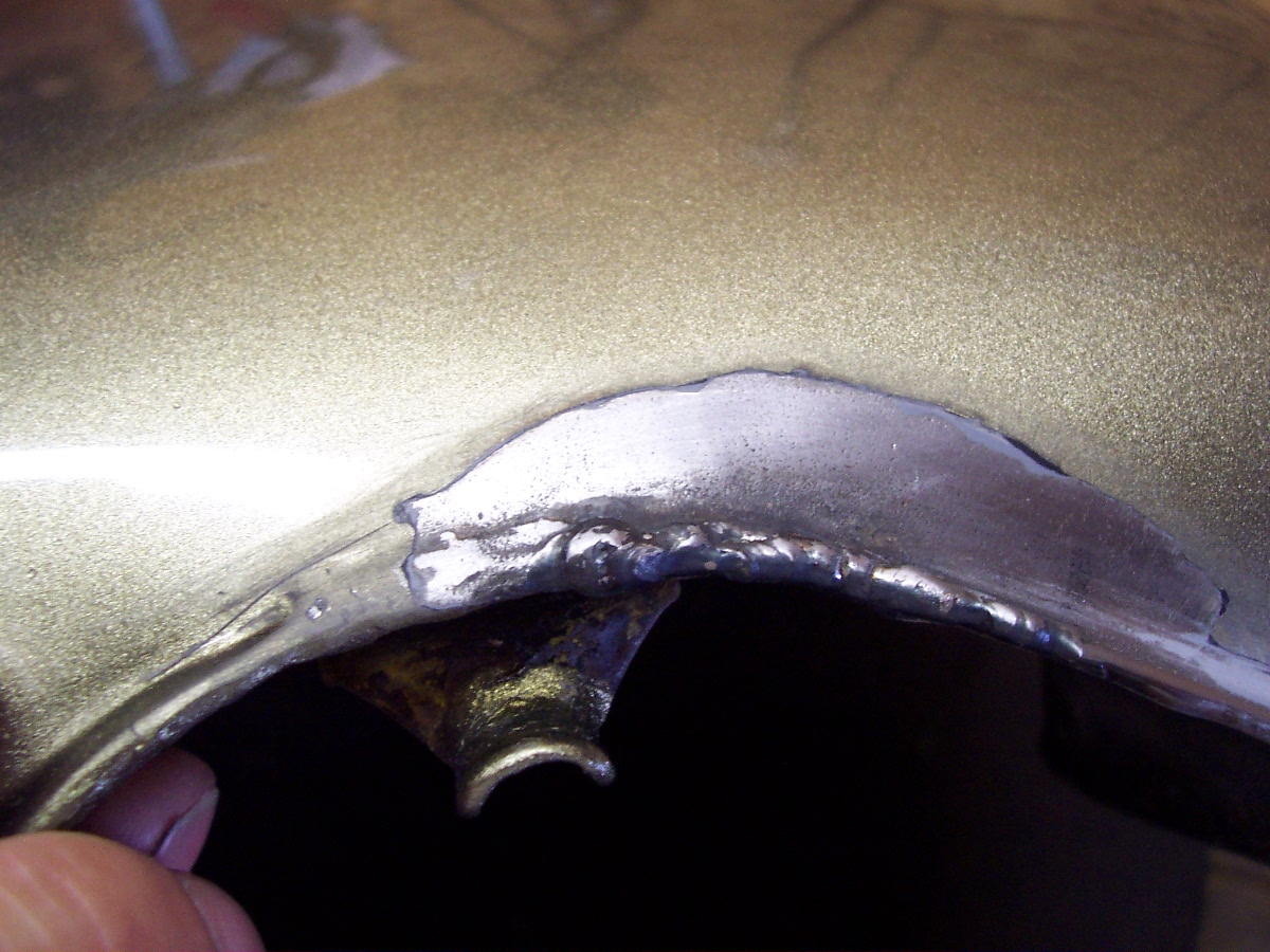

09 Jul 2013 16:24PaintWorkz wrote: Since the tank is already cleaned out have it TIG welded.....just regulate one PSI of airflow into it to prevent a big bang. TIG at the leak pinhole spot will not generate much heat and will not do any more paint damage. POR 15 is the best ..... but as a last resort when you cannot weld an area.
Ralph
Thanks for the tip. Local machine/fab shop tig welded it and low pressure check for $20. They also had a gel applied around the painted area to prevent heat blisters. $20 no more leak and the front of the seat hides the paint loss area which I will have touched up
I'm stoked
cheerz
gregz
here is fixed crack tig welded
